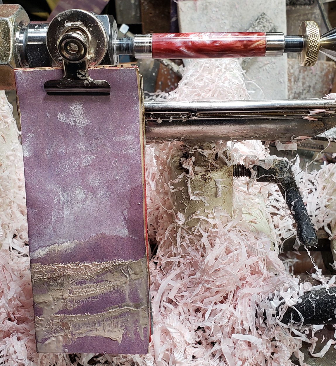

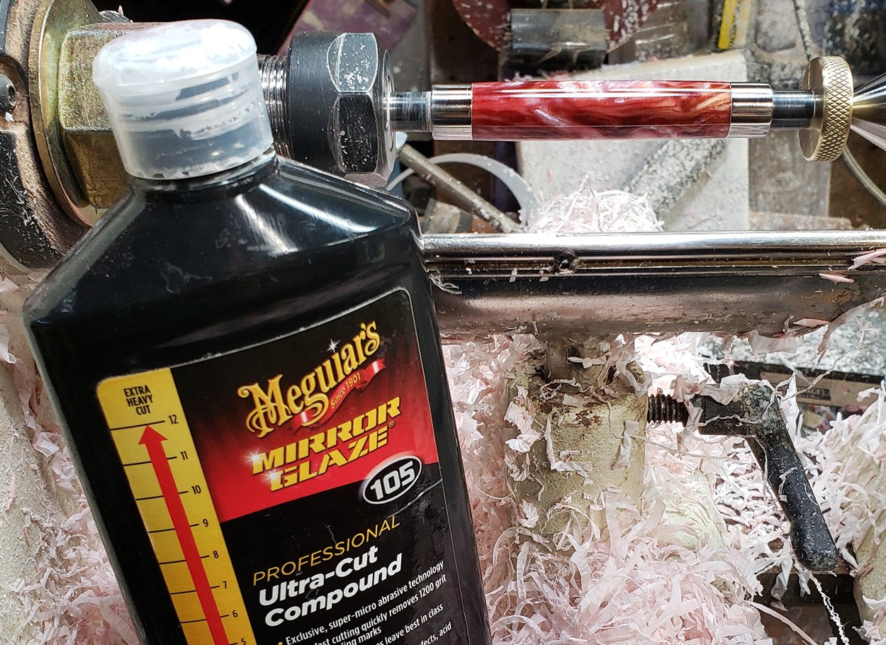

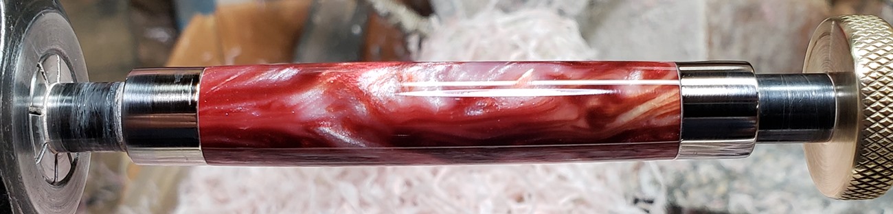

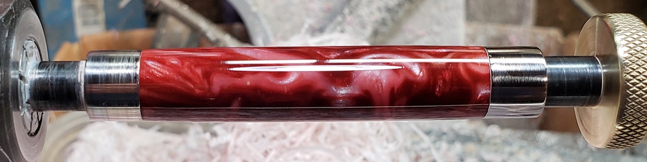

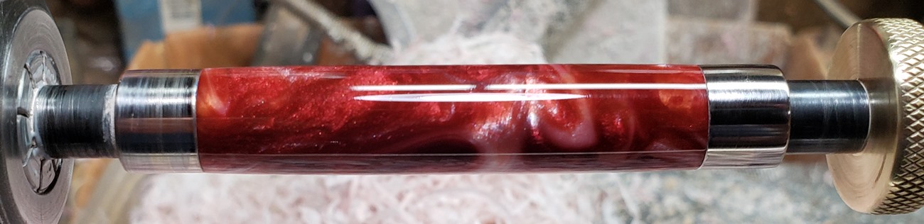

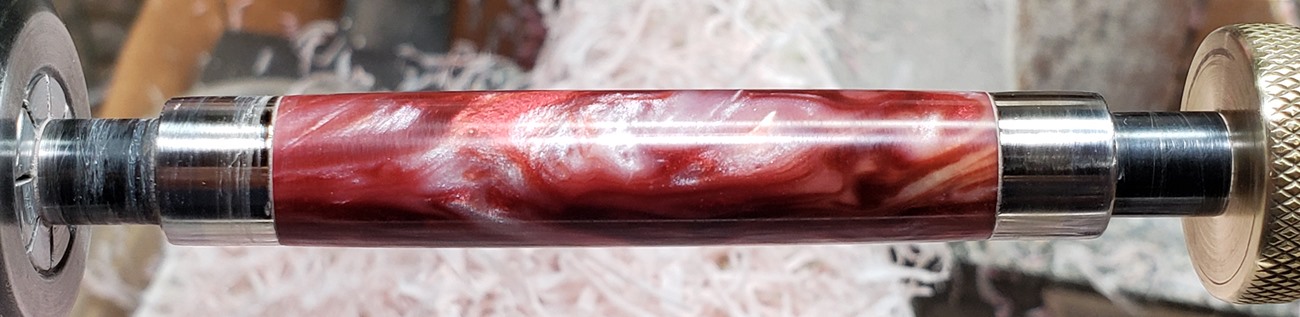

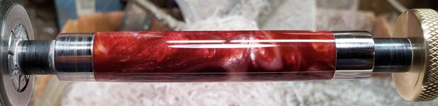

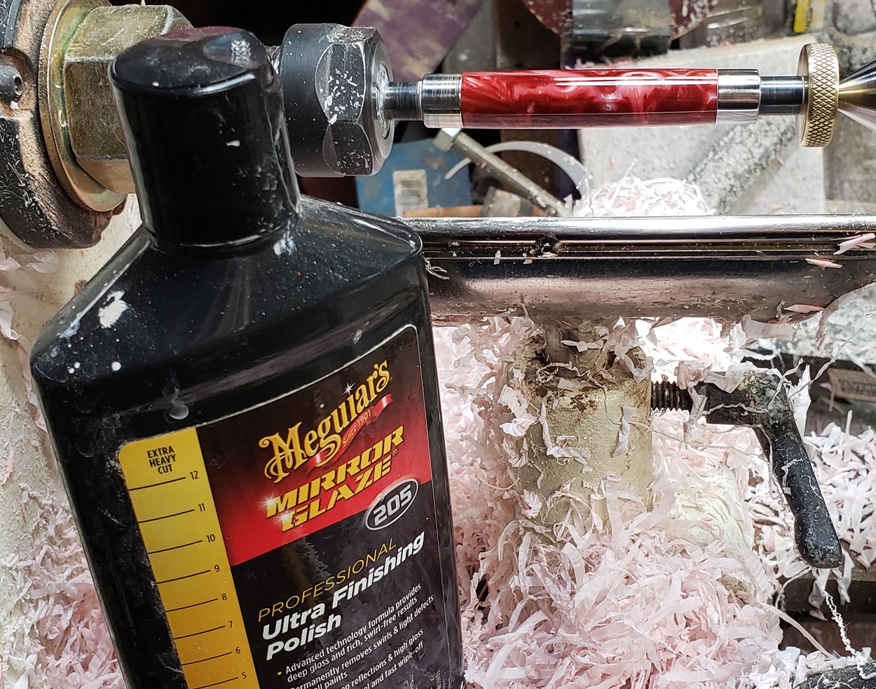

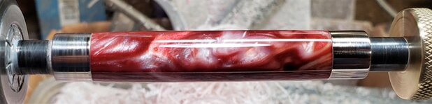

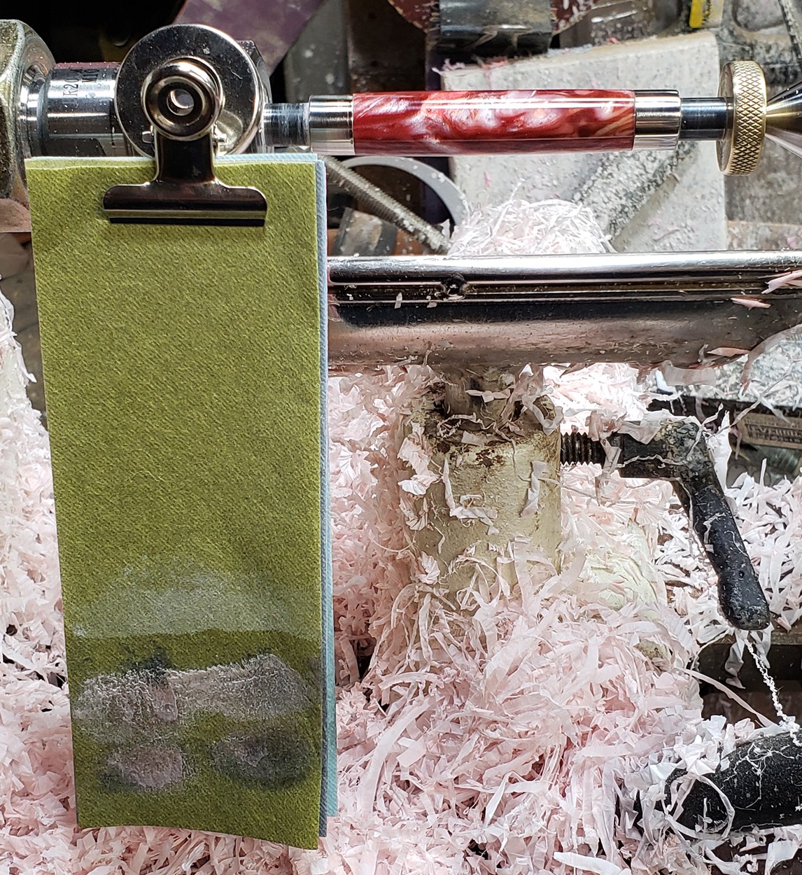

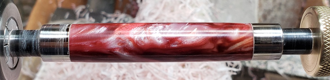

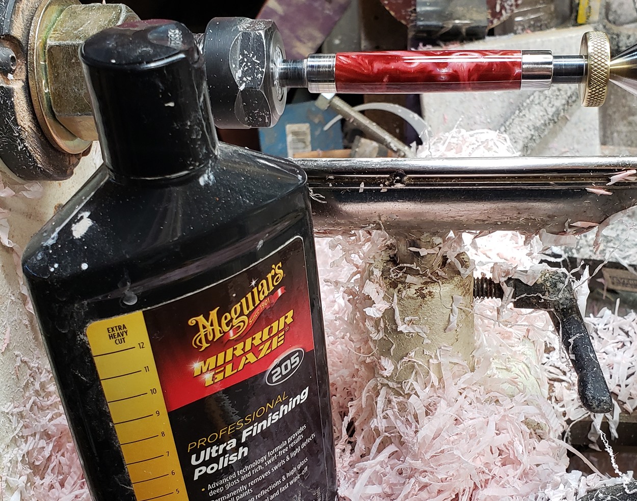

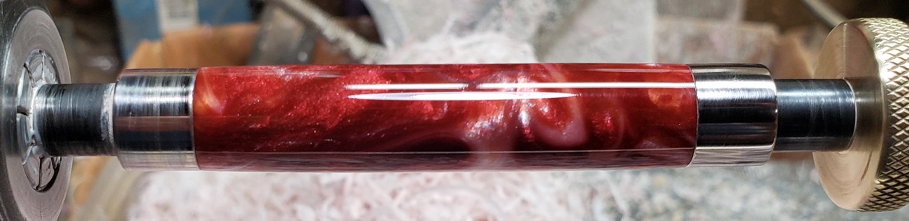

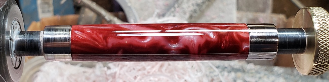

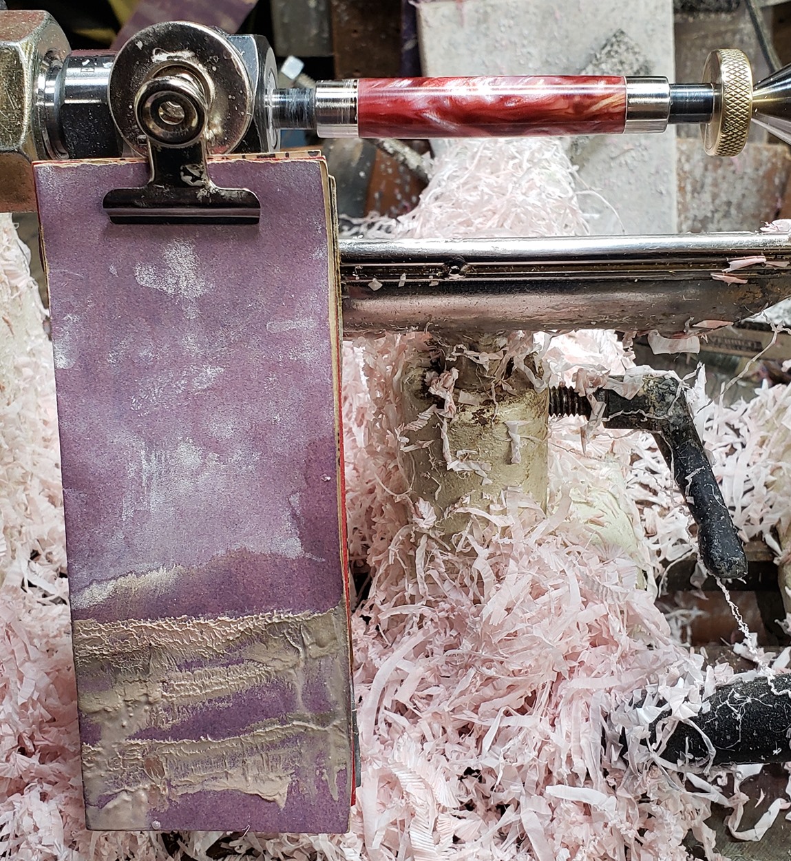

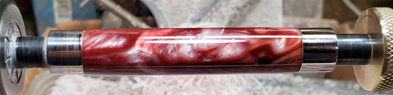

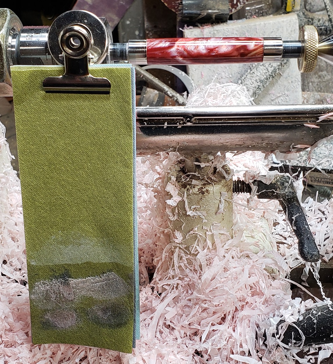

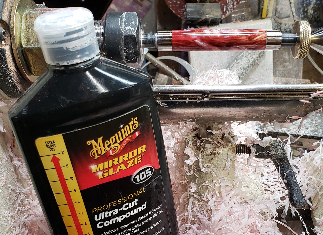

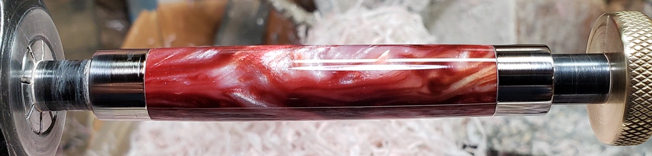

Welcome back! The online suppliers I use most are Pennstate Industries, Exotic Blanks, Turners Warehouse, and recently Crooked Mill. As for acrylic polishing, I developed a regimen earlier this year that has been working very well for me. (Thanks to TonyL for his advice.) I wet sand to 600 grit; then use either Micro Mesh or 3M Zona polishing paper wet; then Meguiar's 105 and 205, and sometimes follow with Meguiar's #9. It's a lot of steps, but the results are worth the effort to me.
