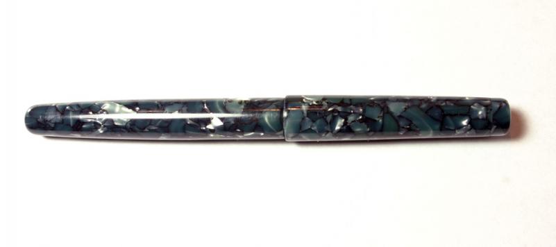

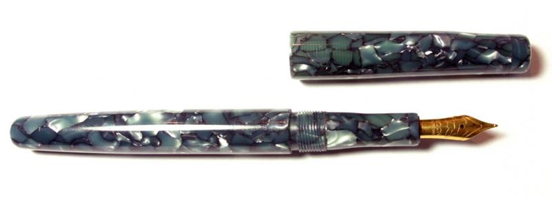

I was pretty happy with how my pen was looking till I went to make a cap. I think I've done about everything wrong possible. When I measured how long my cap would need to be I knew it seemed kinda long and after making it the cap looks goofy. I had numerous problems with it as well. Seems like you gotta plan everything you need to do to a piece because every time I re-chuck something in the collect chuck it doesn't seem to spin as good as the last time I had it in there. I'm frustrated with this pen and ready to just throw all my taps, dies and bits in the trash. So everyone encouraging others to make a kitless pen is feeling like "misery loves company".

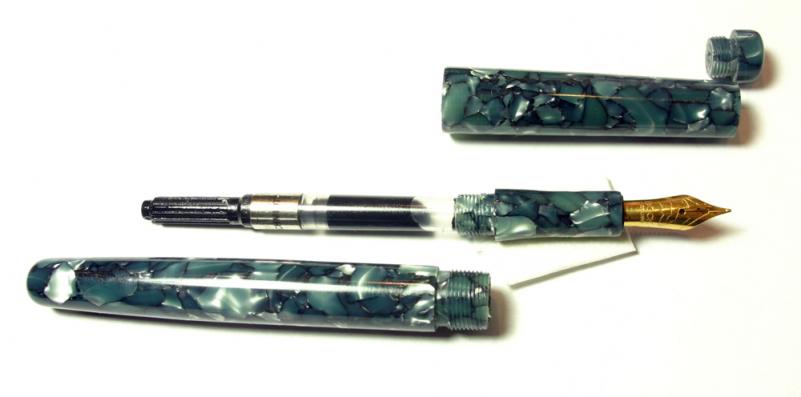

- The section seems about the right size to hold the housing and converter so to make it shorter I'd need to increase the length of the threaded section.
- This is my second housing/converter assembly where the ink does not want to draw a vacuum with only the feed hole covered....I have to dunk it almost all the way to the end of the nib. In the photo you can see how the ink is moving around and not holding vacuum.
- I don't like how my threads look where I flatten them so the cap will completely screw shut. I spent forever taking more and more material off before the cap would go on all the way.
- The cap is crooked because after turning it around in the chuck I could not get it centered.
- The finial threads are too large for the clip I had...forgot to check the size of the stupid clip first...the threads are 9mm and the clip is 8.2mm.
- I didn't bother trying to get a good finish on it cause I hate it so much.
Frustrated and ready to go back to just making Slimlines and Wall Street II's where I was fat dumb and happy...lol.
Gil

Wow! A lot of grief and pain went into that pen. Looks pretty darn good to me. It would be a shame not to make a second pen to apply all of the things you learned.:smile:
Let me know when your trash day is, I'll fly out to AZ to pick through your garbage with a strong magnet.:biggrin::biggrin:
Well, I hope you feel a little better about it tomorrow. I think it's a great attempt. Beautiful in many ways!

After you get through beating yourself up...... THe pen looks ok. THe cap looks longer than the norm but not bad. I like longer pens. You have just found out that the details matter! Move this and it effects that. But just because it doesn't have the ratio's your used to seeing on kit pens means it wrong. Next time shorten your front section to 3/4 20mm ish, lengthen you lower body to 2.5 inches plus the finial drill the finial so the convertor will fit or a roller ball. make the cap 2 inches long plus the finial. Add a clip, or not. But quit whinning. We ALL make "oops that didnt work like I planned" or the dreaded "looked better in my head" pens.

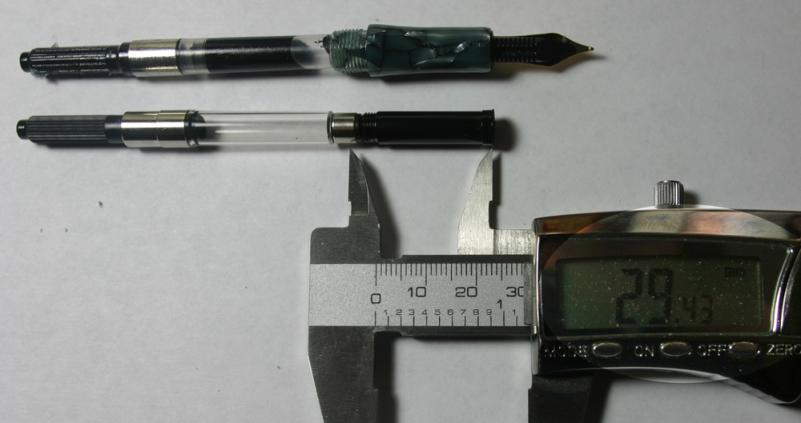

Yeah I saw that pen. I don't see how he can make his section so short unless the feed housing he used is much shorter than mine. Checkout this photo I just took of my housing with converter outside the pen. I tried to place the calipers about where it looks like his section ends in relation to the converter. His section looks a lot shorter than 29mm.

If you hadnt told us i doubt we would have known about the crack. The small Bock feed housing is 26.79mm the threads for the feed housing should be at the back inside the threads for the front section you made. You can move the whole assembly farther back until you get a length you like. You may have a longer thread area on the front section that fits inside the pen. Shorten up the amount of threads on the body for the cap by about 1/2. My thread area for the cap are .150 to .200 long.

If Ken made his pen using a feed assembly from Meisternib the front section housing can be made much shorter. I have made them down to 16mm long.

I think your section length is fine, but you can shorten the cap threaded area on the body, which will enable you to shorten the cap. Also, I plan my caps so that the nib tip is about where the cap/finial transition is, which will enable you to shorten the cap even more.
CLicked post too soon.
you can drill into teh cap finail's threaded tenon to make room for the tip to go up in.
For the clip, if you recess it (see George's recent thread) then you can clip the ring and widen (or even shrink) the ring to fit. Doing this the ring size doesn't matter
