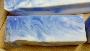

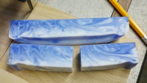

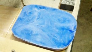

So I bought some Castin Craft and 1 bottle of blue dye and one bottle of white pigment. I gathered a tupperware container, dixie cups, stir sticks, and paper towls and set myself up outside. 24 hours later I have the blanks you see below.
It was a lot of fun. I think that I poured both colors too soon though because the white is not as brilliant or bright as I would have liked. It is almost as if something is missing. Any suggestions woudl be greatly appreciated.
I also had issues when I poured I put the white in first and then the blue. I then swirled it. It seemed like I could not get the blue to the bottom of the tray. Next time I will pour them together.
If there is any suggestions that you guys can tell me from the photos I am all ears. Thanks.
I am also going to order a respirator. It is pretty strong and I read the safety sheet on it and it can do bad things to you.
It was a lot of fun though and I hope to try it out again.

Here are the blanks before turning:
