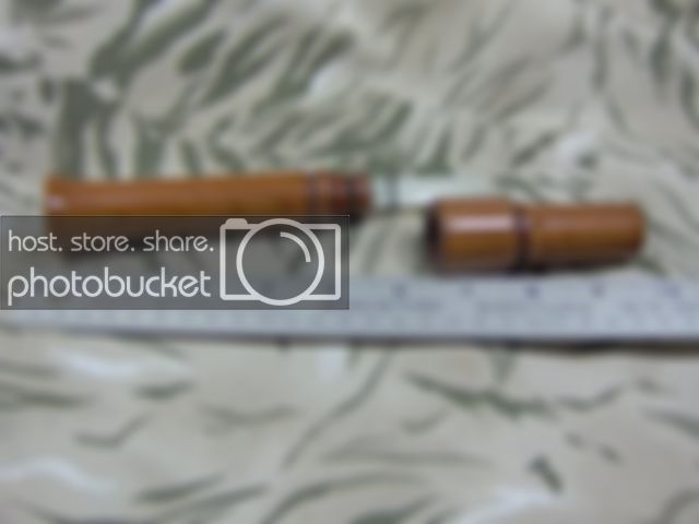

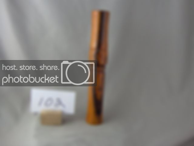

This is the way I make most of my deer grunt calls. 2 pieces, the mouth piece is 3 1/2" long with a 3/4" bore and the exhaust is step drilled using a 5/8" for 4" and a 1/2" bit for the reed holder end for 1 1/2", this makes the exhaust end 5 1/2" long. On the end of the exhaust end is a 3/4" tenon that fits in the mouth piece.
Marvin
This is a different call but it shows the tenon and O ring along with the reed installed in the exhaust end.

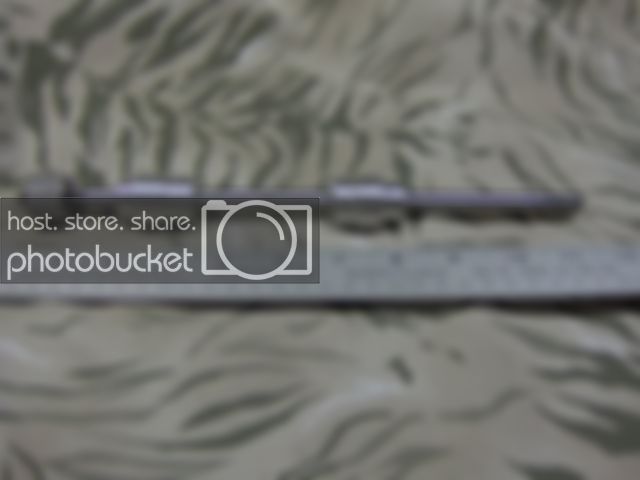

This is one of my mandrels that I make for game calls. This one is set up for the 3/4" bore on the mouth piece, I have another that is like it except it has a 1/2" bushing and 5/8" bushings for the exhaust end.
dogcatcher
Jul 4, 2007
2,361
TX, NM or on the road
The rubber expanding bushings will on occasion let you get the body out of round. These never get out of round. After turning and sanding the call body I use a steel expandable arbor in my collet and do the ends of the call body. You can even use these bushings to turn between centers like doing a pen. I also use pin lock mandrels for making calls, but I charge a bit more for making the pin lock mandrels and most people only use them a few times a year and there is no reason to spend all of the extra money.
