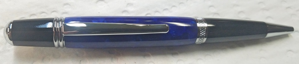

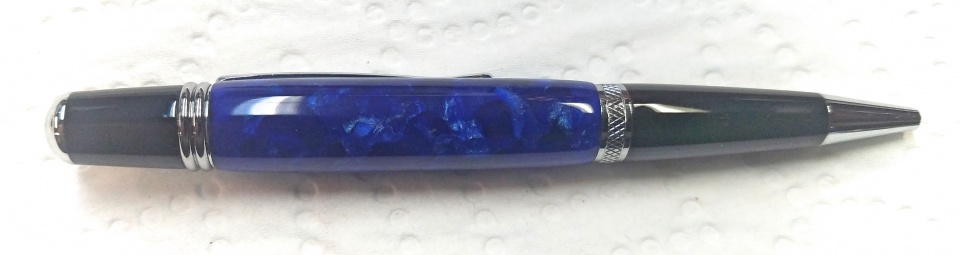

Many of you know that I had a thread about not having a successful pen. After 7 or 8 assembly mistakes, cracks while pressing the pens together, blanks not turned or sanded enough to match up with the nibs and or caps etc. I now have a successful pen to post. It is a Wall Street II chrome finish dressed with a Deep Blue Sea acrylic pen blank.

Very nice ... I like the color saturation in the barrel, and that the brass doesn't discolor it with a green tint ... :)
Did you backpaint the barrel or paint the tube?
Fit and finish look great ... looks like you worked out your problems nicely!
A Very Attractive Pen, Bob.
Love the Blank, Glorious
Excellent Finish, the Fit could be Improved by taking the Nib End Diameter down to the Bushing, it is still a little proud of the Mating Section.
I appreciate that it can be Traumatic when turning down to a small Diameter.
So till you get Confident, why not take it down by Sanding?
Providing you use a Fine Grade and keep the Abrasive moving, You will not do any Damage, but it will take a little more time.
Congratulations,
Brian.
I started out with a back painted tube. Learned my lesson with a pink acrylic blank on a seam ripper that I made for my wife. The brass tube showing through looks bad.
