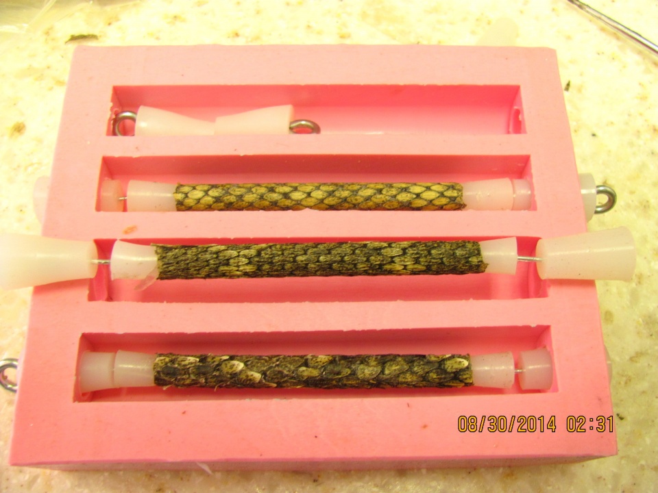

I don't have a mold for that tube!!!
its_virgil
Jan 1, 2004
8,503
Wichita Falls, TX, USA.
I was asked to make blanks and there are no molds for them. I was asked to make blanks for the 7mm letter opener. The tube is much longer than the 7mm slimline. Here is a picture of my solution. I used the mold for the long clicker and a little ingenuity and creativity. I'll post pictures of the blanks when they come out of the toaster oven.

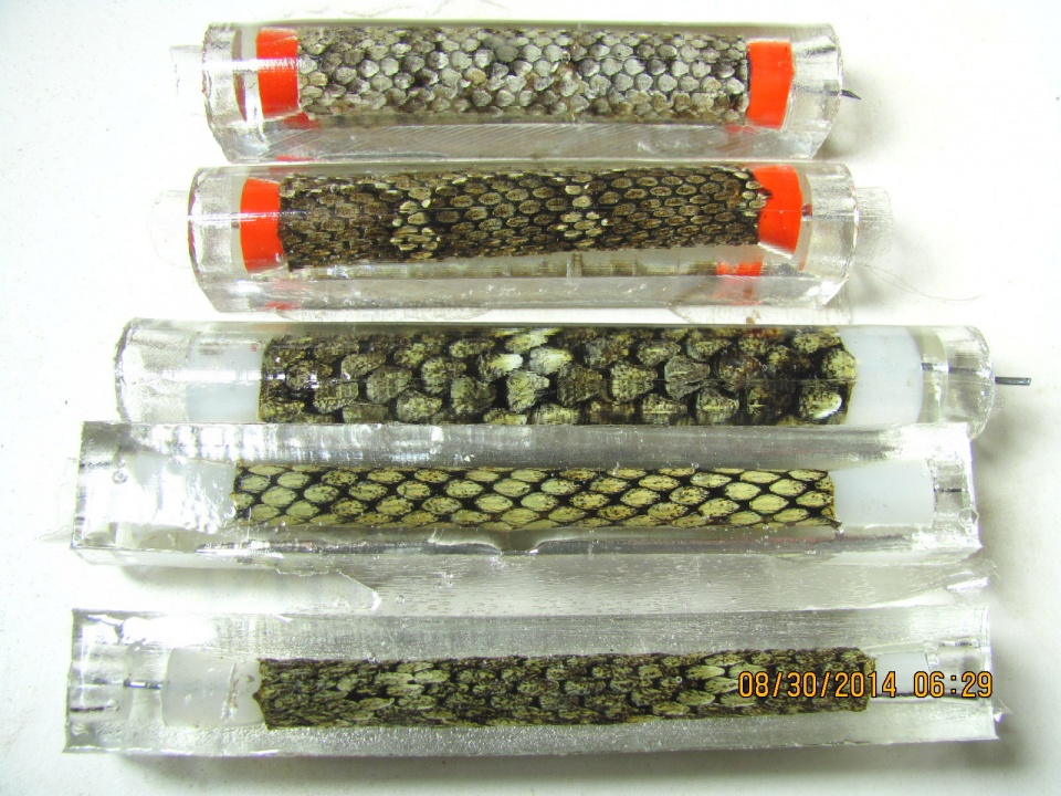

Nice idea I think Fred is working on one for the razors with a 7mm tube that might fit the bill in the future too
I just received his first mold for razors this week and am happy to report it works great. It holds two 3 inch 7mm tubes. I did two batches (4 blanks) yesterday and they turned out great. Got called in to work today so I didn't get to post pictures yet. I'll have them up tomorrow.
Sounds like those would be just about right for the 7mm letter opener blanks I just made.
