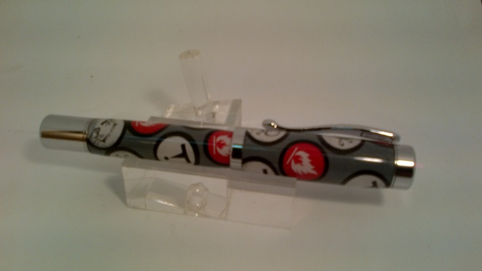

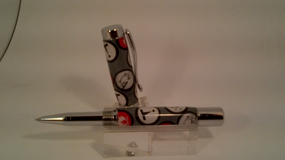

This was my first go with polyester resin in my new pressure pot. A lot of flaws but a fantastic learning experience. It's an atrax cast with dangerous goods stickers that we use at work. The resin or possibly the water from sanding creeped in the ends and crackled the paint and the resin leeched under some of the stickers so I know to seal it with some kind of clear coat before casting next time. Although it kinda adds to the look of the chemical logos. This was all an experiment so i really don't have anyone to impress with this. On a high note there is not even the faintest hint of a bubble anywhere so the pressure pot was a huge success.
Sorry for the poor quality pictures but I can't seem to find my camera at the moment. If I find it I may repost.
That being said. I do believe I am hooked on casting.
