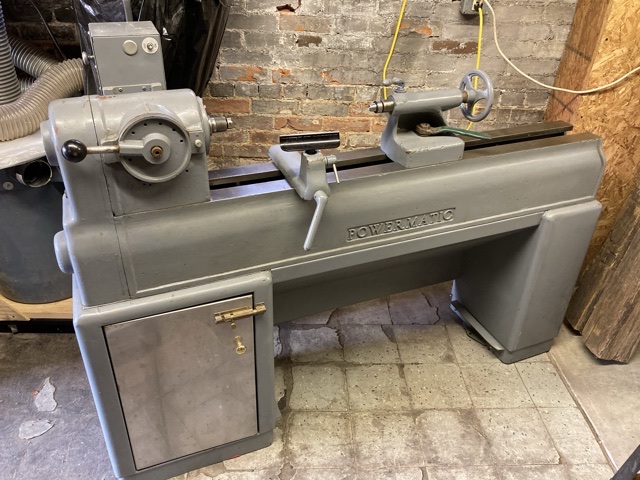

Came across this down below Lexington. Had not planned on up grading from my full size lathe from Harbor Freight, it was doing all I needed. But, sometimes the deal is right. So I now own one of the many Powermatic 90's, 2 HP 500-4000 RPM through the reeves drive, VFD coming Tuesday. This should meet my needs for quite some time with a great range of speed and torque selection through the combined drives.

The seller said to bring 5 or 6 people to move it and obviously that made little sense. My older brother and I got it taken apart and loaded in less than 30 minutes. My oldest daughter, wife and 2 granddaughters (and 4 year old grandson) all helped at different times getting it unloaded and set back up. Again, no more than 30 minutes.
The seller said he was surprised when just the 2 of us showed up as it took 3 guys and a Bobcat to load it and 3 guys with tractor to unload it. We had a low deck trailer, 6' lifting strap, a 2 ton cherry picker and a hand full of tools to take the 500 pounds of lathe off the welded 10 gauge 70 pound cabinet.
He said he guessed having a plan and the right equipment really does make a difference. LOL

Thanks, all. Began cleaning things up, adding rust preventives and such today. It seems to be in good shape thus far. Tail stock has 4-3/8 inches travel and hand wheel spins freely to extend or retract. Though it weighs a bit, I can give the tail piece a one handed slap and send it sliding down the ways.

I am still going through it now. When I was communicating with the seller he gave me some odd answers about the piece. When I went to see it he indicated he had used it maybe 4 or 5 times. He was a liar who was compelled to answer questions he had no clue about. But, the machine was in good shape. If he ran it the experience may have been scary.
He had no speed control. The cam for the speed controller on the reeves drive was being used as a spacer for the tail stock hand wheel. The spindle mounted fixed sheave half was in the wrong position so the speed would have been slower than intended. Belt tension was way off and The spring loaded portion of the reeves drive was sticking. He said it was from the 80s or 90s and it appears to be about a 1959 (which I love).
But it is all there and in great condition. I just finished going through the mechanicals and when put together correctly everything works great. Now to drop the motor out, check and reconnect for 230 volt 3 phase as that is what my free VFD output is.
