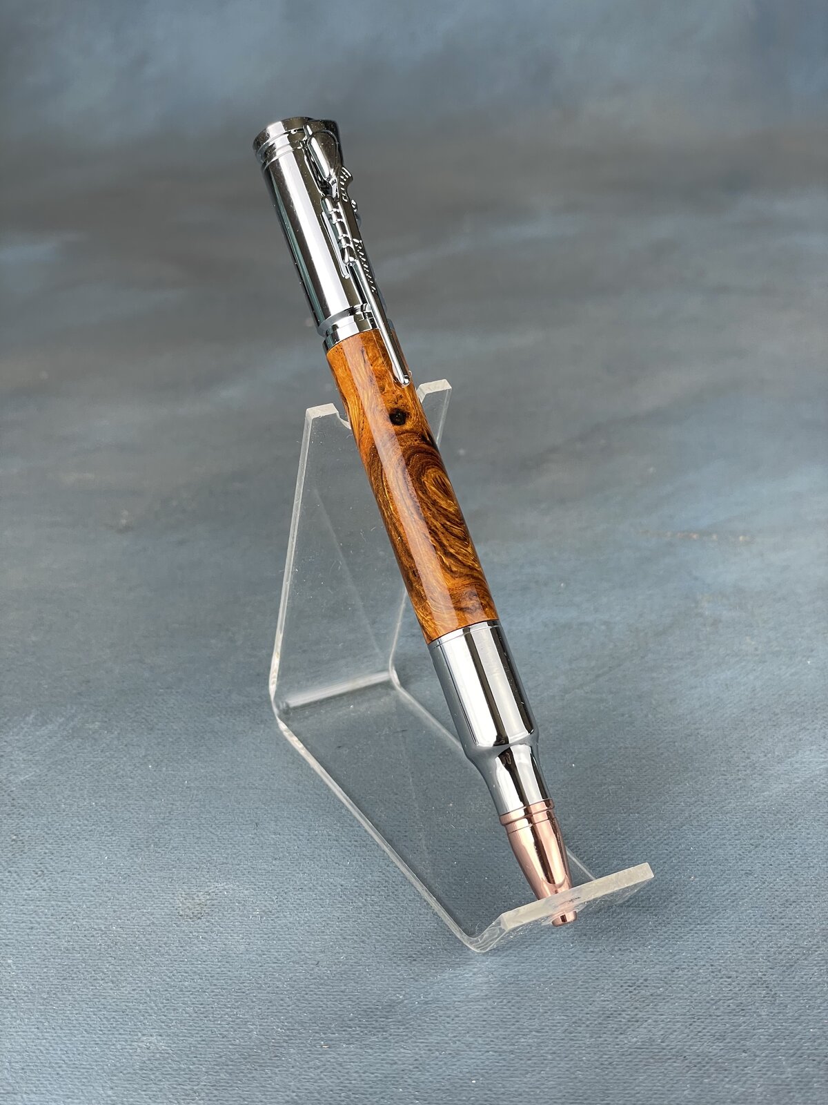

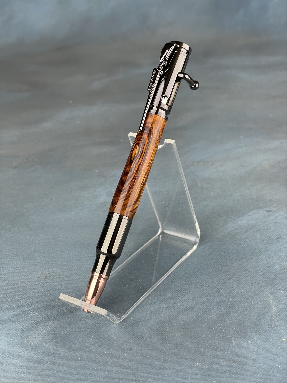

Finally I bought some great, figured desert iron wood. My typical 16 coat CA finish.

Stunning pen Mark. When you find a DI blank like that, it rivals much more noted timbers. Excellent. 👍 👍
