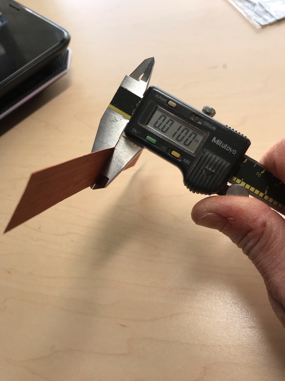

I’m bored soooo,
KenB259
Dec 24, 2017
3,576
Michigan

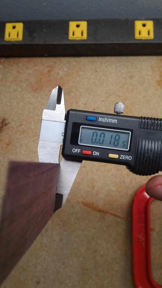

I'm giving you all a challenge. I'm pushing my new thin rip jig for my bandsaw to its limits. So here's my results , padauk, 7/8 thick, 6 inches long. Ripped to .010 thick, consistently. Are you bored too? Can you do better? Like it's said, without pictures, it never happened[emoji16]

Ken, I'm sorry, but I can't take part in this challenge, my saw and all other tools are in storage. But I had a couple of questions, like what brand of saw and blades do you use? That is a nice thin cut you're getting from your saw, being able to cut stock that thin would give you lots of choices?

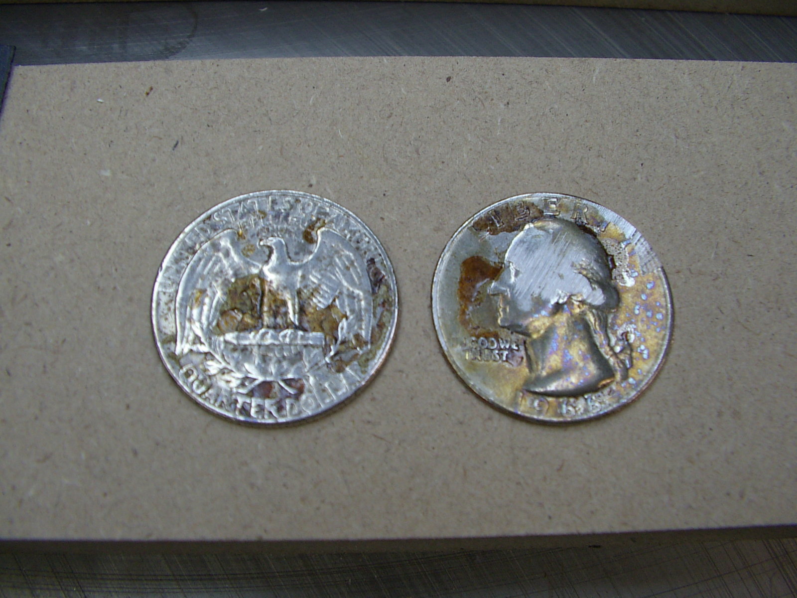

Count me out. I am definitely not bored and to set up to do that not in my park for now. Good luck. Do you have a metal blade and if so and really board try slicing a quarter in half. I did it on a scrollsaw.

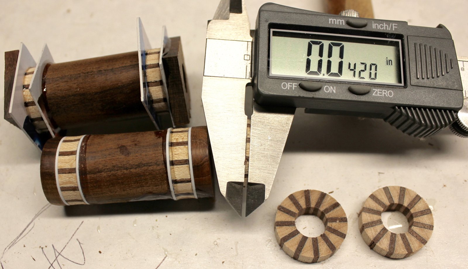

I'm not at home to really try to push the limits, but this was a recent pen where I did play. While you have me easily beat, mine was segmented. I was very pleased the glue joints held. This was on my Byrnes Table Saw.
Len
It's a Jet bandsaw with Timber Wolf blade. My favorite bandsaw blade. They are designed to run with lower tension.

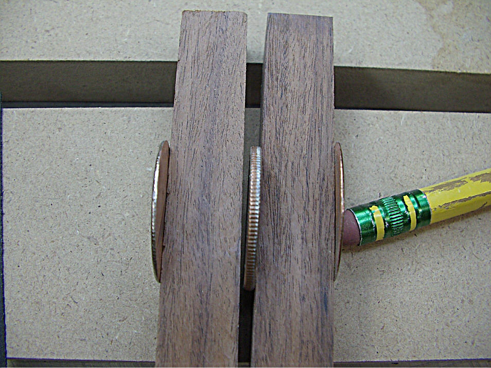

Heck Ken said he was bored so I gave him a challenge. Maybe he needs to get a job in the Deli dept and slice meats for subs being he likes to slice things thin. 😇 here is my quarter.

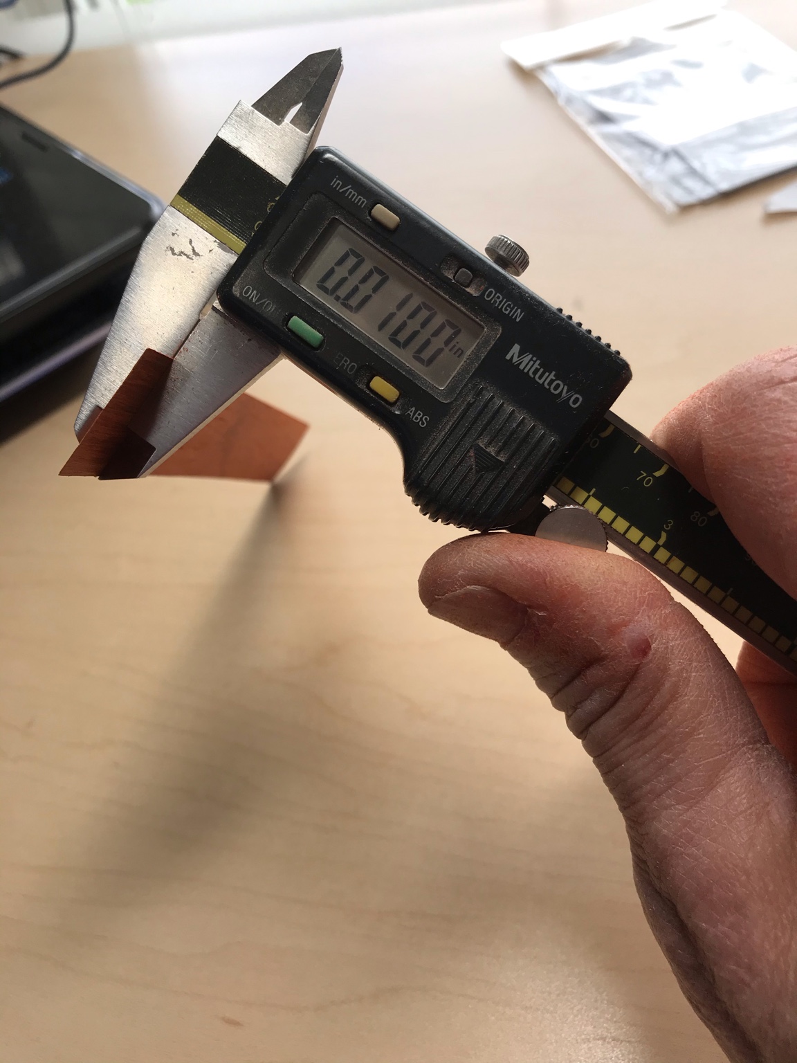

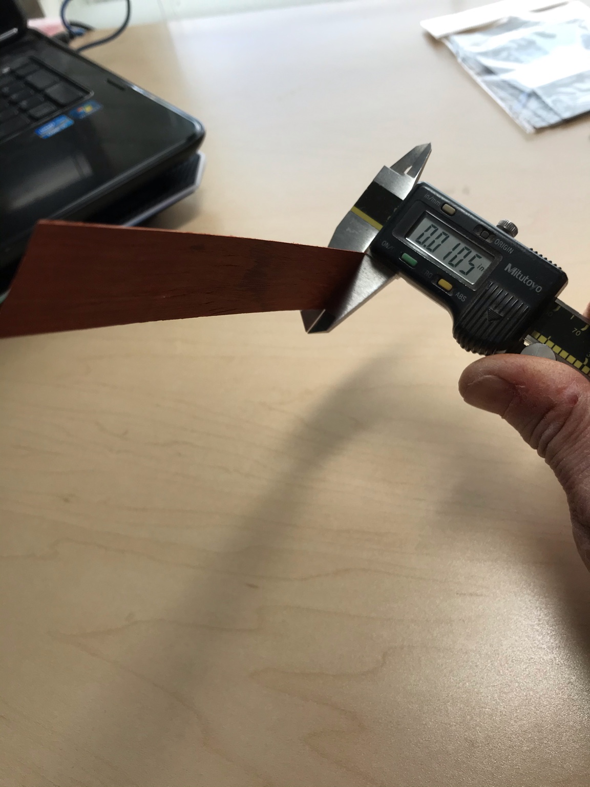

I don't have any fancy jigs, but a simple DIY fence on a $100 benchtop band saw got me these, haven't tried for thinner, but I'm sure I could get there without much trouble.
