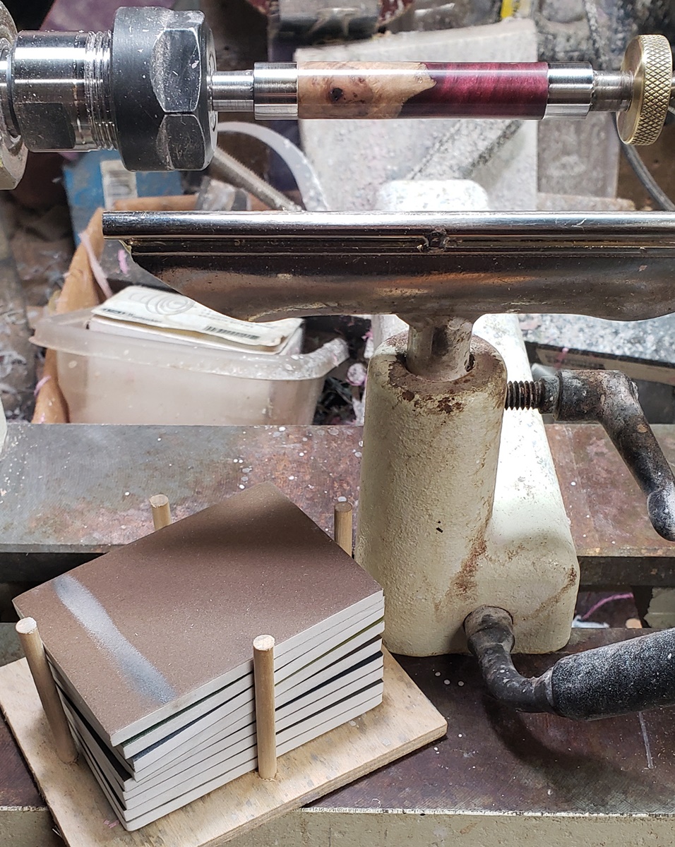

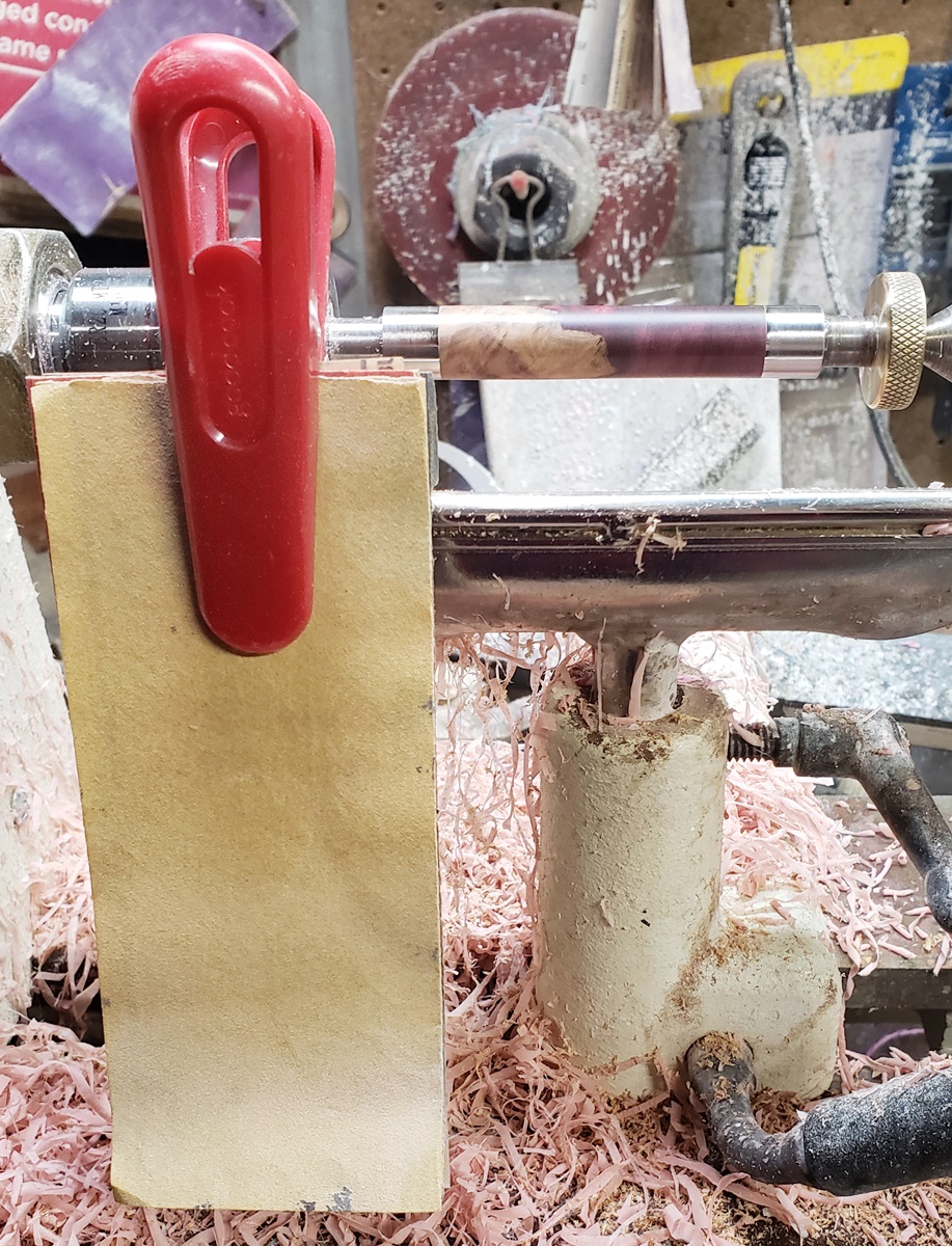

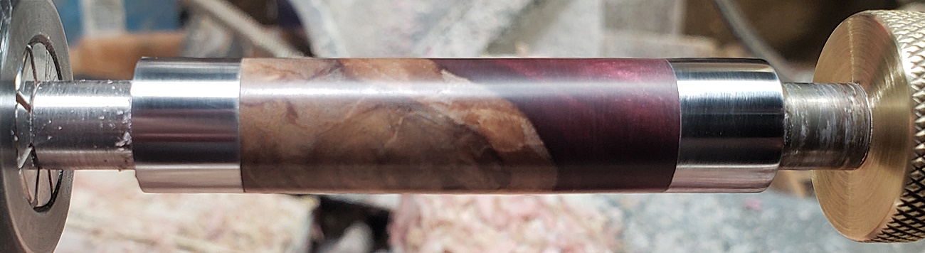

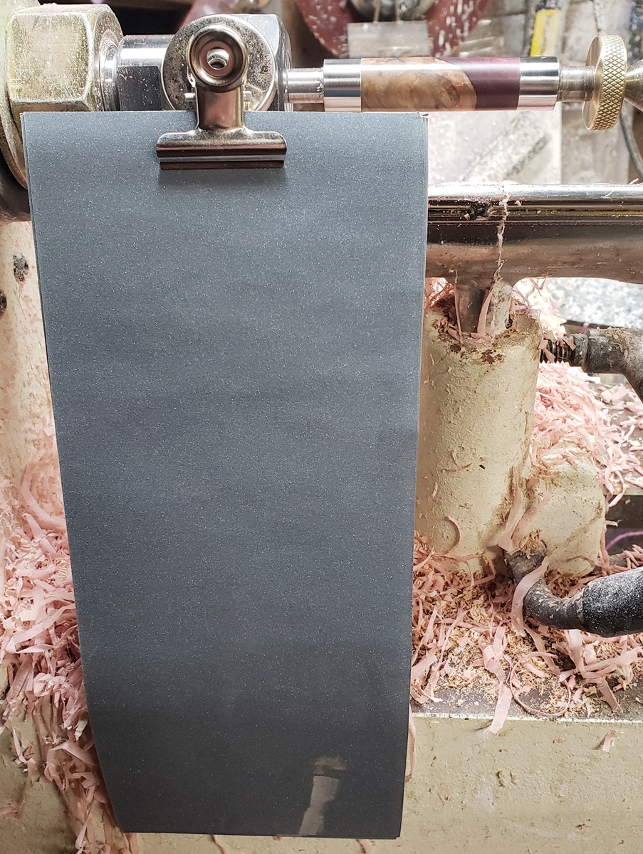

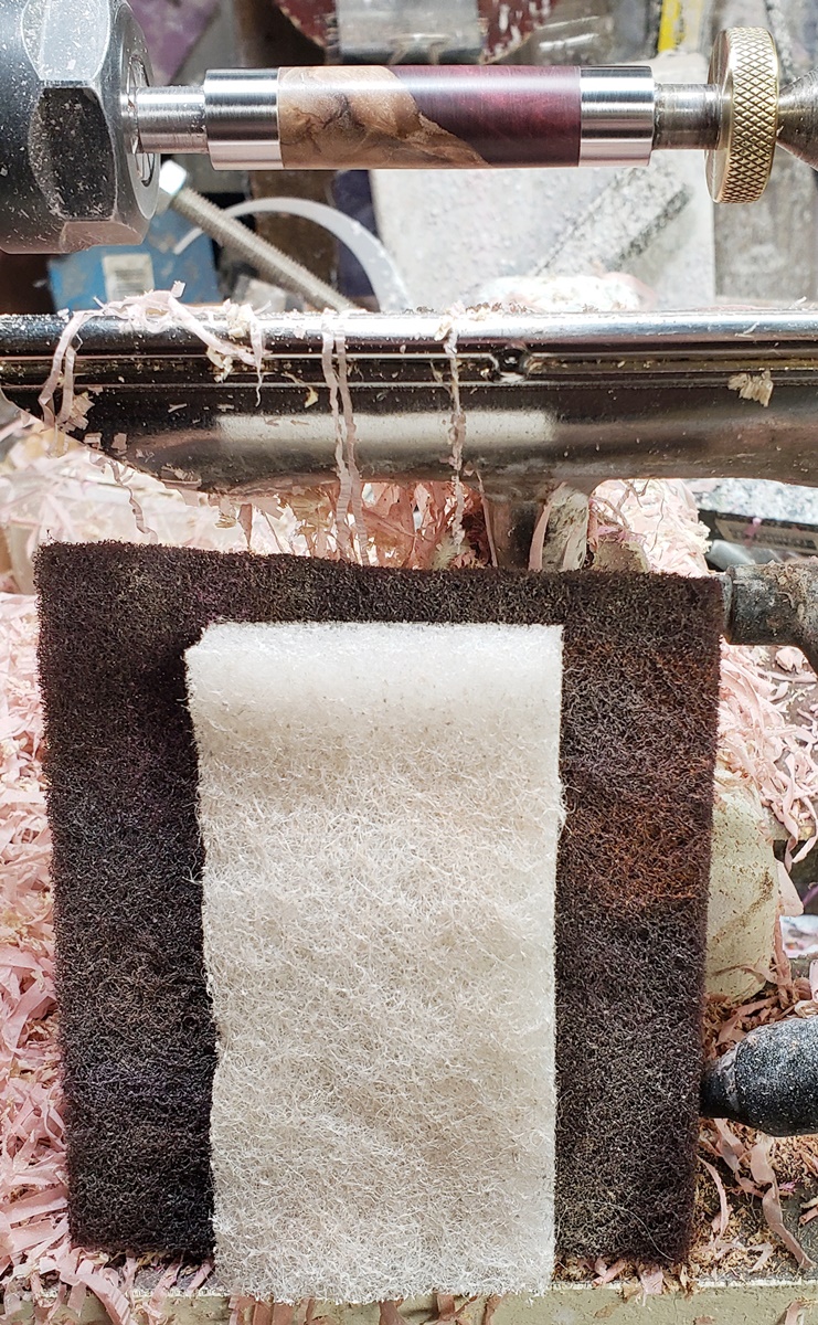

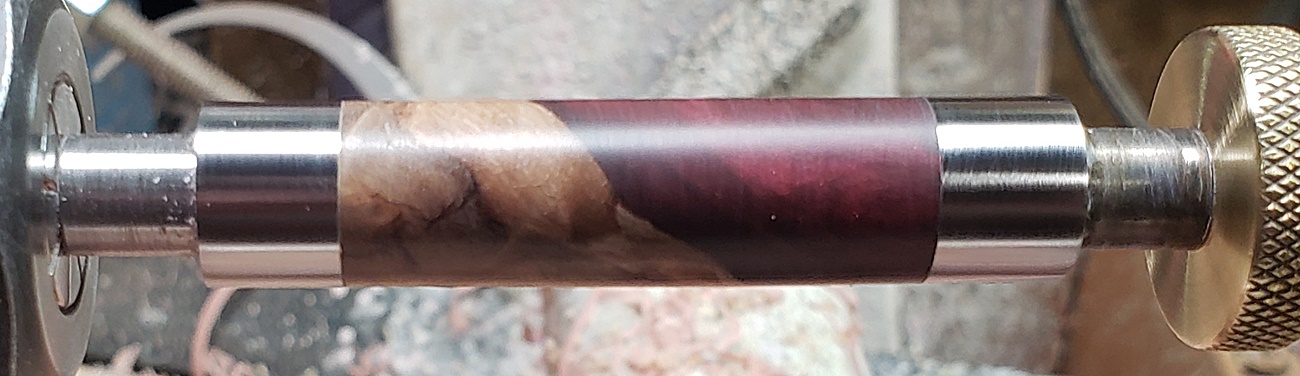

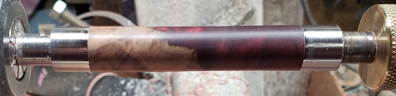

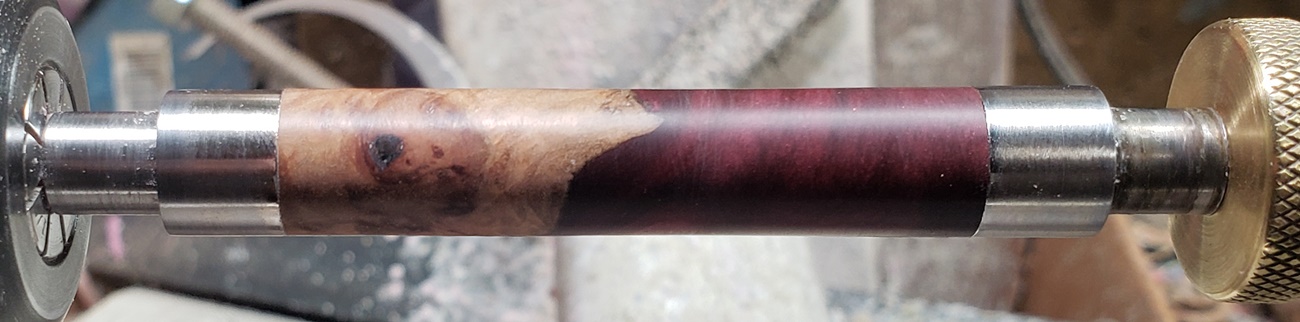

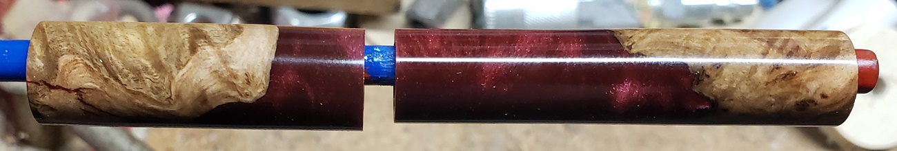

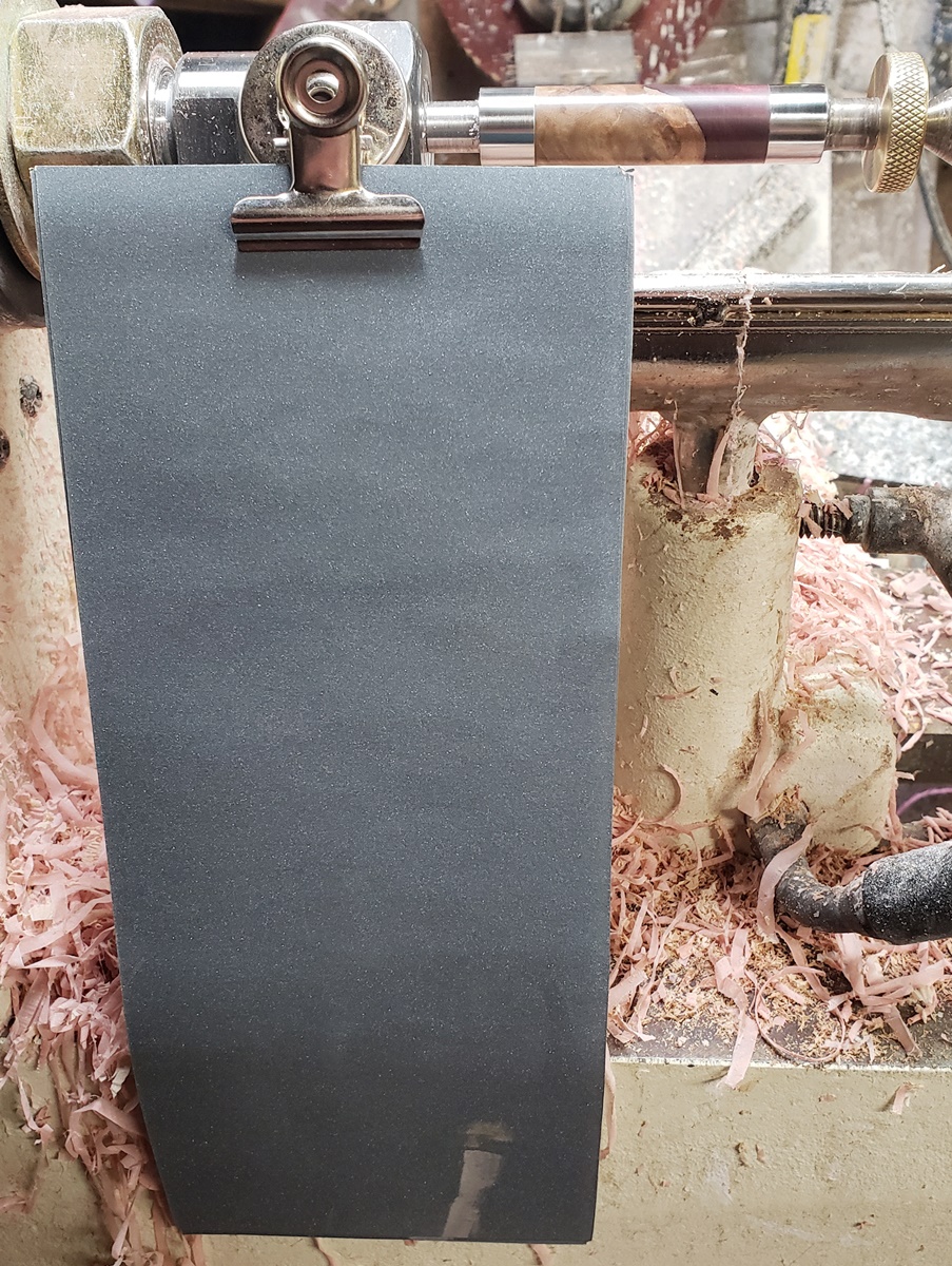

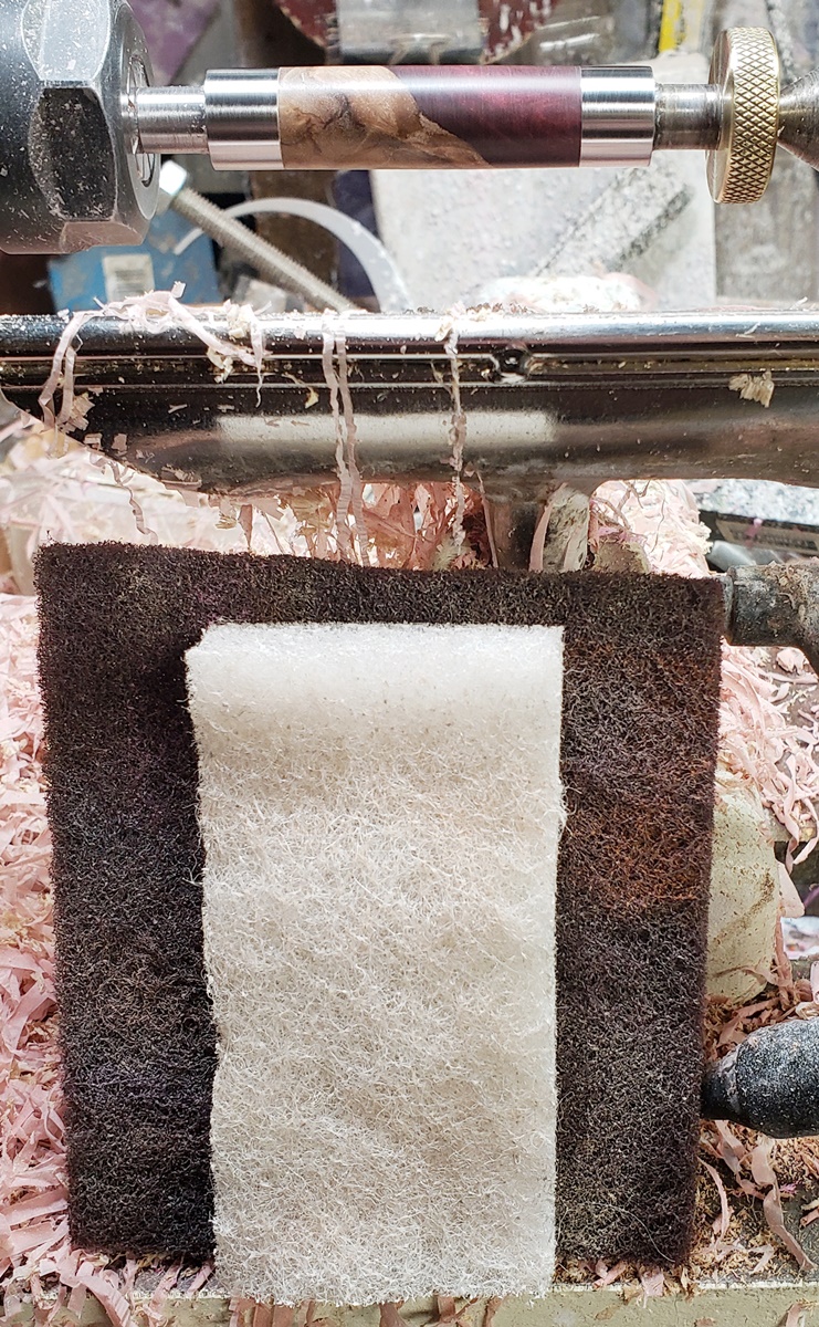

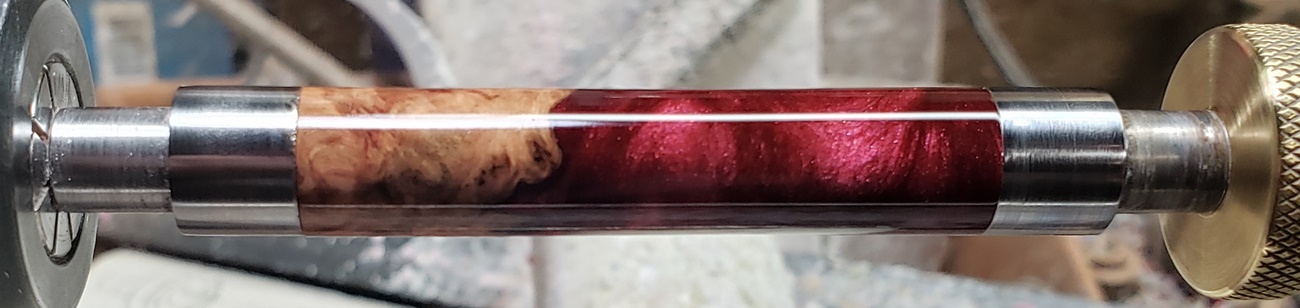

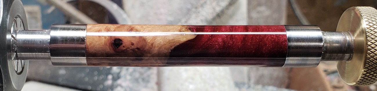

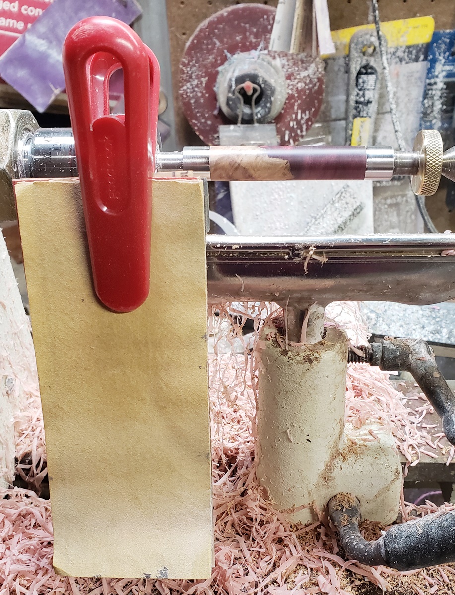

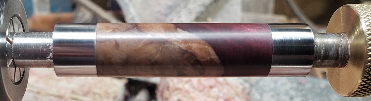

This is where I'm at. The first one was sanded to 600. The second one was sanded to 600 then I used two grades of synthetic steel wool. The second one looks a little better to me. Later today, I'll sand to 3000, then use Pens Plus on them.

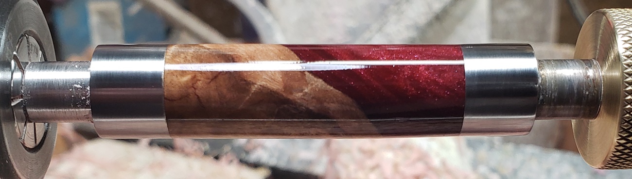

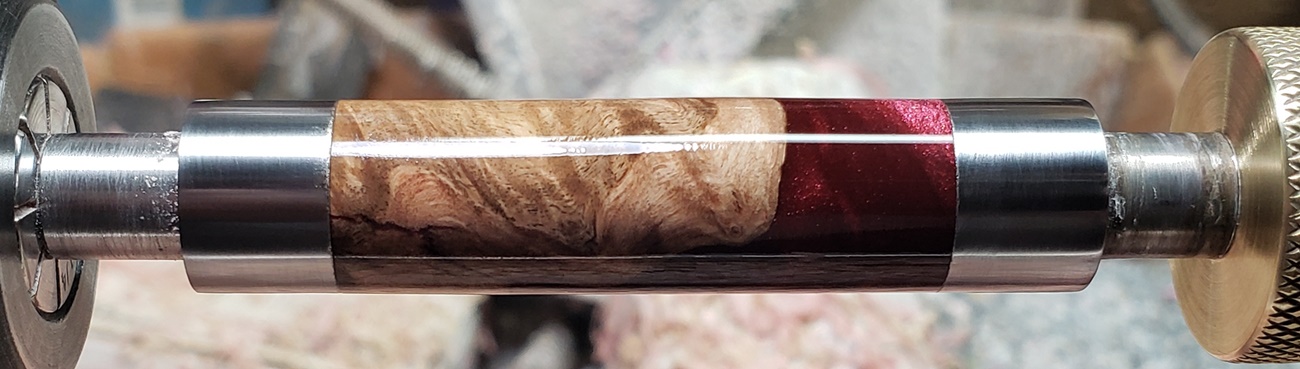

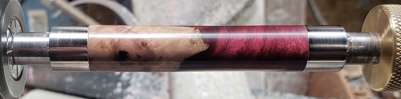

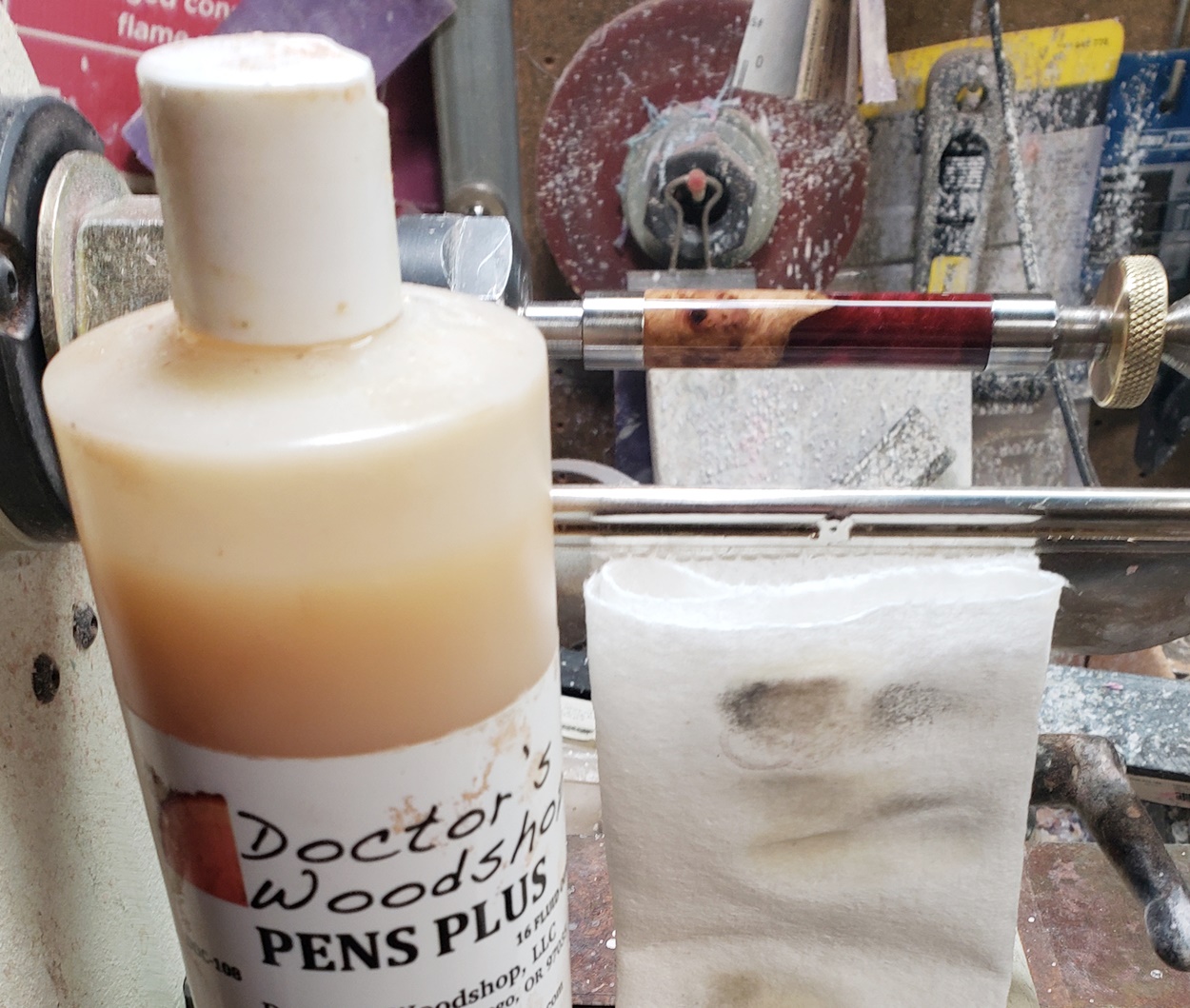

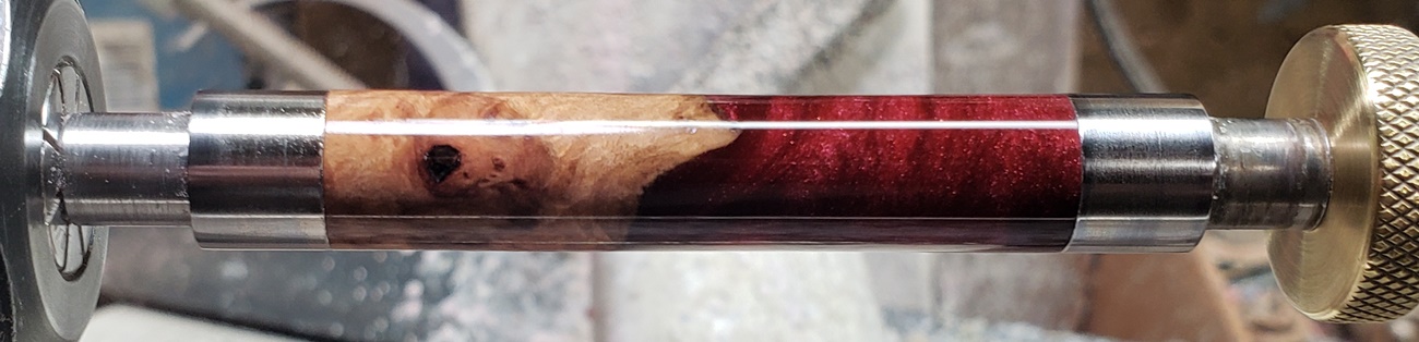

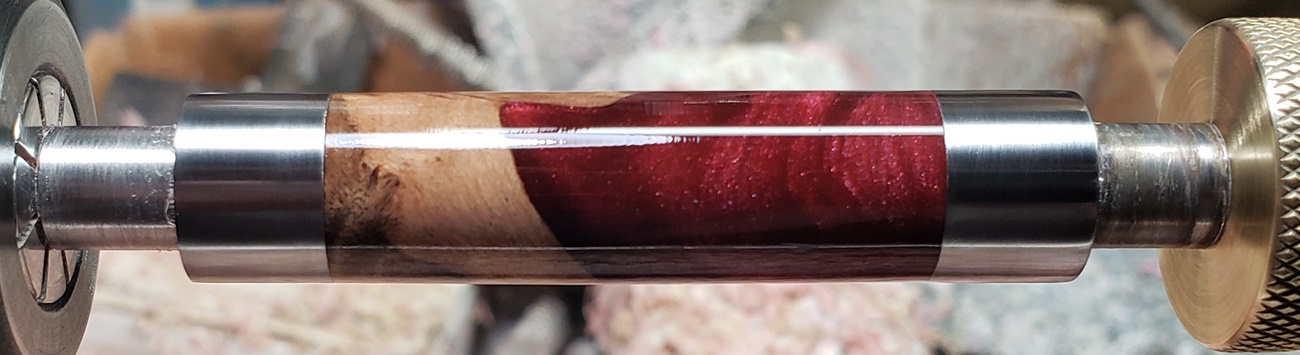

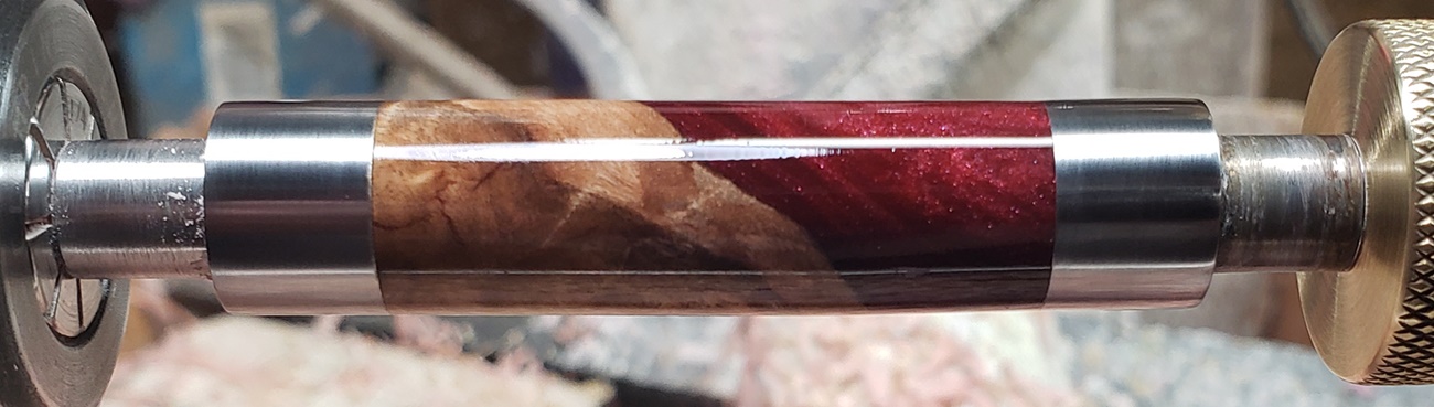

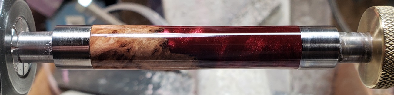

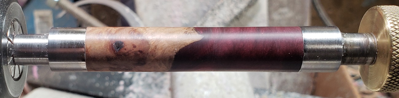

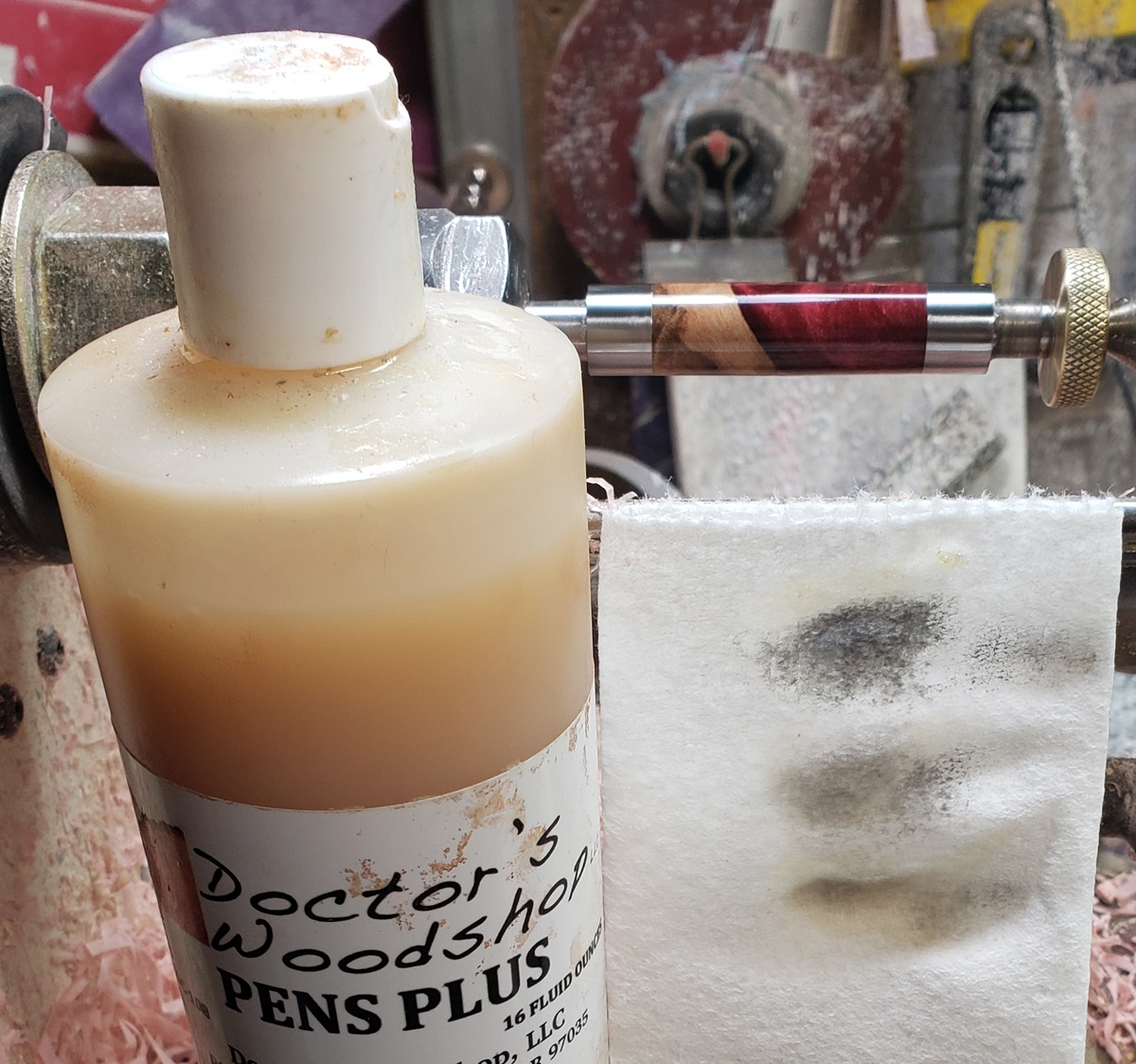

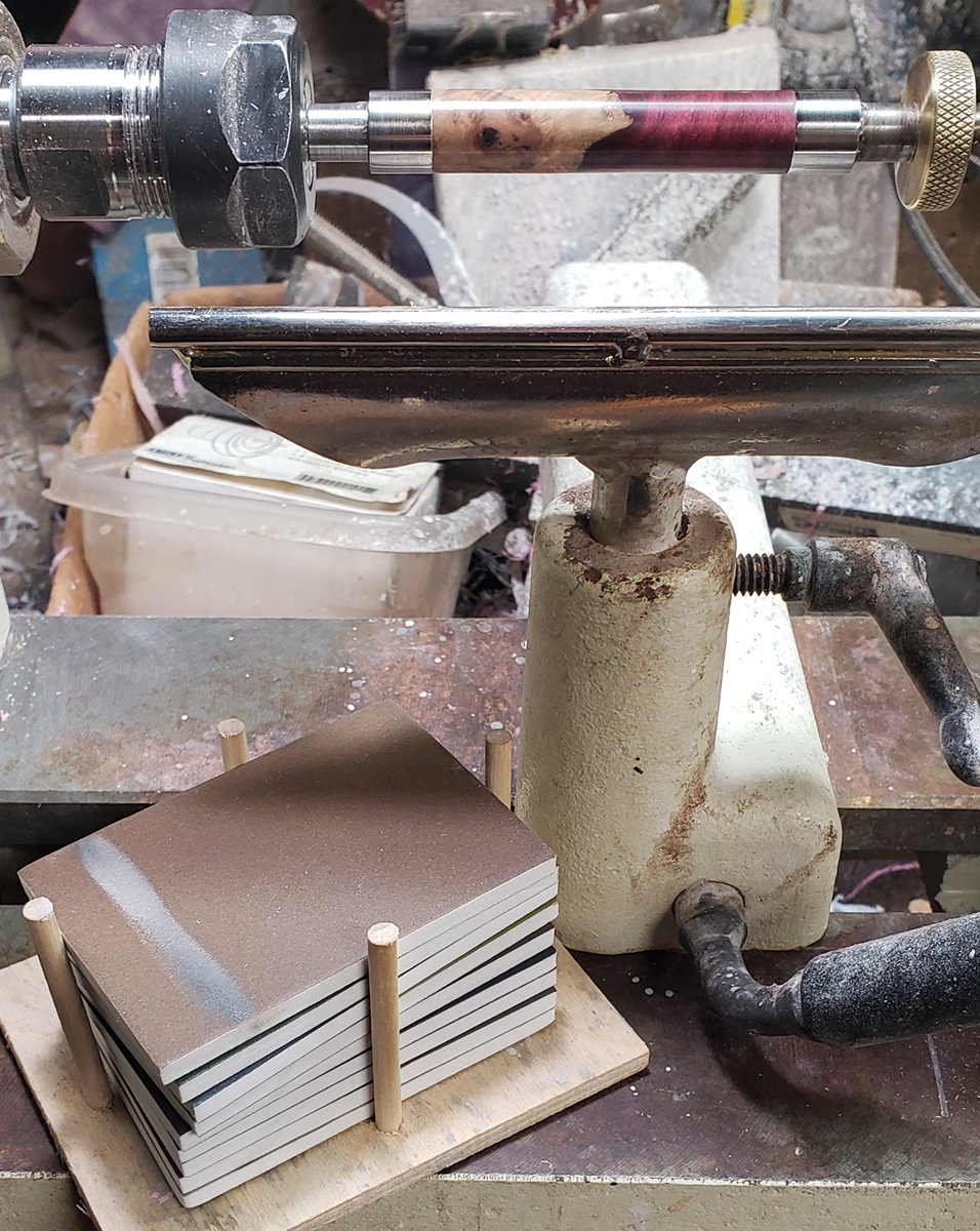

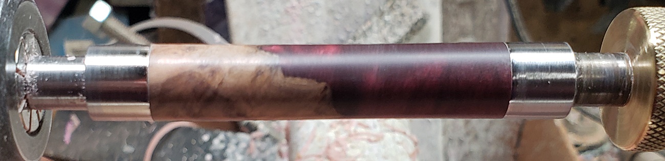

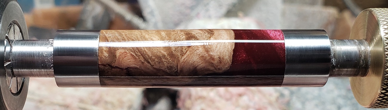

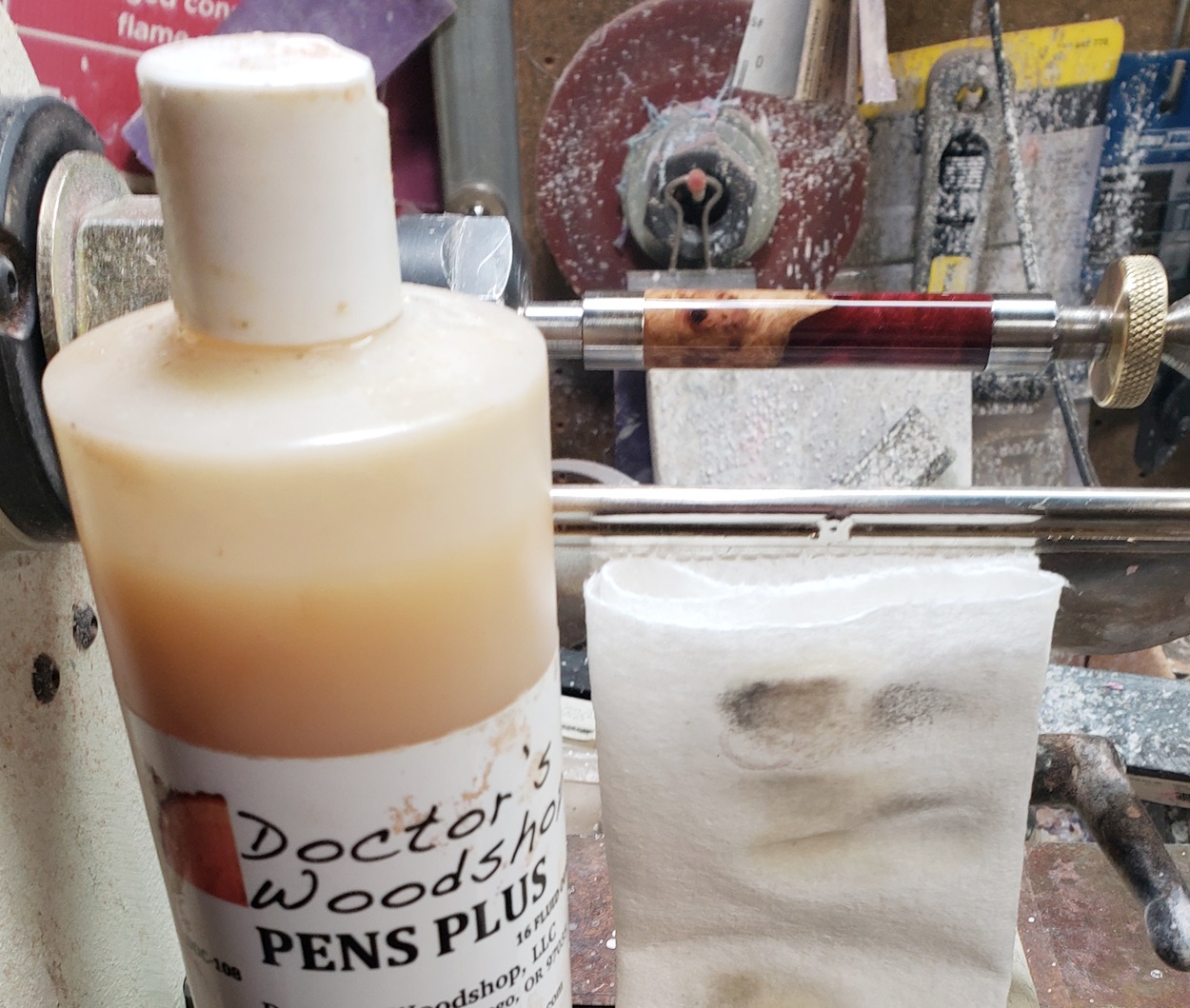

800-3000 grits (seven grades), then Pens Plus. Doesn't look half bad.

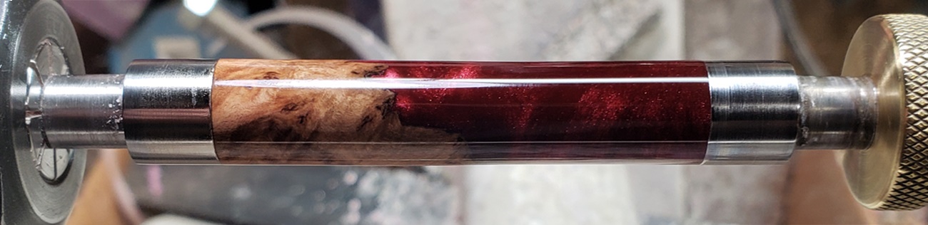

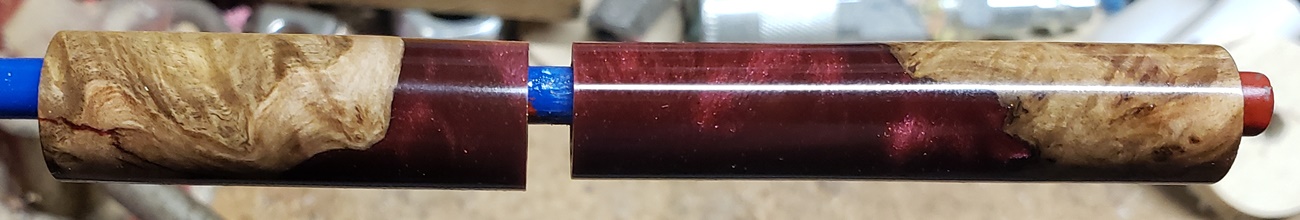

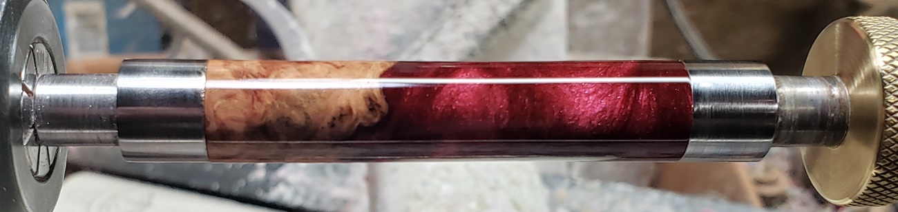

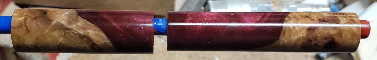

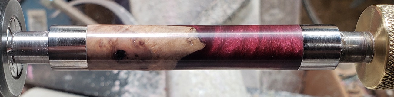

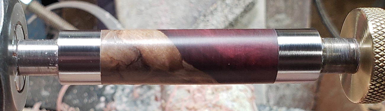

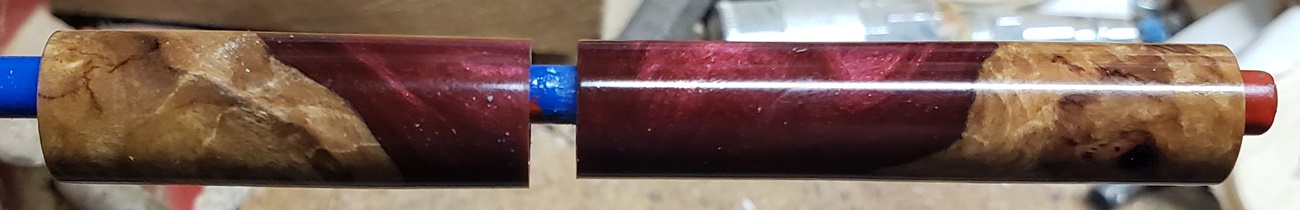

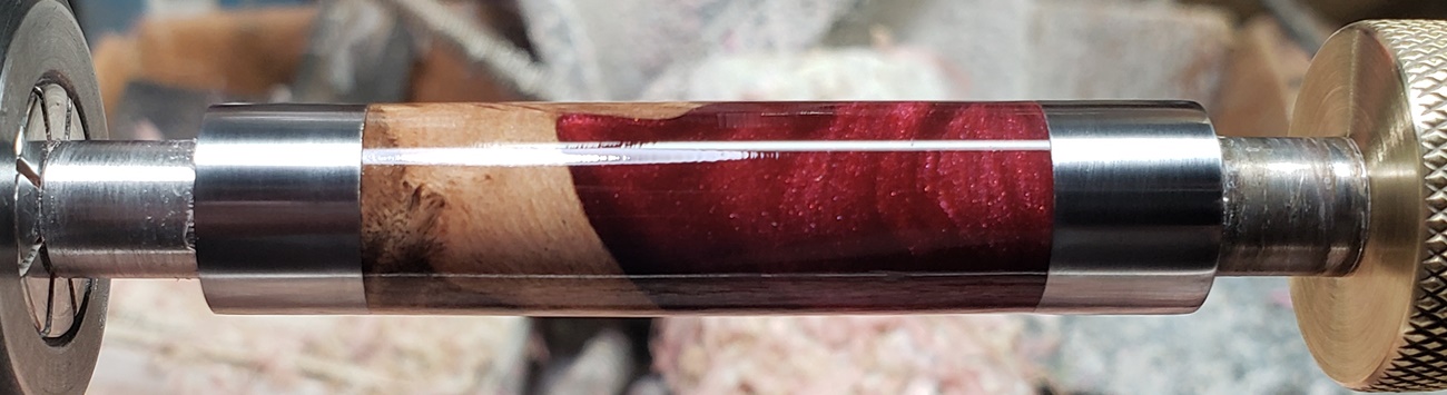

I had a new set of Micro Mesh pads, so I decided to try them on the other body. It may have turned out a tiny bit better, but it's almost impossible to tell. Regardless, I'm very happy with how both turned out. A really good experience with my first hybrid blank.
