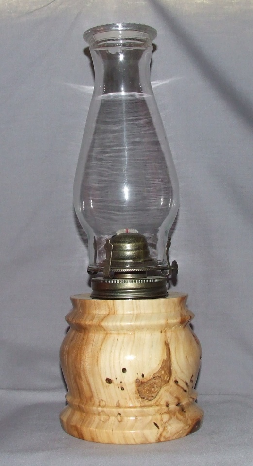

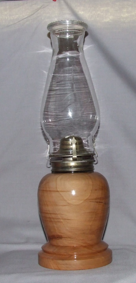

Hurricane season is nearly over, but we might still need a light here or there.. especially in keeping with the wind has been blowing here in my part of the country... These two lamps use a 1/2 pint Mason jar as the oil reservoir (tank) and have adapter lids that also has an adapter for the burners to screw into. I turned these, then hollowed them out to take the little jars and epoxied the jars in place. The finish is Sanding sealer with polyurethane over them... one lamp is Bradford Pear and the other is spalted Sycamore. The bases are about 5 1/2 inches diameter and between 5 1/2 and 7 inches tall. Overall height of the lamps are 14 inches for the Sycamore and 15 for the Bradford pear.

Very nice, Chuck. I really like the shapes of those.
Where do you get your adapters? I think I'd like to try some of those - looks like fun.
