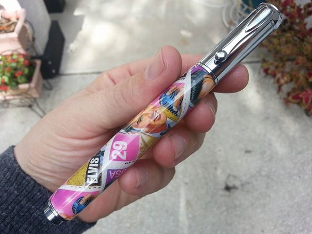

Happy Holidays everyone. Here's my first successful stamp pen. This was one of the Christmas gifts to my mother in law. I think that I'm now the favorite. I tried the Modge Podge process twice, and even after waiting a week before casting in Alumilite clear, both clouded horribly. I took one of the failed alumilite blanks, overturned it and just used CA for both attaching the stamps and the finish. It took about a bizillion coats of CA to build it up, but it worked none the less. Thanks for looking and comments are always welcomed.

Thanks for all of the comments guys. My MIL is a huge fan as well, and that's why I'm her favorite right now. I take that as a huge compliment Chris, but I don't think I'm at Steve's level just quite yet!!
