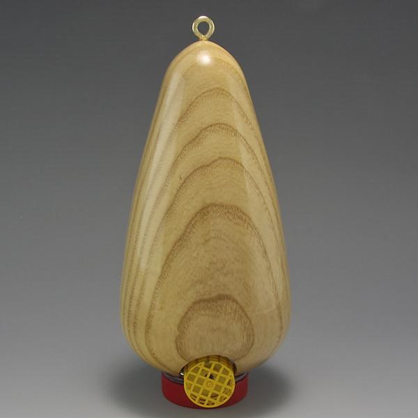

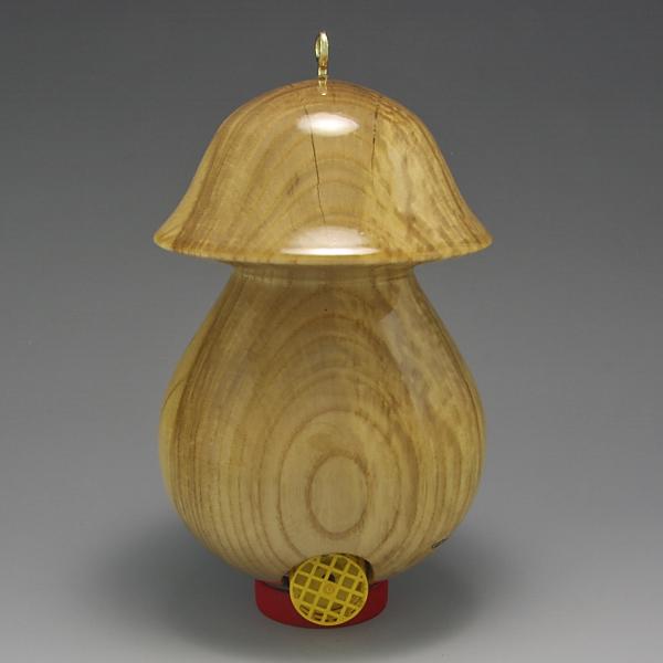

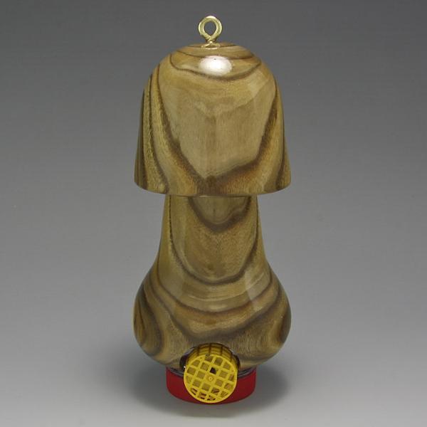

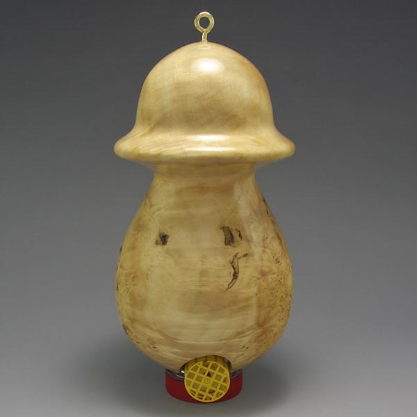

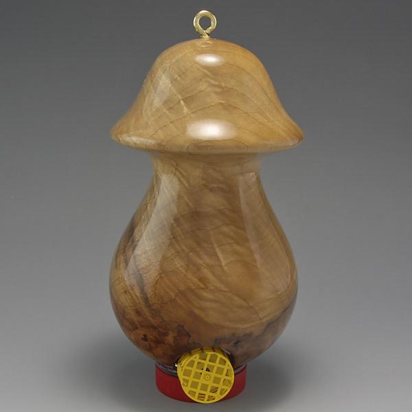

The hummers should soon be back in the area so I have been building my inventory of feeders. They have actually proven to be my best seller at shows. Here are a few of the latest.

Seamus - just look at my avatar. That is taken from my living room window. Although it only shows a portion of the feeder it is made from white ash. It really isn't the color of the feed that attracts them. The dyes can actually be harmful to the birds. We have a very dominant female that defends our feeder like crazy from other hummers.

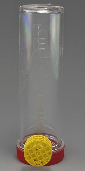

Pet shops and even hardware stores may have them. I bought these at Wayfair.com since they would ship to me in Canada. Even with customs brokerage fees they were cheaper than anyone up here would sell them to me. If you check amazon.com you can probably get an even better deal but unfortunately I couldn't get them shipped here. They are Perky Pet 215P feeders.

When I first started making the feeders I used silicone to fix them in place. I now use electrical tape to provide a friction fit so the feeder can be easily removed for cleaning and filling. Although I like the idea of the friction fit it can be a bit of a pita to get right as the different woods move differently. I am considering going back to the silicone and fixing the feeder in place.
