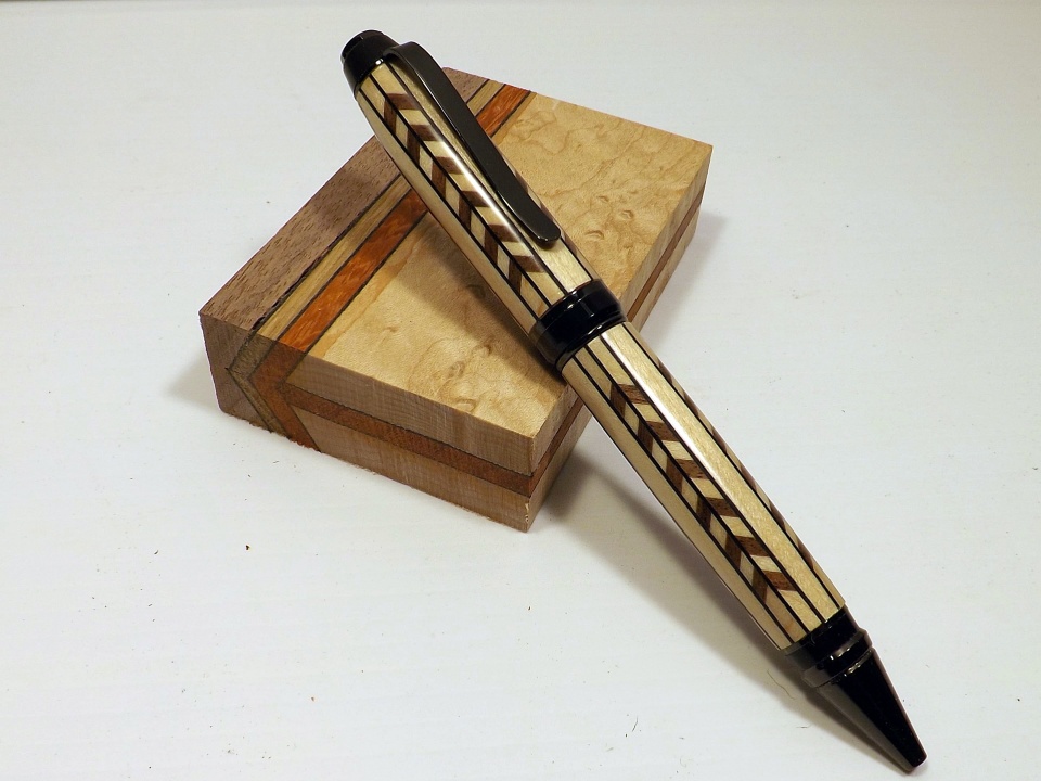

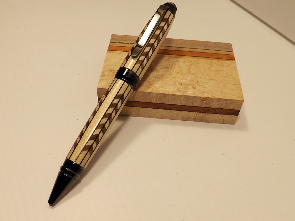

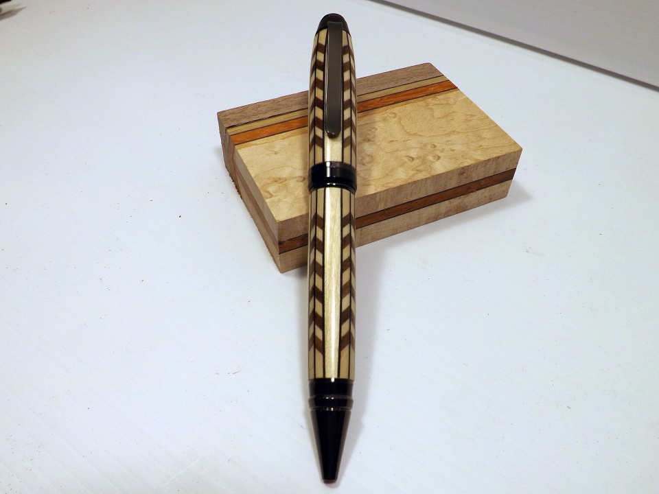

This was my first attempt at an chevron like the ones that Mark James has posted here, turned out well. There's a little bit of a learning curve and some things I would do differently on the next one, but all in all turned out well. Mounted on a Cigar Pen Kit in black chrome, with maple, dyed black veneer and a little walnut.

Beautiful Pen Mark,
Excellent Segmented Chevron Blank,
though the Right Hand portion of the Chevron, in Photo 1, seems to miss the alignment by a Gnat's Whisker, but I am being very critical.
Superb Fit and Finish,
Great Craftsmanship,
I look forward to your Next one,
Brian.

Thanks Mark, I found a couple of things doing this that I will have to adjust technique to correct. One was make sure that the pieces are exactly perpendicular to each other and thickness is critical. Two make them a little wider than needed because you may have to adjust the angle at glue up to align the chevrons, that's were I went off on the lower tube on photo 1. BTW the HTMJ in the title stands for Homage To Mark James, it would have been much easier if I would have looked in the library first, would have cut the learning curve lol.
