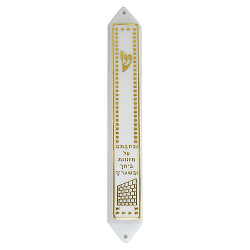

Hello,
I had an idea of starting to turn mezuzot. For the ones who don't know, mezuzah (or more accurately, the mezuzah's case) is a small, hollow case which every jew needs to fix on the doorposts of their house, living rooms and bedrooms. the mezuzah contains a small parchment called the "klaf" with the prayer "Shema Yisrael" written on it.
Anyway, How would you approach turning an object that needs to have its back flat with some sort of fixing method in order to fix it on doorposts, without the klaf inside falling off? Any ideas or suggestions are welcome. I attached several pictures from the internet for your reference. Thanks!

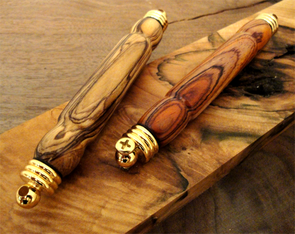

I found this photo at philadelphiawoodworks.com
They offer a class in making them but not a kit. It appears that something like a Tree Ornament kit might work and the finished Mezuzah could be hung on a nail? I don't know if that would work, but perhaps it might give you some ideas.
I've made Mezuzot for my children when they bought their houses. I turn the Mezuzah first on the lathe and then cut it in half down the middle. Use a small chisel to hollow out the half round to hold the klaf, use a rasp to flatten the two ends and drill a chamfered hole in each end. I cut a thin piece of contrasting wood to the same shape as the Mezuzah and use this as a backing plate to hold in the klaf. Use the chamfered holes to screw the Mezuzah into the door post.
It looks like they are using parts from 2 x Rockler toothpick holder kits (the hole is where the keyring would go through). Here's a link to the equivalent part from Woodcraft - LINK
Thanks, it looked familiar, I just couldn't remember exactly what it was.

Take a look at Etsy for ideas. Some are square/cube shape as if they are a pen blank.
