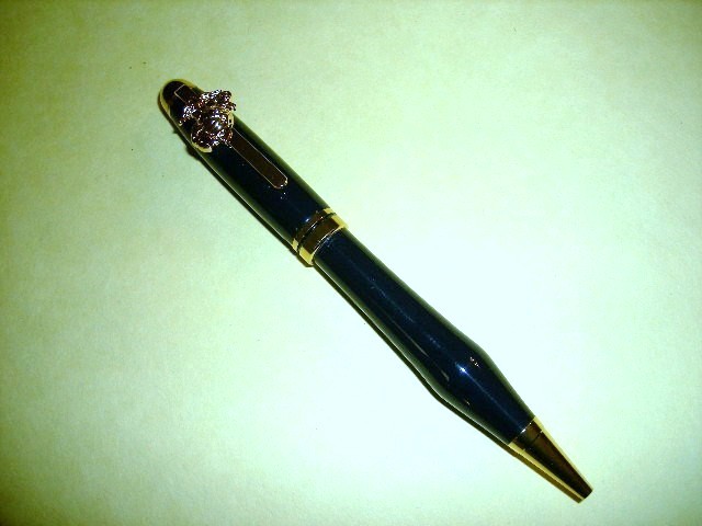

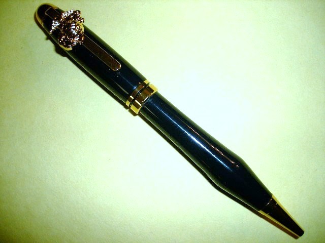

I would offer one suggestion for the emblem. I have made a few like the one attached for several Marines, and I exchanged the clip for one I found at Wood Pen Pro. The size may be much more than you wanted if you were to consider separating the emblem from the clip, or to maybe use the clip as is. I applaud you for your consideration and effort to honor the Iwo Jima vets. My dad's second, last and worst wound was at Iwo. He took one in the hip from a Nambo, spent 3 days on a hospital ship, was given over 150 injections of penicillin because of the contaminated slugs the Japanese were using, and pushed to get back to his company instead of being shipped out. So, for him I say: thank you and Semper fi.

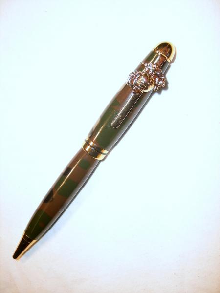

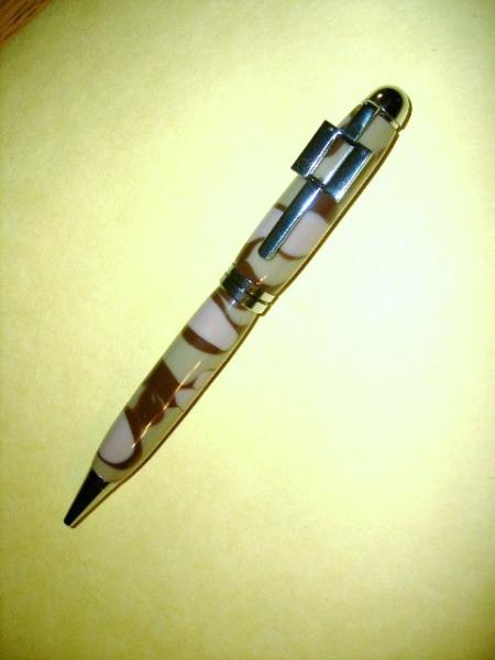

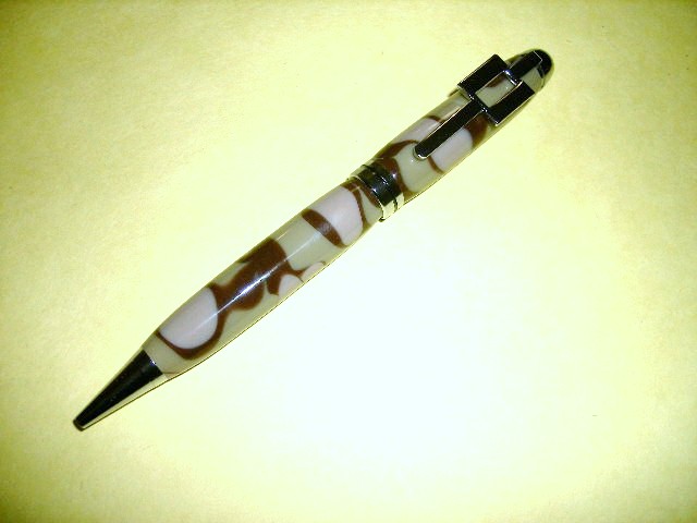

Some possible ideas, Sean.
t001xa22
Jun 17, 2011
441
Arlington, TX
Then again, there are those beautiful pens that MrWright posted on 8/8/11 with the Corps emblem engraved on a wood barrel. I don't know where he got his engraving done, but it is an excellent job. Maybe something like that on rifle stock wood?
