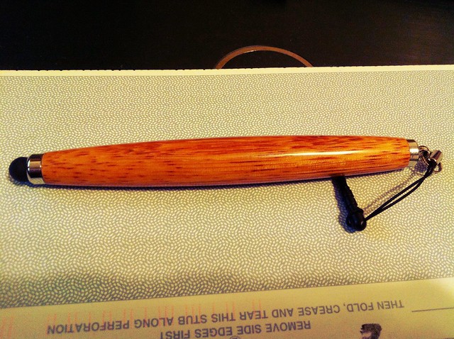

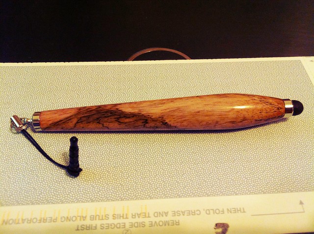

These are the kits bash ones I made today.
I used parts from the Woodcraft mini stylus.
On this one I used a kit tube at either end, and the middle is tubeless. Later, when I realized they need to be conductive I stuffed the center with tin foil.
On this one I used a 9/32th tube from home depot. It is .14mm bigger then a true 7mm tube. There was not enough friction to hold the fittings in, so I used a drop of CA.
The both work, but just not as well as I would like on either my iPhone or Android tablet.

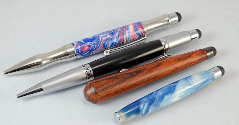

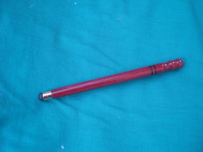

I have probably used 50 or more of the CSUSA stylus tips and they work great. I have not received a single complaint.
I've made a lot of stylus pens and stylus without pens and they work great and everyone loves them. In the slimline style, my wife prefers the Berea kit while I like the PSI kit. I've made a ton of Sierra stylus pens. The ones with the circuit board blanks really look good. My new favorite is a Cigar stylus pen, available only from Bear Tooth Wood as far as I know. Love the look and feel.
