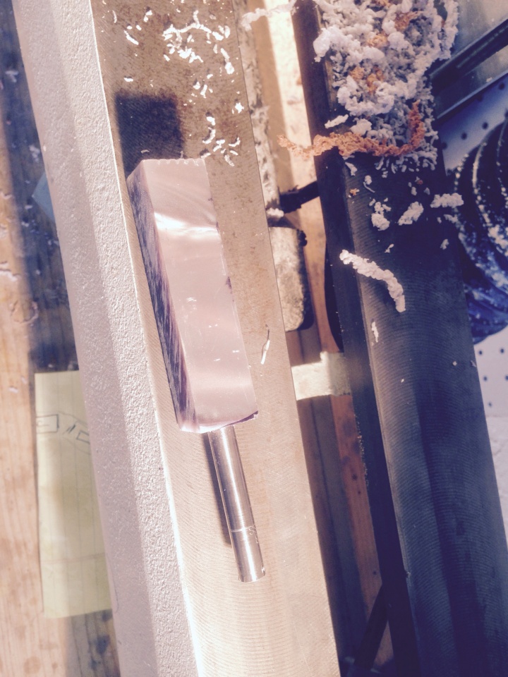

Just when I thought everything was under control. Hello trash can.
