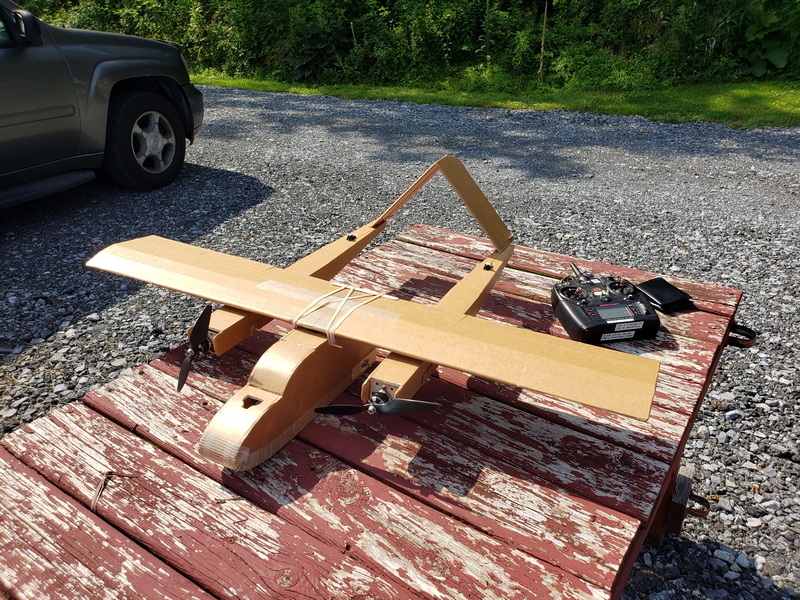

Thanks Everybody! Those are ALL great ideas! One of my other hobbies is flying R/C model airplanes. I sometimes make these out of "foam-board" (the stuff science fair backgrounds are made of). It is sturdy, easy to glue with hot glue and lightweight. AND it is 3/16" (5mm) thick. I need to be able to cut the FB at accurate right angles. but the lips on speed squares doesn't allow the square to lay flat against the FB that prompted my question.
I think I will convert a drafting square with lips that are 3/16"minus on each side.
PS. This is a twin motor A-Tail (Inverted V-tail). It is a beast and will climb straight up with anything over half power.
