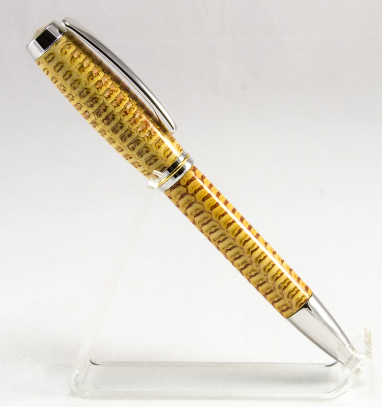

I've done several corn cob pens. After the cob is thoroughly dried and kernels removed, I cut it to the needed length and then saturate it with thin CA. Once hardened, I drill out the hole for the tube then saturate it again with more thin CA, both inside the hole and outside. I then re-drill the hole to make sure it will fit the tube and epoxy in the tube. After squaring the ends, I'll start turning it. I turn a little off and then add some more thin CA. I keep this up until I get to the finished diameter. I will then switch over to medium or thick CA to start building up layers until I get all the irregularities filled in. I use accelerator between each coat of CA. I then sand and polish like any CA coated pen.
This method runs through a lot of CA, but it's pretty quick and I've always gotten good results. I find the thinner the starting corncob, the better the surface pattern on the finished pen. This shouldn't be any problem for a 1 1/2" diameter goose call.
