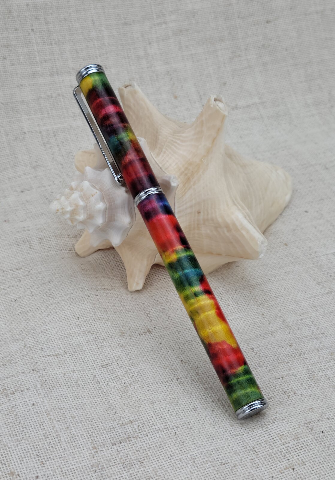

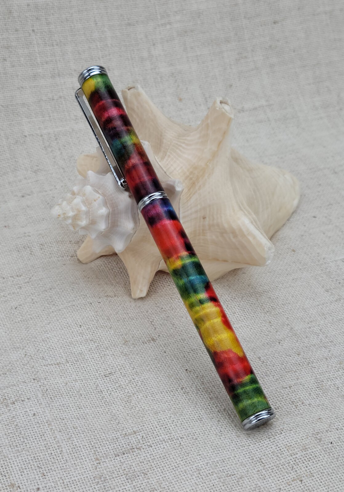

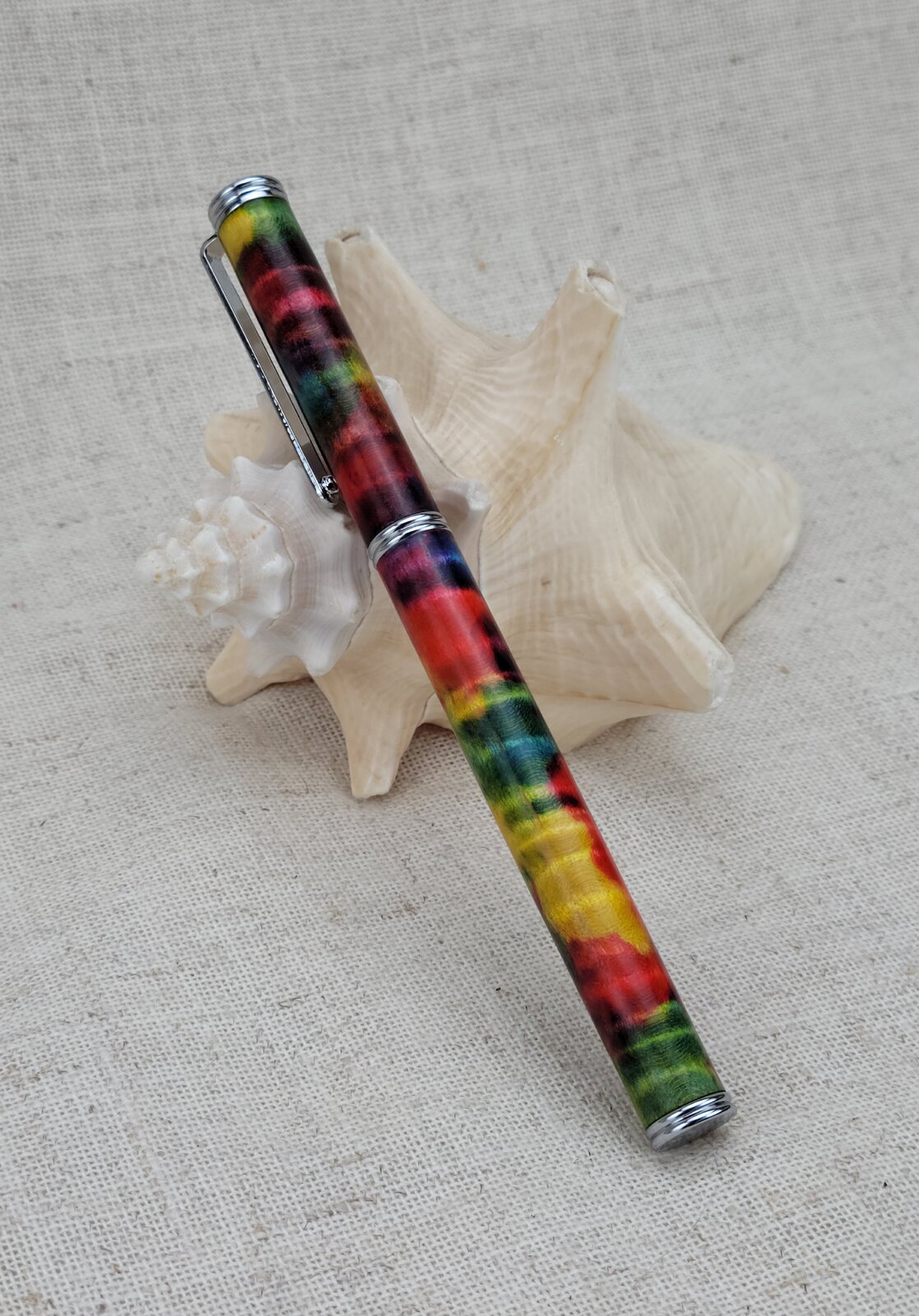

How did you proceed to stain the wood with the aniline dye ?
Aniline dye is mixed with alcohol. I turned my blanks and then applied it as it does not sink too deep (at least not for me). The grain did raise a little with getting it wet, but I was able to lightly sand it without taking all the color off. Obviously, the more you use, the darker it will get.

Thank you for your answer, I will think about this solution,
The rendering is top bravo !
how do you do the finishing once you've applied the color? varnish?

Thank you. That one was fun. It was finished with GluBoost CA. You'll probably see that mentioned here quite a bit. There are plenty of other ways to finish a pen, but CA is probably the most durable for wood (though not the easiest to master).

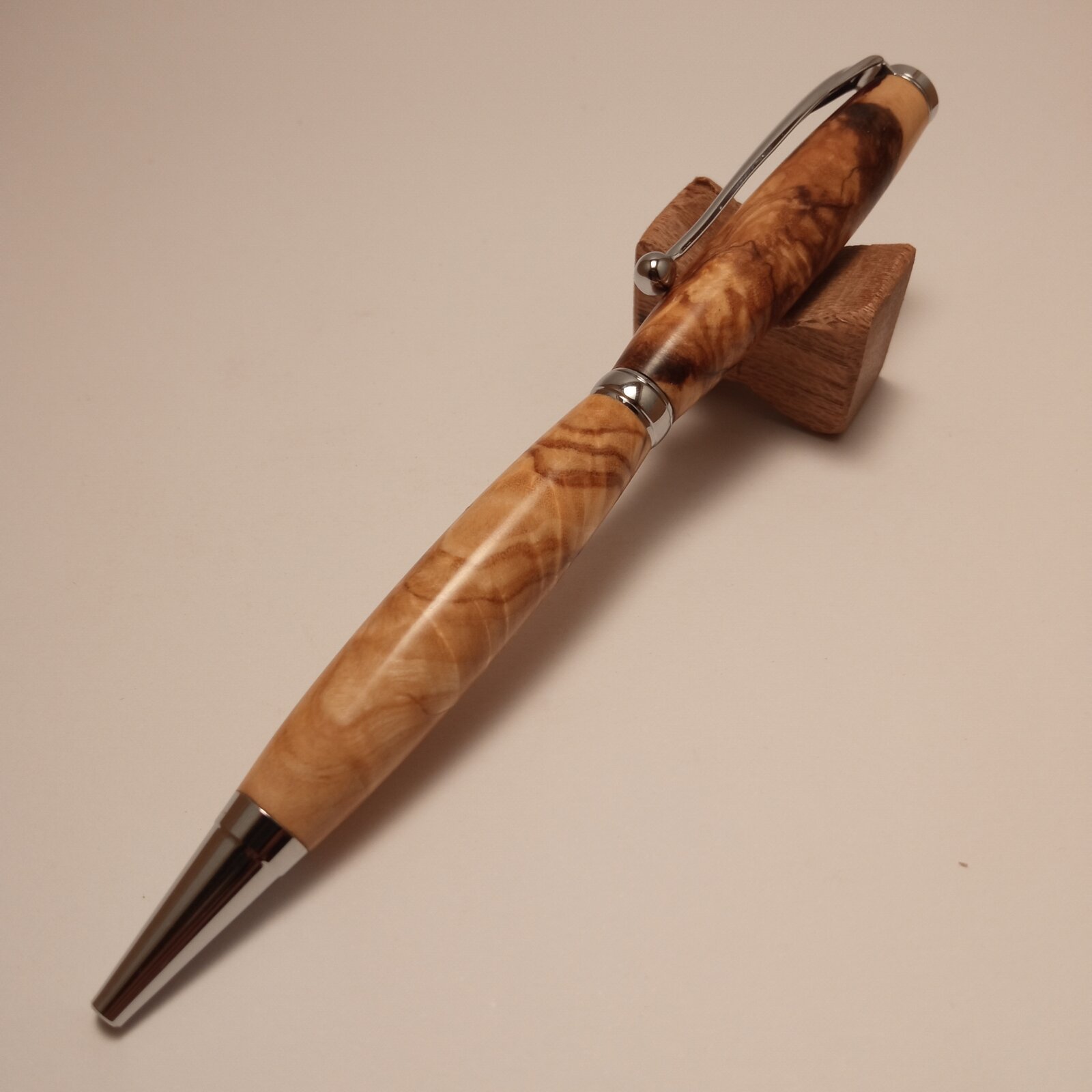

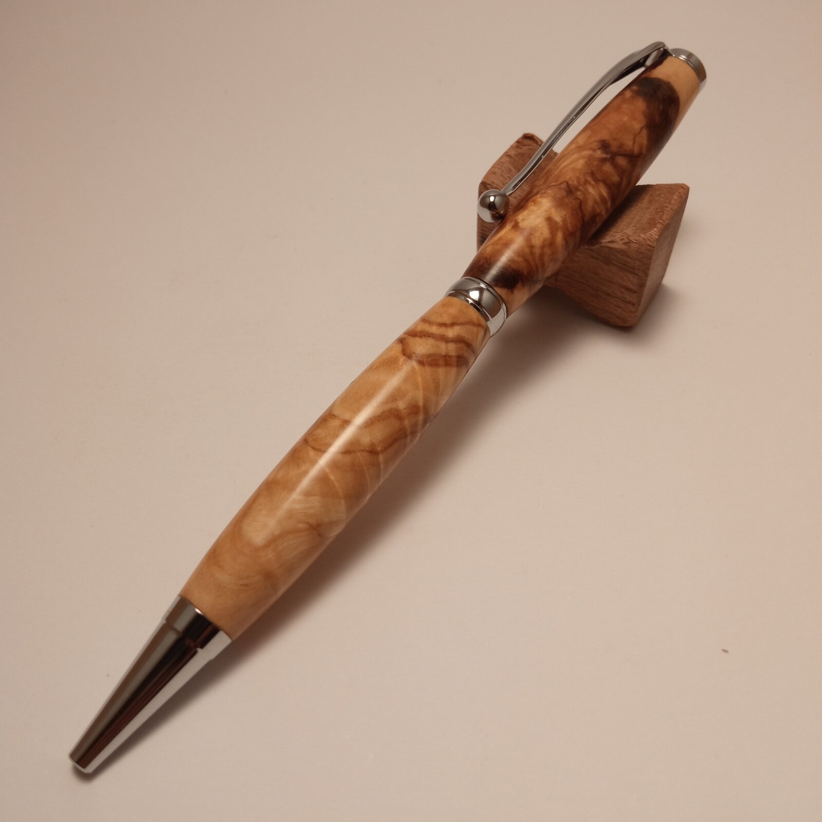

I work with olive wood a lot since i can easily find it here in greece and also because its my favourite wood species. You can finish it any way you like ca, pens plus even plain oil, it all depends the look you are after. Make sure you sand it to a high grit and it will show you the way, cheers.
Olive wood is a magic wood..
Hi MedWoodWorx, Thank you for your answer. Beautiful pen, I love it !
If it's not a secret, where do you order the wood ? 😁

thank you, well i don't buy blanks i cut, dry and prepare my own blanks
