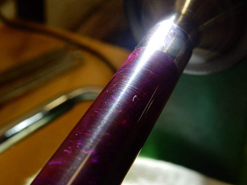

It's kinda hard to show these fine scratches in regular light, so I back lit them with a flash light... you get the idea... what do I do next?
Mike...

Hi Mike,
It looks like you have radial scratches. What I do is turn off the lathe after every grit and sand from side to side (from bushing too bushing). That may help.
jim
Did you wet sand??? How fast is the lathe spinning??? Are you moving the pad both sideways as you are sanding. Do not leave in one place. You have to vigorously move side to side. Do you have the ability to polish??? May want to skip to polishing with a 3 wheel polishing system.
You said you will stop and inspect after each grit so what happened and where did it go wrong???

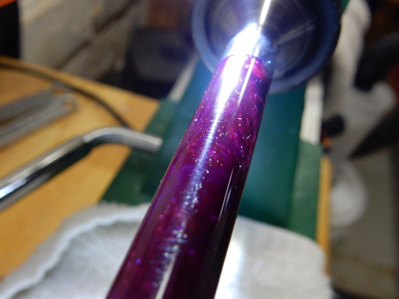

I don't have a polishing setup, but I did find some CA Polish Gloss from Stick Fast. I did 3 rounds of that, and almost all of the scratches disappeared. See photo. So I am going to investigate polishes some more...

Mike, I'm beginning to feel sorry for you. You've been given plenty of good tips in this thread but yet, you still have problems with scratches. Your last photo shows radial scratches remain. No sense polishing scratches. You need to conquer sanding first. WET sanding with clean water. The MM pads should remove all the visible scratches if used properly. I suspect you may not be sanding long enough with each pad. If you can still see these scratches then, start over. Keep dipping your pad in the water to wash off any small chunks that may have been trapped between the pad and, blank. Try this. Make sure you're seeing a milky slurry as you're sanding with the coarser grits. The slurry will diminish as you progress thru the finer grits. Sanding lengthwise as has been mentioned. A friend of mine SHOWED me that this isn't necessary but, I still do it from habit. :redface: Then, you're ready for polish. There are many different ways to polish. Since you have no buffing wheels, you can do it by hand. There are many kinds of polish for plastics. I used the car polishes (for plastic) and, Novus II for years but, recently found 20/20 at Craft Supply (penturnersproducts.com). One buff with that followed by Swirl Remover, I'm done. Not sure the swirl remover is necessary but, I have plenty of it so, I'm trying to use it up :biggrin:
I didn't intend for this to be so long but, we all aim to help you solve your issues and, this is my contribution. :wink::biggrin: AND, I may have more. Hope it helps!
My personal rule is that I absolutely CAN NOT have any radial scratches left before moving to the next grit of MM. Lateral scratches will come out with the next grit, radial scratches will not. It's very simple--with no radial scratches left before progressing grits, there won't be any left when you're done. If you do this religiously, it will work.
