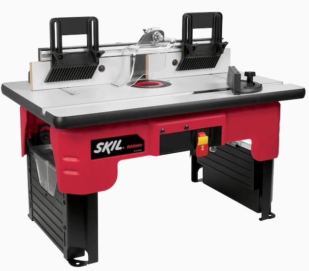

Gary I'm afraid my setup is laughable compared to professional woodworking standards. My shop area is in a bit of an upheaval right now but this should give you an idea. I'm using this silly little table with a DeWalt 616 router installed. The 1/2 " acrylic pieces I've made so far are one 5x5 in square and four 5.5 x 14 in pieces. I held them directly when cutting them down with the pattern and the table was 'heavy' enough that it didn't move. I'll end up screwing it down like I said but now that I think about it there's enough wonkyness in the table itself that securing the questionable legs probably won't do much for the small ripples I've been seeing.

Now lets back up here abit. You said you are doing patterns. This means you are attaching a pattern on top of blank and now using a straight cutting bit with bearing to follow the pattern. You do not want to have to cut too much material this way so you should cut the blank very close to size before routing. You do not use the fence with this. You use a starters pin and route more or less freehand. But you need to be sure that pattern is adhered to the blank well because if it slips all hell breaks loose.
But I will take this to other levels. If these molds are square then why not cut with a tablesaw and be done with it. With the right blade you will get mirror like edges.
Then another thought is why not use the fence and run the pieces past a fixed bit for a clean pass. I would work other things out. Have no idea what you are doing now so all bets are off.

Actually using the fence and a fixed bit? is what I've been doing, I think. Router is mounted upside down in the table so I guess that's fixed.
It might help slightly if the table legs are under tension? By that I mean push them out slightly at the base then screw down so the top it " stretched " for want of a better way of putting it. this might address any end to end or side to side wobble a bit.

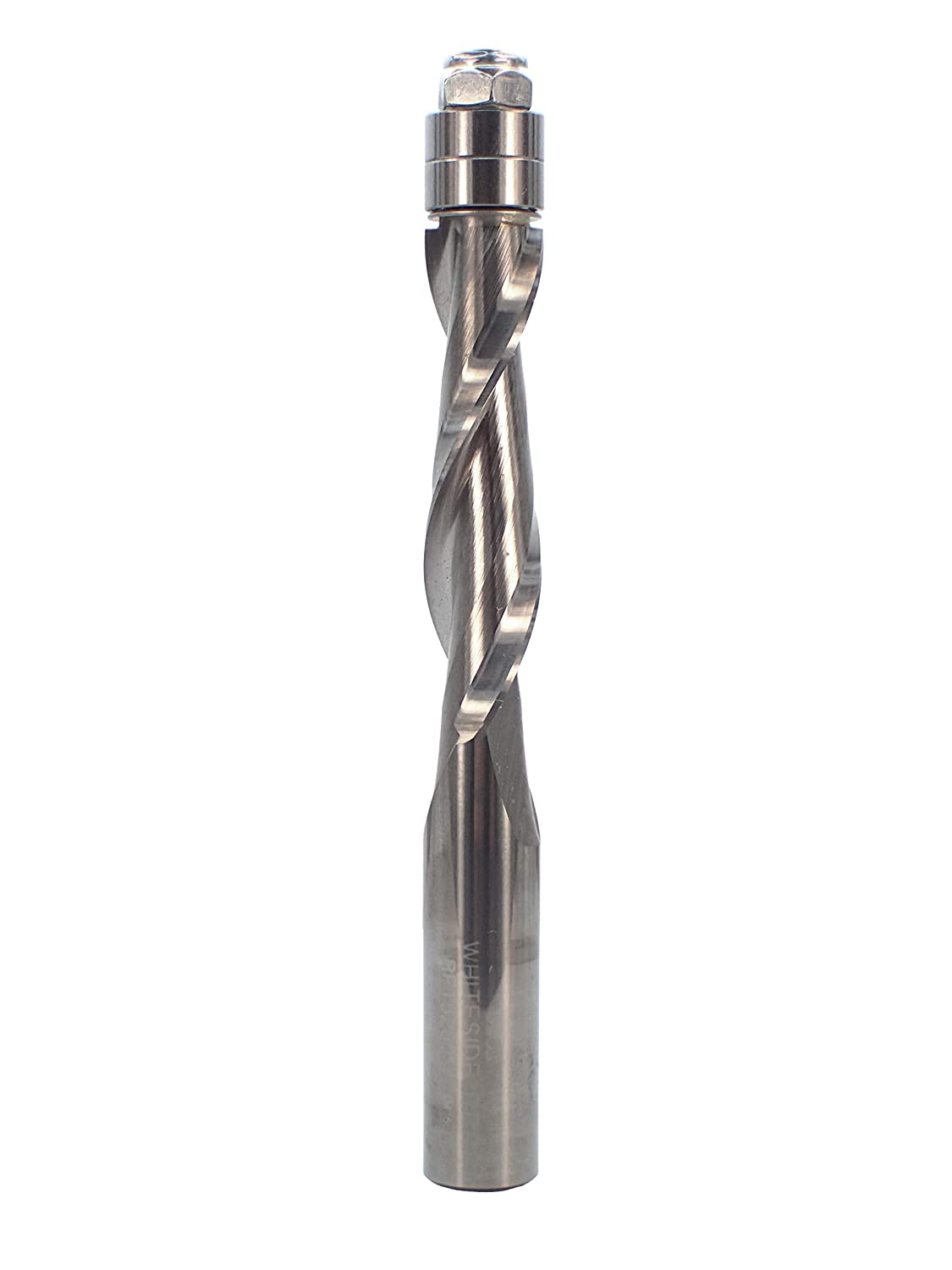

Update. I've had a lot of suggestions for a O flute upcut bit but despite all my search I don't believe there's one of these made that's designed to be a trim bit, with a guide bearing. All of them I found were meant for CNC.
The closest kind of bit I can find to what's been suggested is something like the Whiteside RS5200 1/2" shank 1/2" bearing 2" cutting surface length. If a O flute upcut can't be found would this do it?...
Not needed. Your ripple effect thing is a product of operator error. If you are trying to cut all in one pass you are asking for an accident. A router is actually a more dangerous tool than a tablesaw and yet people do not see it. This is because more people use tablesaws than routers. This is hard for me to explain because I know what I am doing and I can answer my own mistakes right away. But without knowing what you are doing it is so hard to help by typed words. That router table is not a bad one. Just needs to be nailed down and if you have to splay the legs some to take the slop out of it then try that. But when you push your work past that bit that table or the bench it is mounted to should be rock solid. Takes one potential hazard out of the equation. Next is if using a pattern then you need a starter pin and not use the fence. You take small bits off till you get to about 1/64" left and that will be your final pass. You run this through without stopping and if you need to to adjust hands then step back again and run again. If your pattern has no bumps in it then the cut should be smooth. A good sharp bit will cut through plastic easily.
You can use either a top bearing or a bottom bearing flush trimming router bit. As I said I prefer 1/2" shank because it takes out the vibration when routing hard materials. I prefer Freud or Whiteside bits and they can be found from many sources. Not much more I can tell you. Maybe someone else has more. Good luck.
