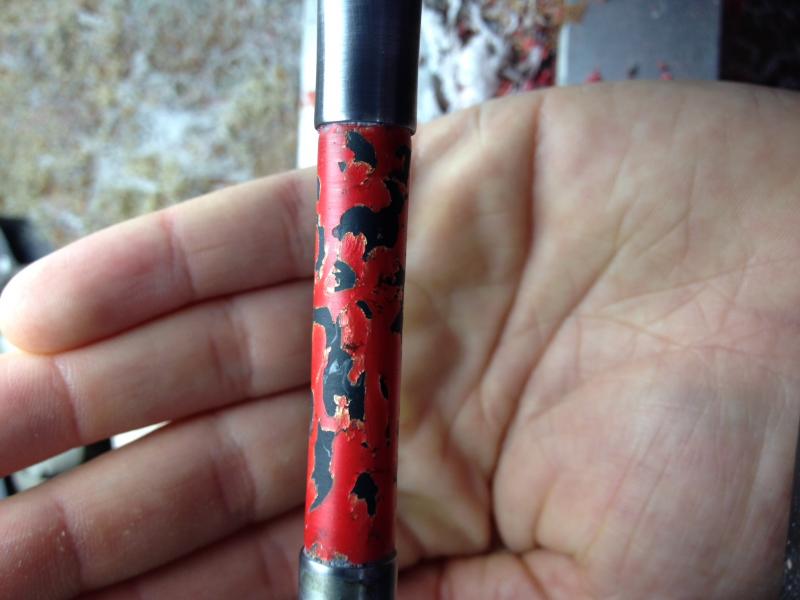

Replicating urushi
I've been playing around with several different methods and even though I still have to refine the process.....I think I'm on to something :biggrin::biggrin::biggrin::biggrin:
Not bad....but it's looking quite deliberate and hurried. Urushi is neither.
I guess it depends what you do with it after this point but I would say thin layers of paint...sand back till the highspots just barely show and repeat many times until all the low spots are level with the red. Togidashi is a very delicate and time consuming process.
That said.... It's great that you are going hard on this. Awesome enthusiasm. :smile::smile:
I agree. I have a LONG ways to go but the purpose was to narrow down the right material and methods that would get me in the ballpark lol. In all honesty this is my 15th attempt to get the method somewhat close but I'm making progress. (The blank in the picture took several days to make)
The pen is actually smooth but I'm going to be working on finessing the bump layer and highlight layer so it can replicate the smooth and natural effect/figure of true shibo urushi. But I'm happy with being able to apply the methods with different materials. (Hardest part is finding materials that work with one another :tongue:)
Thanks for the support!
Ooops.....sorry, In that pic the red looks like it is flaking off and not smooth.
15 attempts ....that's pretty good. You'd probably be looking at 15 attempts with real urushi before getting it close and it wouldn't be two days...more like two months between attempts. To do this without urushi or Cashew would have me scratching my head. Very cool and looking forward to seeing #16,,,17...18...and...:biggrin:
I personally don't think you will be able to replicate Urushi easily outside of lacquer itself. If it could be done, it probably would have been done. I may be a little too particular, but that is my background from Japan. They are very disciplined in this area. Western minds want to speed up the process! :wink:
"Japan dryers" are metalic additives (a thinner of sorts) that go into US/Euro lacquers that help it cure at a different rate and then give supposedly similar properties of Japanese lacquer. The Urushi effect takes place with layers and layers and each being "cured" before adding the other layers. Drying to touch and even light sanding takes 2 to 4 hours, but real "curing" takes days to months between layers.

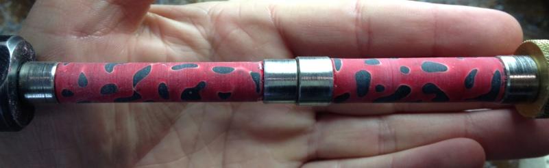

#16 making progress
AND here's #16. I have to say this is the most fun I've had making blanks. I really enjoy the whole process and the fun of seeing the design evolve. Comments and critiques are welcome.
It appears you are on your way, and as the others have said there is a different standard on time and the steps involved. Looking good you are doing nice work.
Hey, #16 is looking pretty good. Different than urushi but in a good way. I would like to see one of these finished.
