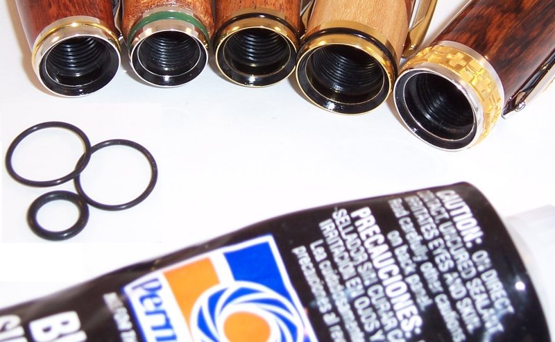

First, below is one of the original photos I posted showing the little silicone rings I made. I probably mentioned somewhere that it probably doesn't matter what brand of adhesive you use BUT in another thread it appears that some are having problems with their little seals falling out so I want to add the following.
"Silicones" may vary from brand to brand and I only tried the black "Permatex" sealant and one of the pens I made a seal for is one that I use on a regular basis and it is still intact after 1 1/2 years. It's probably been opened and closed 6,317 times since the seal was made and it still holds the cap on snugly.
The only thing I can say is that I have done this little modification to well over 100 pens and I haven't heard back from anyone about their seal coming loose or falling out so I can only ASSUME that the seals are all still working.

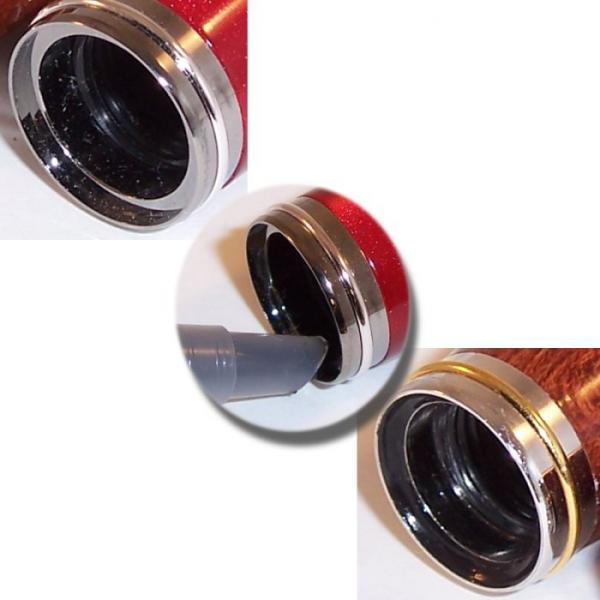

I dug up another photo showing me applying the sealant. Notice that this was before scratching the inside with a burr. I cleaned the part with alcohol then put a thin bead directly from the tube where I cut as small a hole as possible.
After applying the sealant I wet my finger with good ole saliva THEN when the bead was smooth, I would take a Q-tip and run around the inner edge to pick up any excess sealant.
After a while I found that a thinner bead (shown) worked just as well as a thicker bead and wonder if the thicker bead may be the cause of failures reported by some.
Haven't had any issues with the plating flaking off. The burrs I use are REAL tiny and I don't get anywhere near any edge that would not be covered with sealant.
