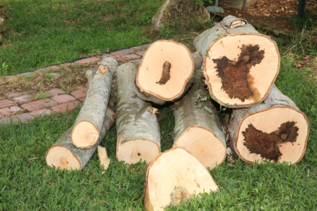

Hopefully, this is write forum for my question; I have just scored some nice maple from a tree a neighbor just cut down (with my help I get the large trunk). The pieces are from 24" in diameter down to about 6" in diameter. My son is experimenting with fresh cut wood also and says that I should paint it as soon as possible. Is that best? I can paint it this afternoon.
Help!!
I think cutting the pith out is the best way (pith is the center core) After that anchorseal, wax and paint seem to be good options from all I've read. I just recently cut up some ambrosia maple and flame box elder and I used white acrylic paint because I had a gallon of it. Just bought a quart of wood sealer to try on some before long to try to compare results.

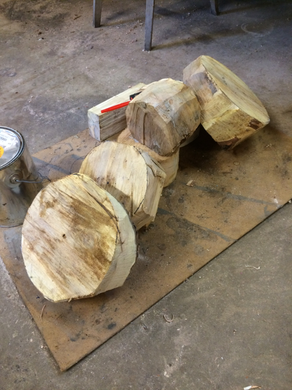

I've got some sealed blanks I need to turn this week.

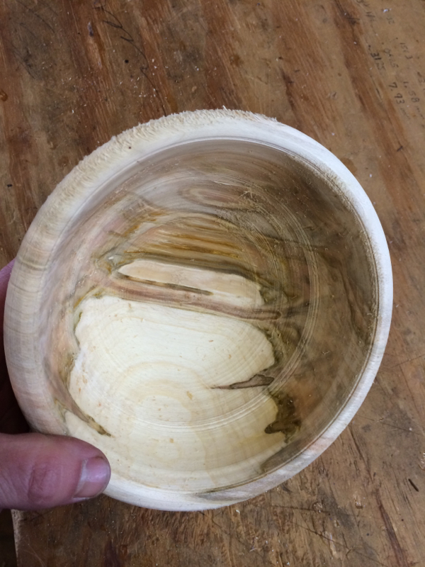

A picture now
Thanks for the ideas, I will see what I have. But, a few questions more please. What is Anchor Seal?? How do I cut the pith out? I have a picture attached. If I cut the pith out, do I lose the dark, heartwood spalting??? I wanted the color; I think that it will look really interesting.

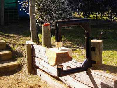

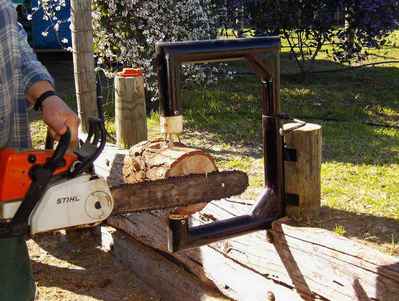

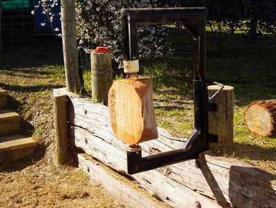

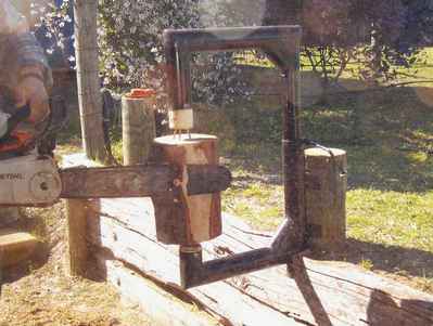

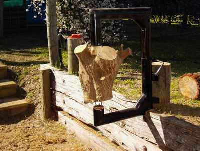

I have invented a log holder make out of round metal tubing that is one of the best things that I ever created, this log vice type thing has been displayed on my old web site for years but last week I started upgrading the site and all the pics from the old site didn't transfer to the new site so, I have to find them all again and bring them back so that people can see it again so, no good for me to give you the link as the pics aren't there yet...!
In the meantime I leave you with a few of pics from that log vice so that you have an idea of what I'm talking about...!
Good luck with it...!:wink:

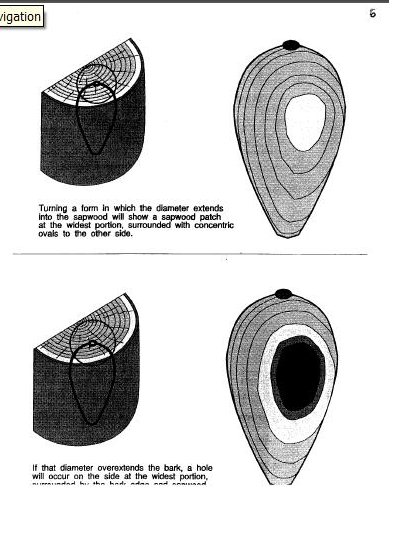

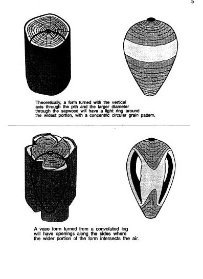

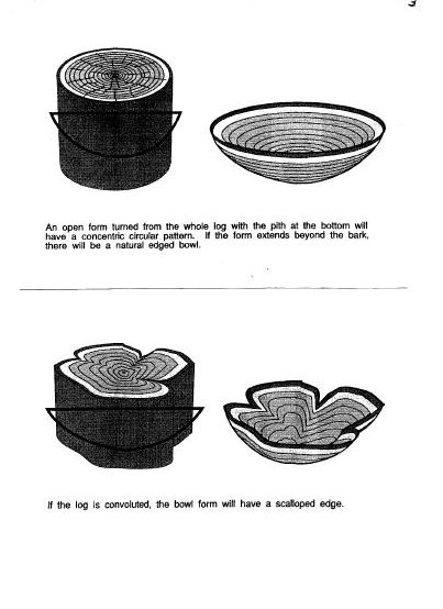

Sure, nothing stops you to cut a length piece (log) of a tree and turn it in between centres or mount it in a plate through the end grain however, with wood turning, there are certain "rules" that are there for a purpose and while you have yet to get the experience, you will see why those rules are there, believe me, they are there for a reason.
Apart from the fact that, some woods would easily (explode/disintegrate) if you try to turn them the way you are thinking about, you have to consider how you want the wood grain to show on your finished piece.
Issue -2

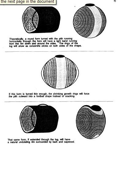

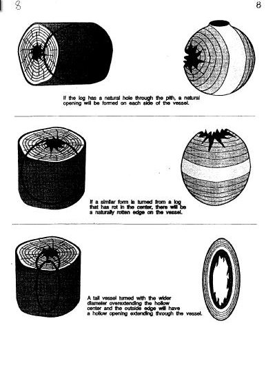

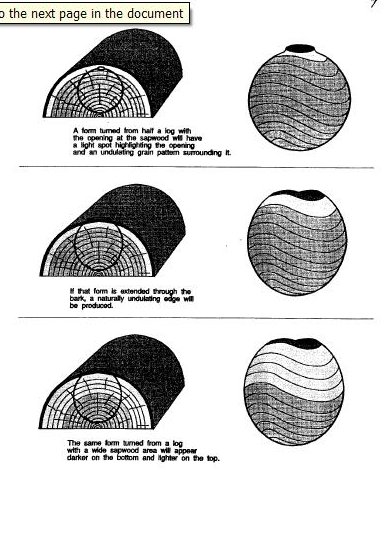

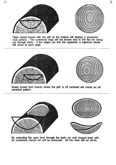

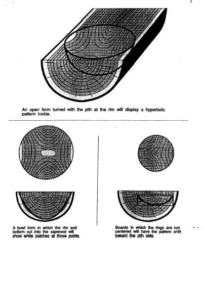

I have a series of pics that will answer all your questions on this matter, you can call if the "Woodturners Bible" or anything else you want, I reckon, if you can't get your wood cut right, you may consider so other hobby...!:eek::wink::biggrin:
Have a look and let me know if this is of some help to you, as I know some folks here, will think that Santa come early...!
:smile::biggrin:
Cheers
George

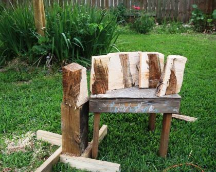

Thanks everyone!! Based on the comments I made a sawbuck for cutting and a support bracket for final trimming. I will work on finishing the rough cutting this morning and seal.
But, George, the drawings of the wood grain and bowl blanks are fantastic!!
I am printing them now and will use them; but, where did they come from??
A book I anticipate - name please??
Now we need to learn to turn bowls.

Hi peoples,
The pics I provided are part of a PDF file that I discover in the days I was a member with the Australian Woodworkers forum years ago, I don't recall who wrote it or how exactly I got a copy, I reckon it was passed on by another turner in that forum, I take no credit for that PDF file, I already had my drawings/notes of how to do many of those cuts but, that document was well made and very clear on what to do so, I have passed it on to many other folks that I saw, could put it to good use.
As for general Bowl turning or, getting things done from wood logs into finished pieces, there is a mountain of info out there, including YouTube videos that are, in my opinion, a great way of learning in real time...!
I myself wrote dozens and dozens of pages on the subject, throughout the web forums I have been part off, all scattered I know, I may one day look for all that info and transfer it to my new website that is a lot more than a webstore, I have had plenty of information for turners in there, since the day I started it all and under a new name/address "Timberssoul".
So, the best way to learn is to find a woodturning club near you and join in, the older master in any club will put you up to speed in no time. The other option is to find someone near you (driving distance) that does that sort of turnings and request some help, you will find that, most of us like to help and teach others what we learnt.
