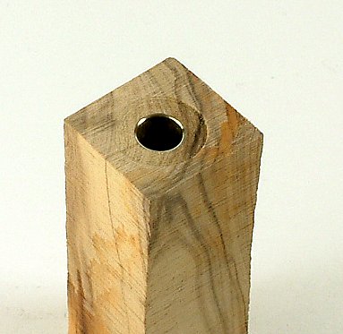

That is some serious fire power to put components together. I would not use something like that but if you are going to I am sure you have read it many times here, make sure the tubes are cleaned and it is a good idea to file them so that the parts slide together more easily. I also taper the ends of the tubes with a reamer. Just have to watch as you press them in. No scientific method. Your eye can see problems very easily. Have the press at eye level.

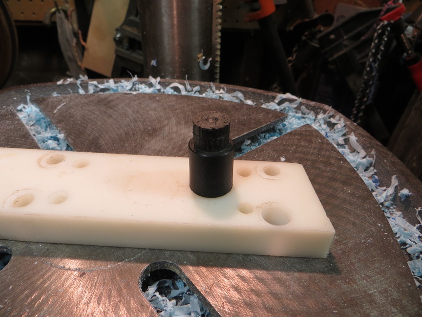

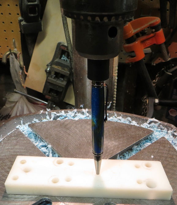

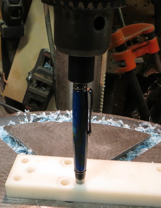

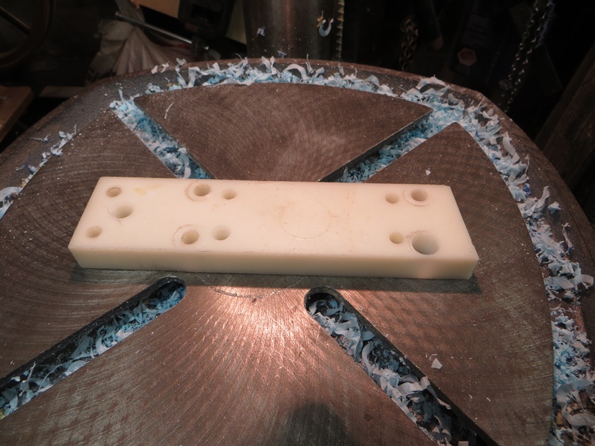

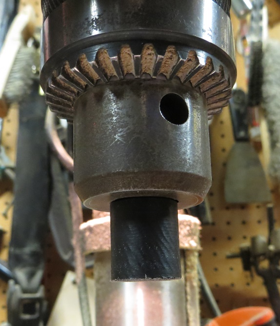

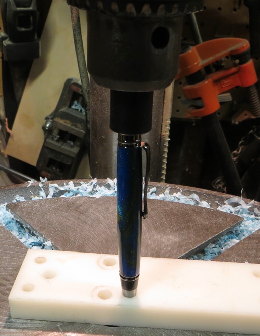

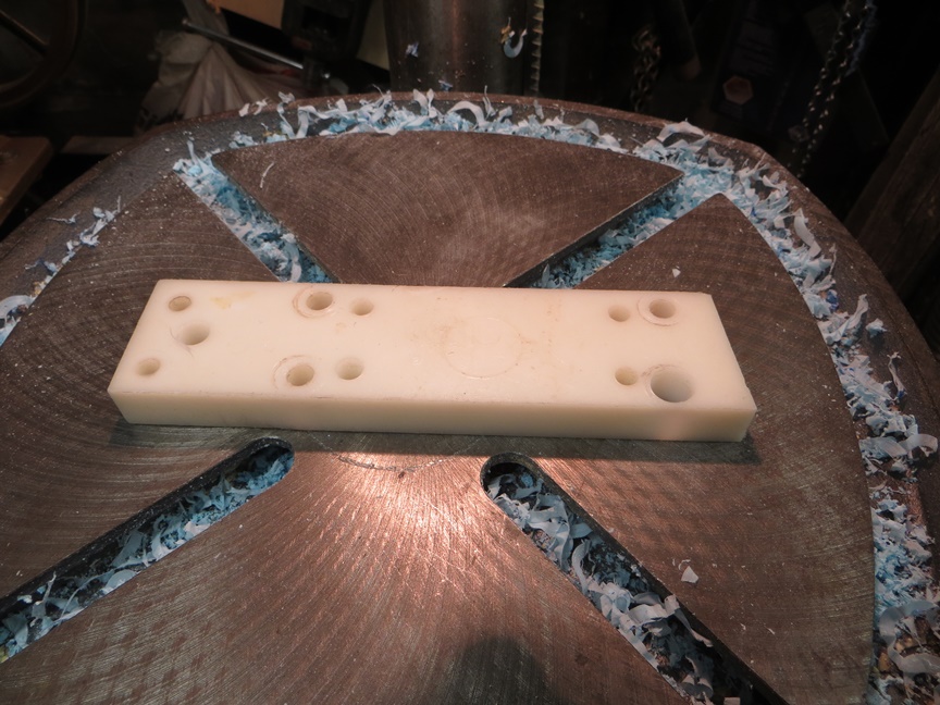

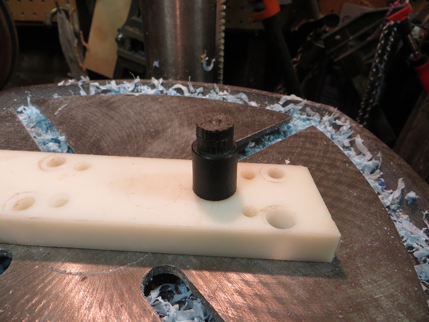

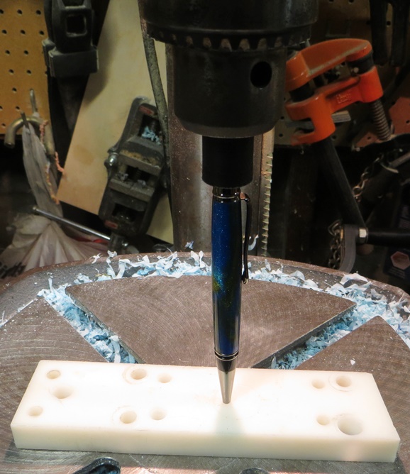

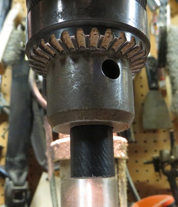

I use my drill press (with it turned off, of course). It's easy to control, and doesn't have too much force. I have some soft plastic press blocks I made (UHMW and Delrin), but you could probably use hardwood. I've been assembling pens this way for over 15 years, and it hasn't let me down.

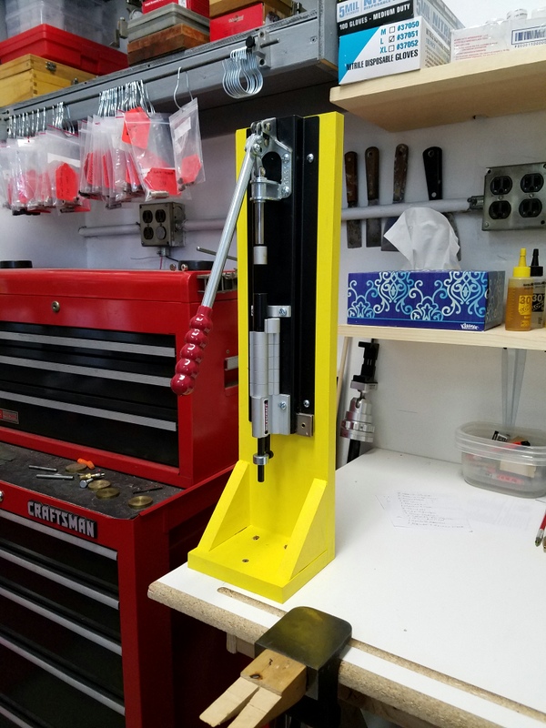

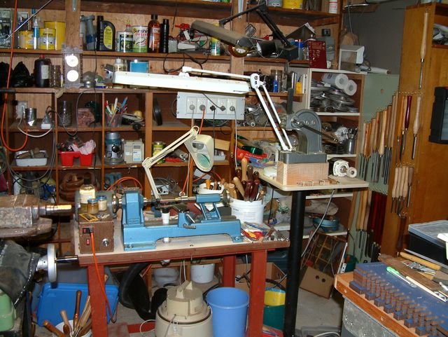

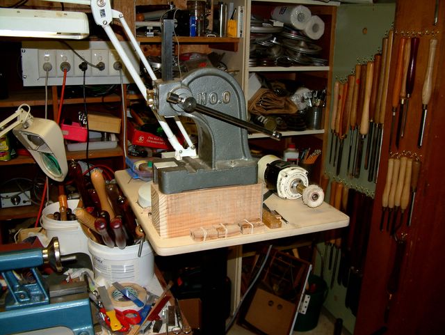

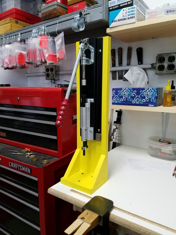

I use a similar press two things I always do is I clean out the brass with a step drill that is a close fit then using a tapered reamer i ream the lip of the brass and in a touch which gives me a slight lead in with the tip. First press gentle then turn the piece realign if necessary .
Also when I scratch the brass I use a close fit holder if the brass is too tight I chuck it another source of splits when assembling.

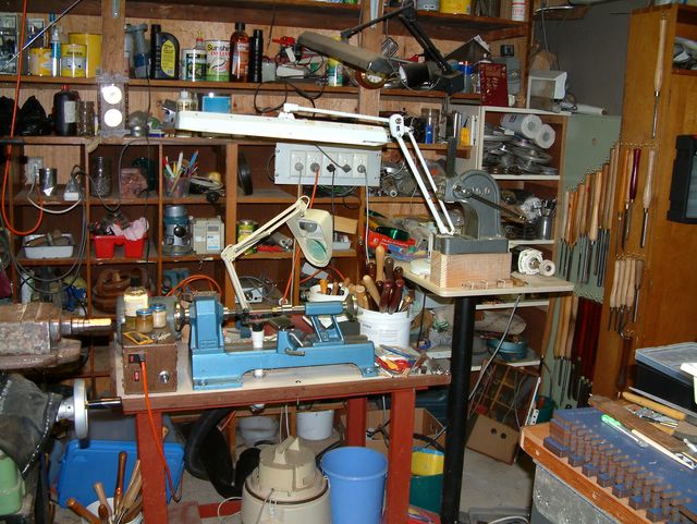

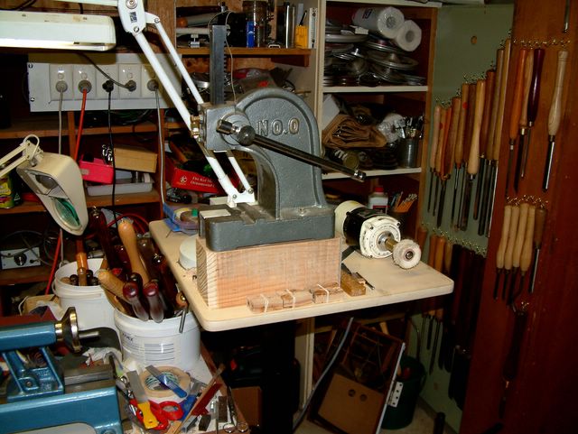

Peter. PS I love my bearing press I mounted it adjacent to the lathe and at eye height for me seated I sit turning on a draughtsmans swivel seat I might have a pic if so I will add it.
Peter.
My Pen press and for longer pens on the bench behind me the other one.
Peter.

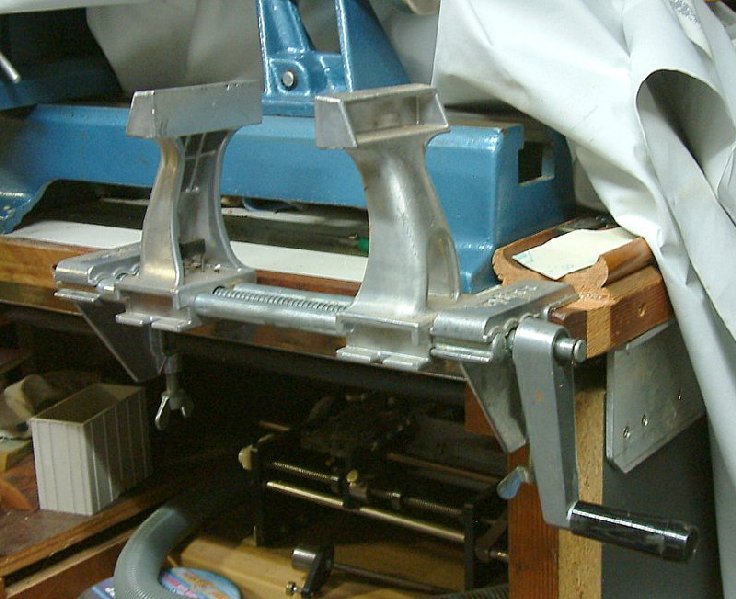

Yep, that's the one that I am using. But I have the handle locked in the middle position, rather than at the end the way you have it shown. There's actually not that much force on the pen parts. It seemed like the vise exerted more force.

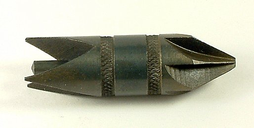

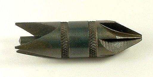

Mike; You can find a chamfering tool here, or check with your local gun shop. They are used by reloaders.
Chamfering Tool: Arizona Silhouette
Some chamfering tools are double ended. On end has the reamer, the other end has a burr remover (looks like arrow feathers) for trimming the ends of home cut tubes.

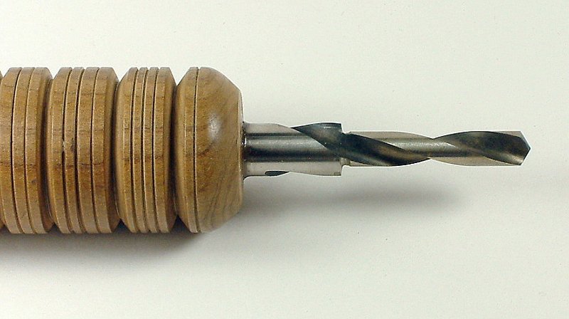

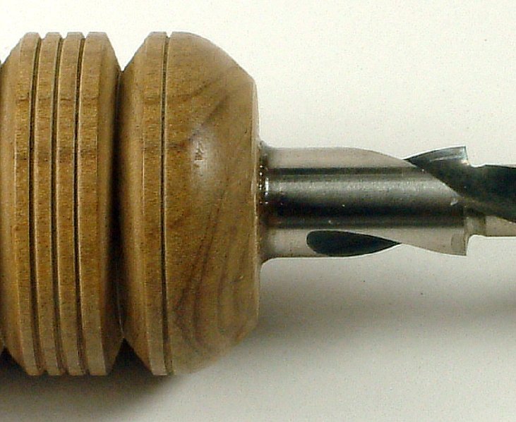

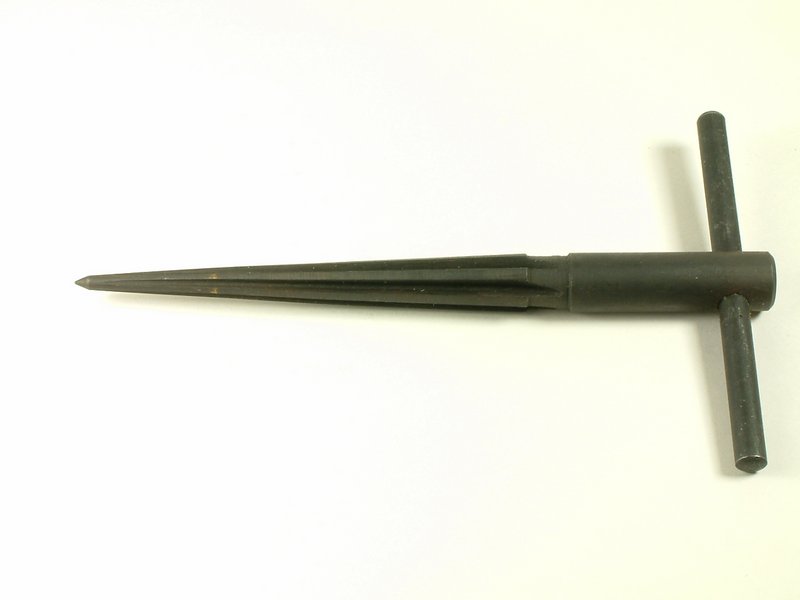

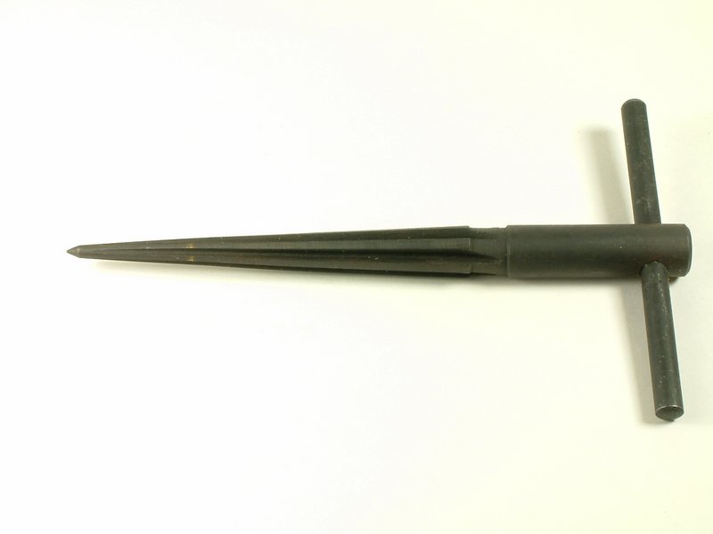

Mike, I find it very useful to own a set of adjustable reamers. You can buy them at Grizzly, Harbor Freight, and other places. Here is a pic.

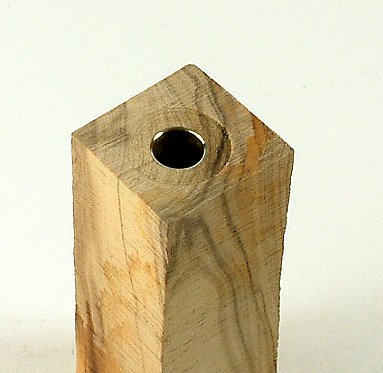

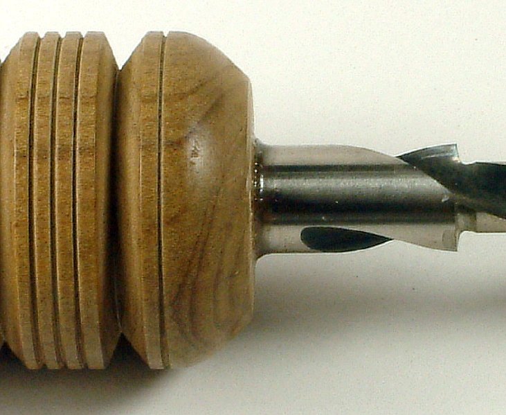

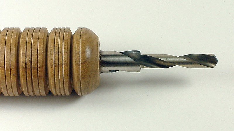

Pics of my Step Drill a snug fit cleans the inside brass champhers the entry, a stubby gun brass reamer (inside and outside) the long tapered cheap taper reamer all useful for 7mm. You cannot buy the step drill mores the pity.
Peter.
