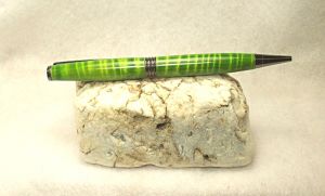

There is a gel food coloring that is inexpensive. Sugarcraft makes it. I have dyed curly Maple with a variety of colors. Turn the blank and finish sand. Apply the gel with a paper towel as the lathe is running. I apply CA over the top in 7 coats so as not to sand into the dye.

Greenmtnguy, that pen is awesome looking. I want to thank you all for your comments and help. I have picked up a ton of ideas from you all and now I can't wait to get back home to get to work on the blank. I did look this afternoon at a local store for a burgundy Rite dye and they had one that looks really close to the color I want. I'll share the results with all if I'm successful. If I'm not, then I'll slink off into the snowy Montana mountains in shame! *LOL*
