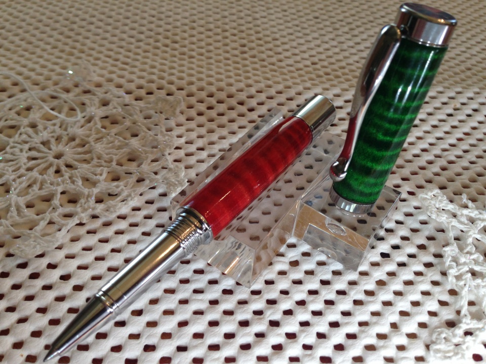

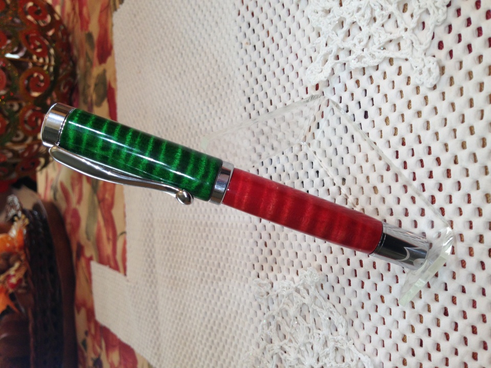

I've had good luck with food coloring on a pen that has been turned to size.
Made this one for Christmas last year with red and green food coloring.
