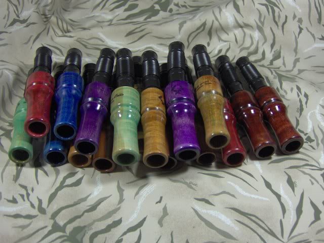

Another option that is cheap to experiment with is Vitamix Bird Toy Dye. Buy the sample pack and a cheap maple board and play for weeks. https://www.mightybirdtoys.com/home.php?cat=281 These calls are plain maple, no figure at all. They were turned, and dipped into the bird toy dye.

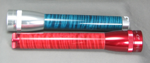

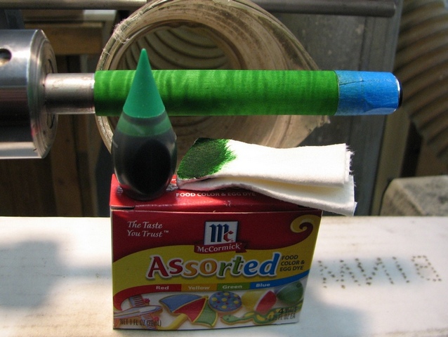

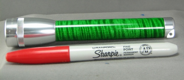

McCormicks food coloring!!! Be sure to get the kind without sugar.
McCormicks food coloring!!! Be sure to get the kind without sugar.View attachment 221101View attachment 221102View attachment 221103
I have used food coloring for years. I was concerned that the color might not last, but I have some that are almost ten years old and still brilliant. You can go on one of the suppliers to cake decorators and get an amazing range of colors. I bought a number of them to make pens for college students with their school colors. Its been years since I bought them, so I don't have the name of the company. I just googled cake decorating supplies, if I remember correctly. Got maroon and gold to make ASU pens and they turned out great.
