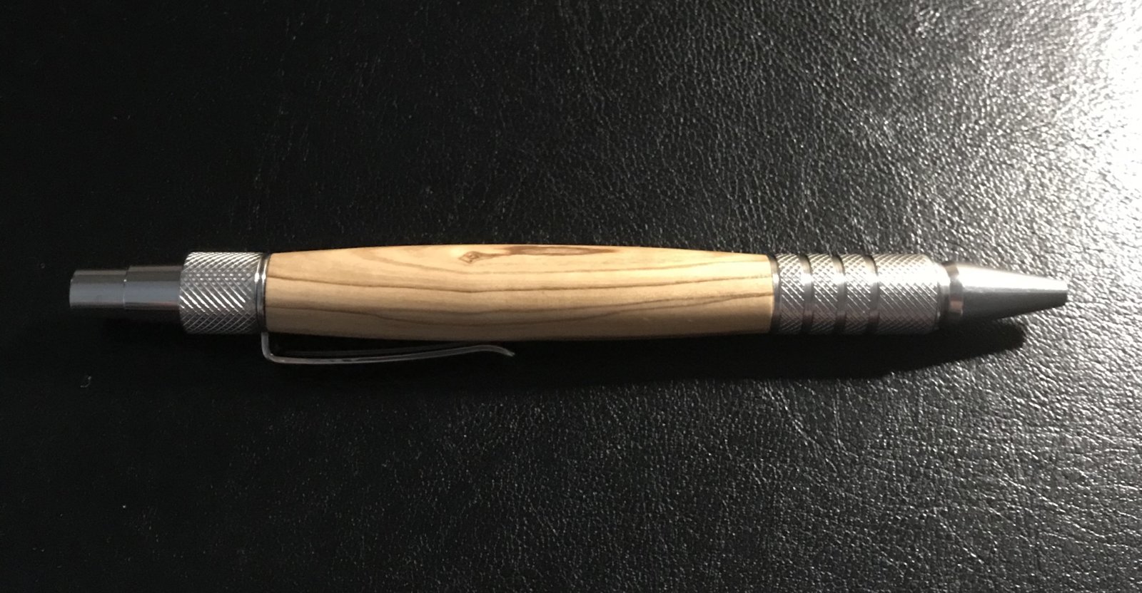

Being a new pen turner, one of the problems I've been having is determining which profile to use for a particular pen.
The advice I've seen is to pretty much never use a flat profile where the entire length of the blank is turned down to the bushings. However (and maybe it's just because I haven't yet developed a very critical eye), seems to me this conveys more of a modern look which I'd prefer for my everyday carry pen.

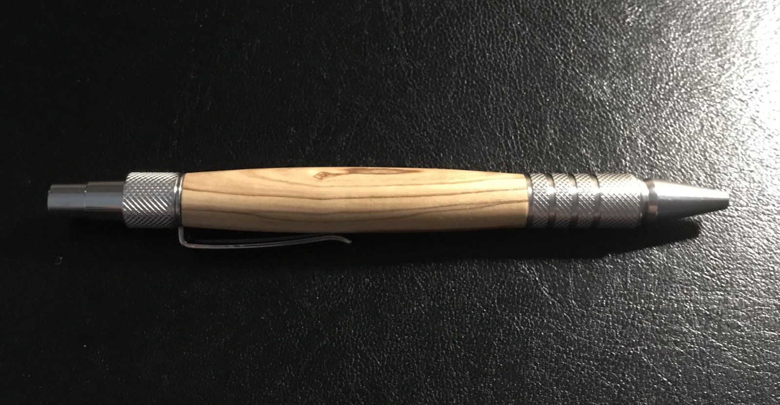

Exhibit A is this PSI EDC pen I turned over the weekend. While it actually feels very comfortable in hand, I'm not that wild about the contoured look.
So my question is, what's your approach to determining which profile to use with a particular pen (and do you even use a flat profile)?
As an aside, any other comments/critiques on what I could improve would be much appreciated!

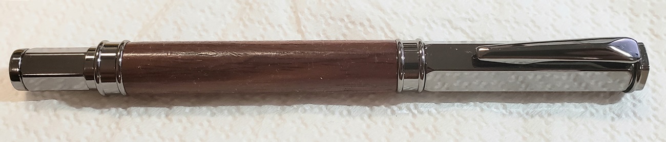

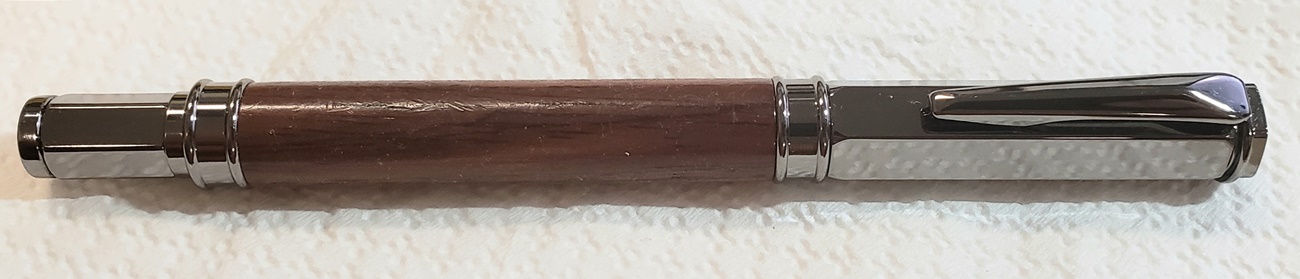

I actually like the shape of your pen. It could maybe be a tiny bit slimmer, but I like it better fat than straight. The vast majority of my pens are fatter in the middle. It's a more pleasing look to me. A notable exception for me would be the magnetic Vertex rollerball and fountain pens. I prefer those with a straight profile.

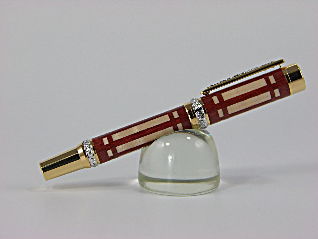

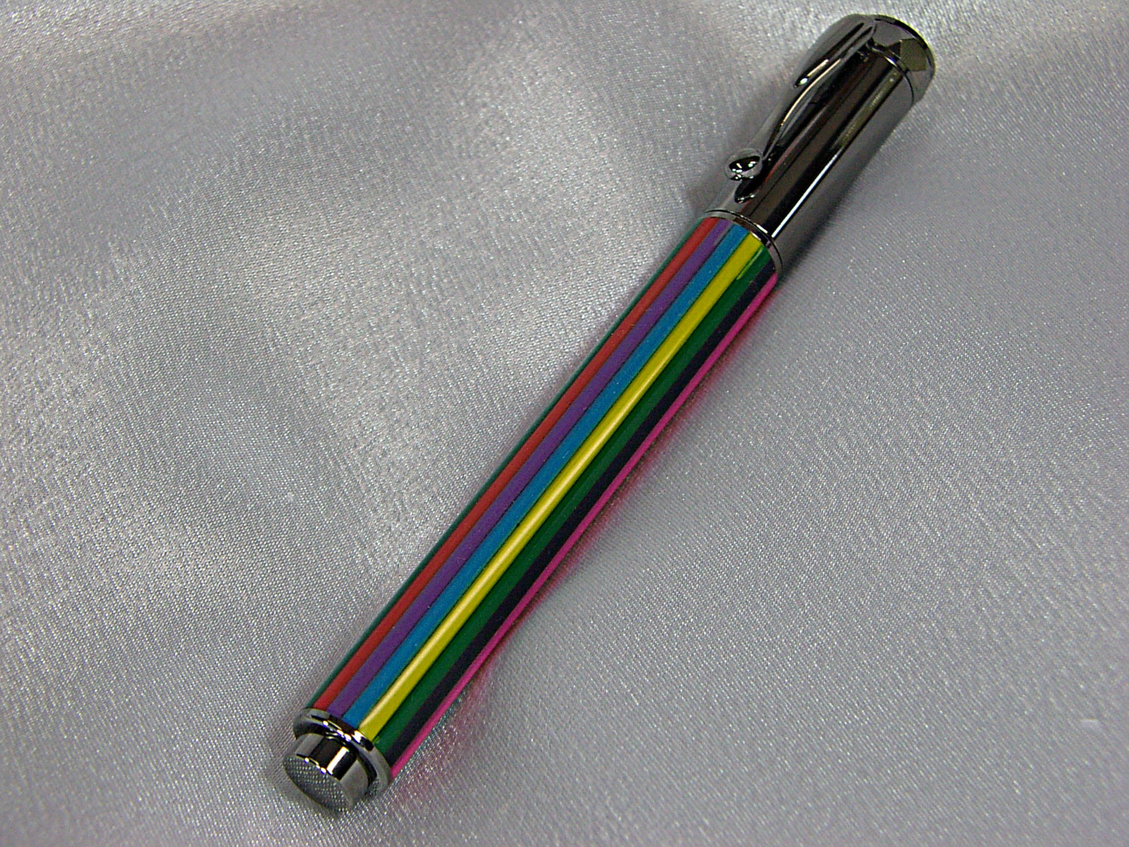

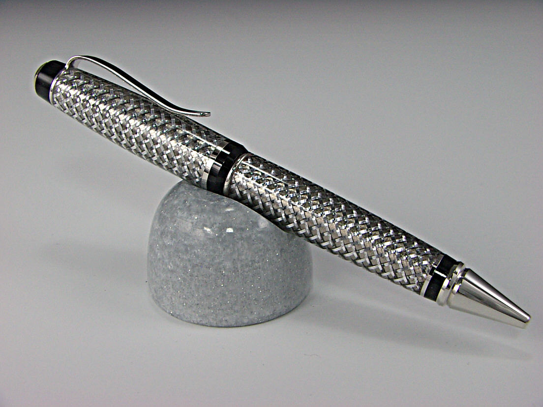

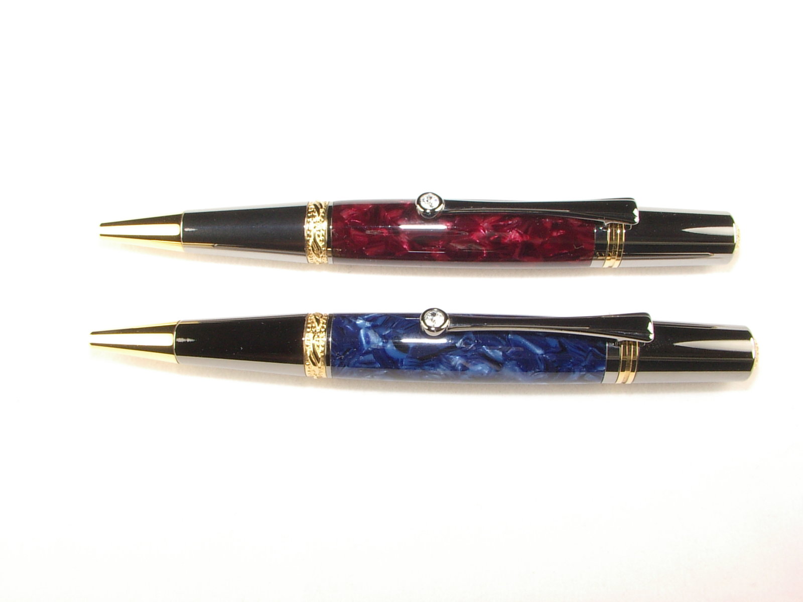

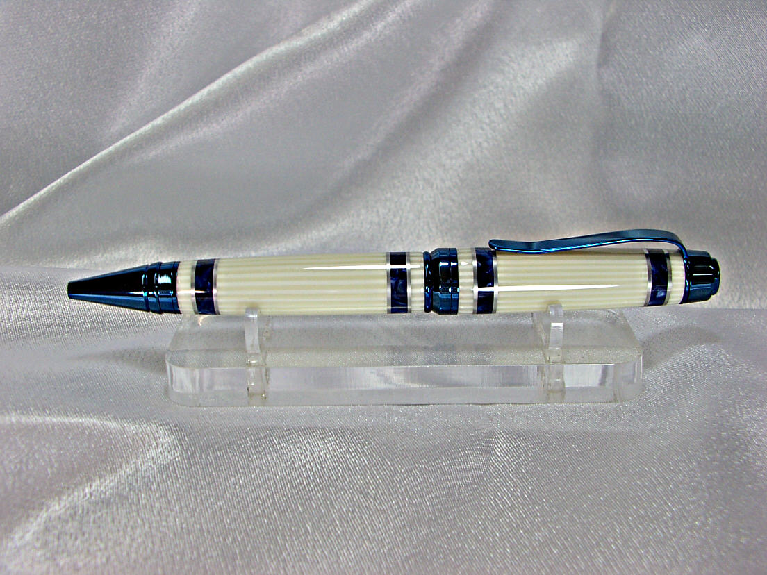

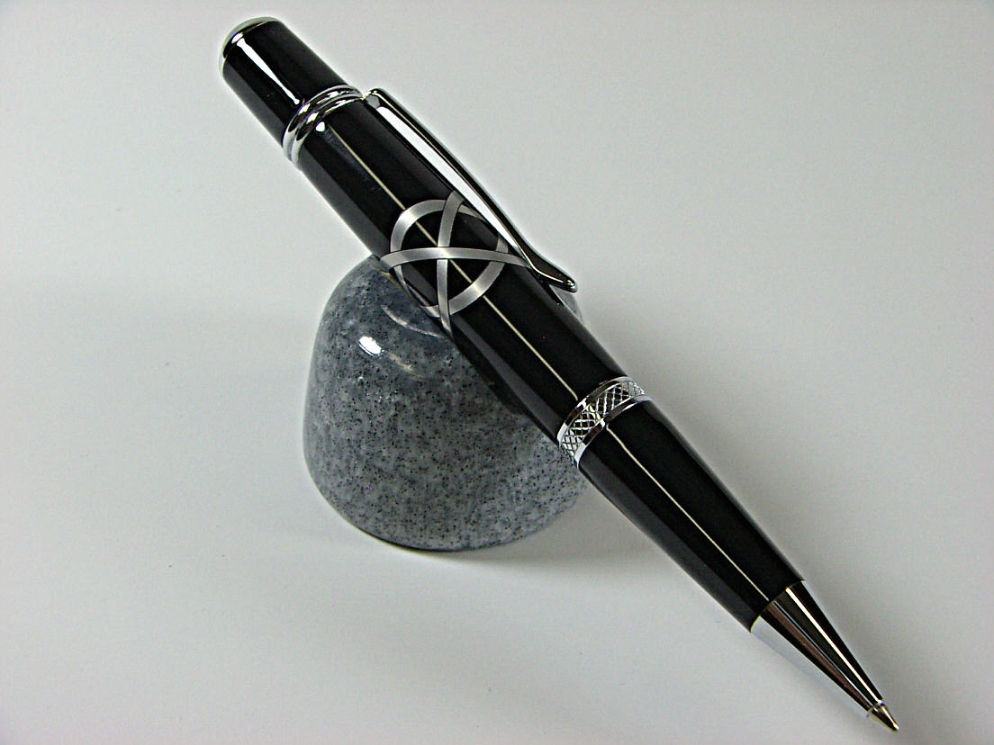

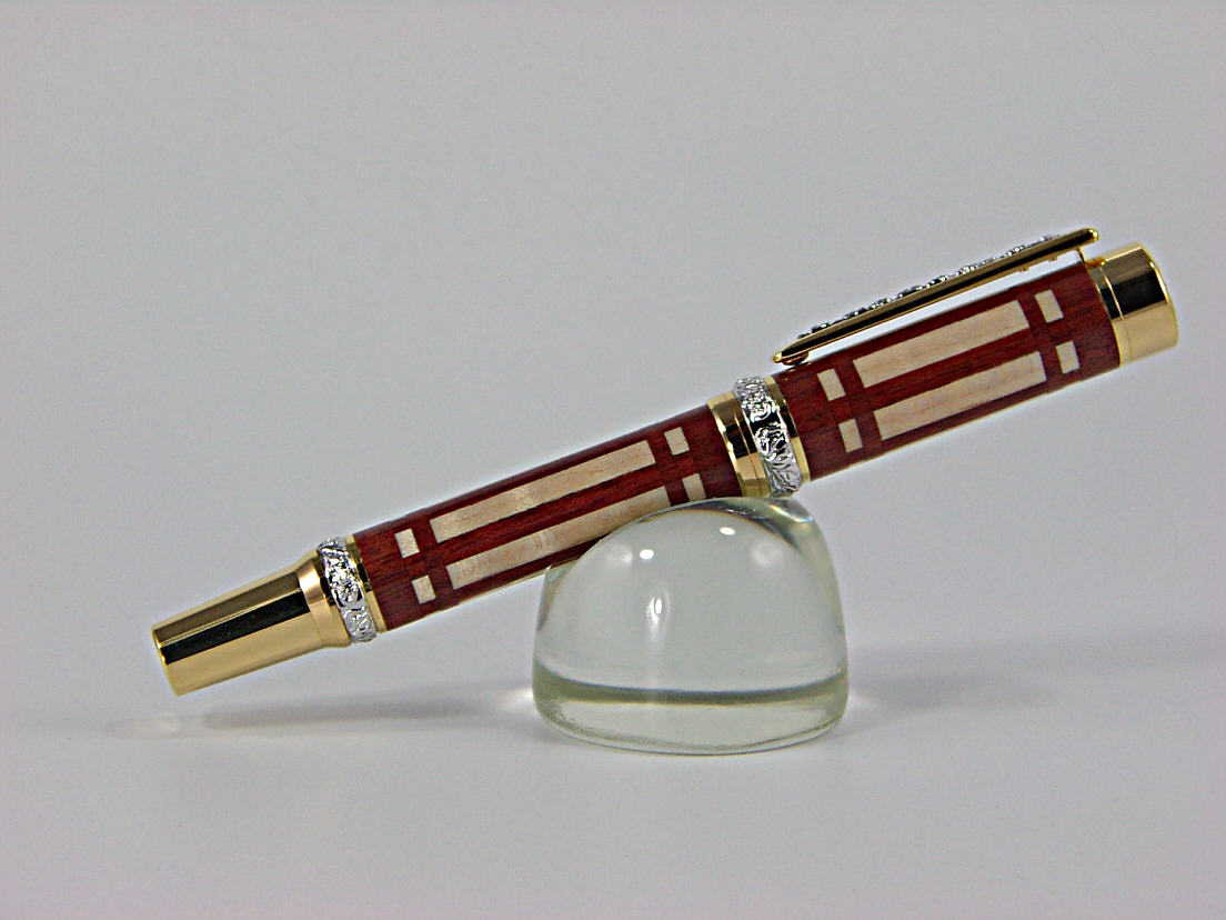

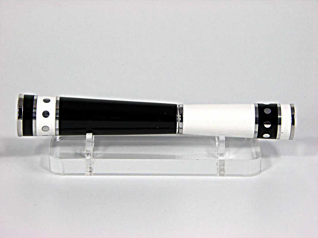

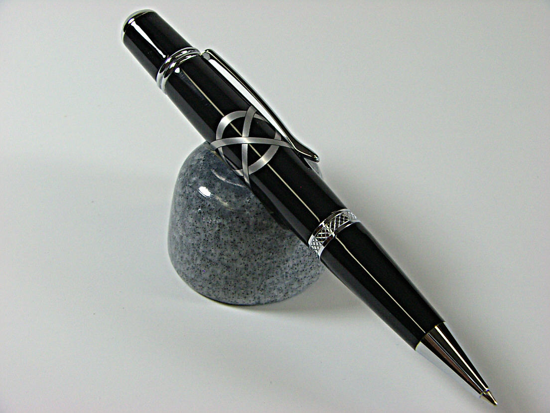

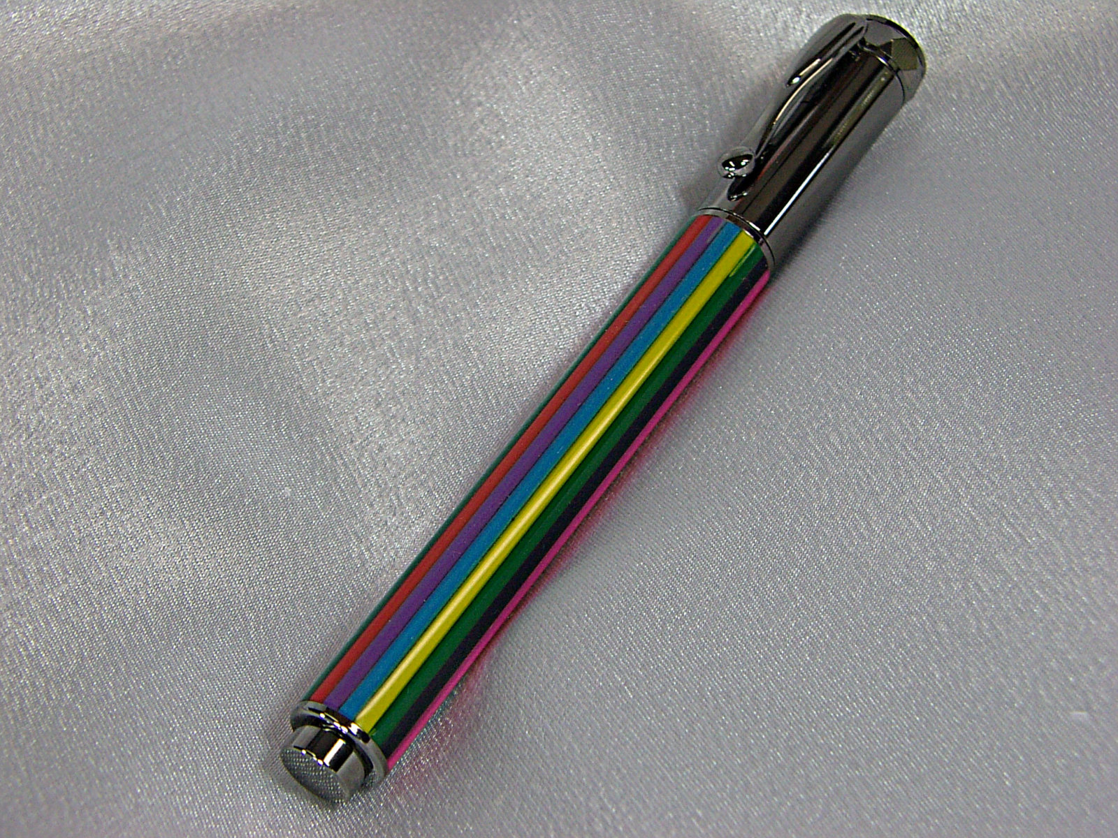

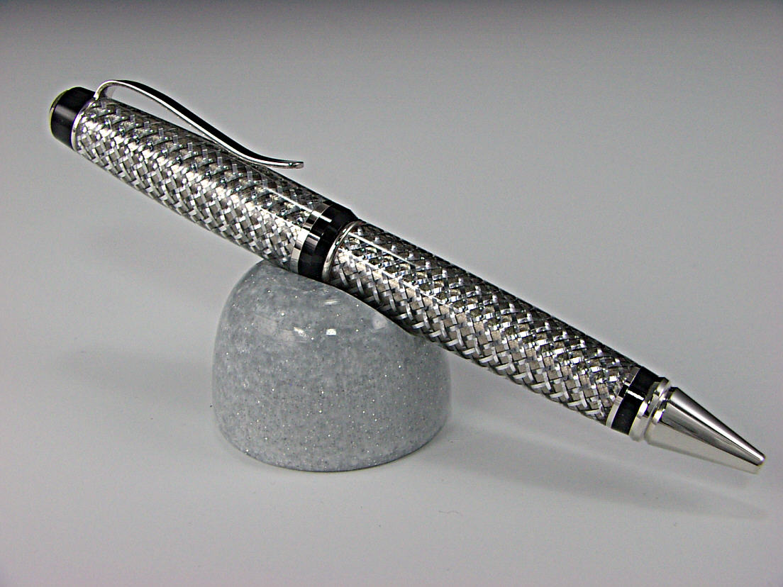

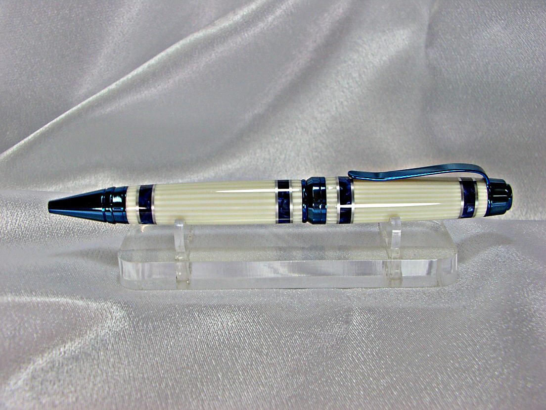

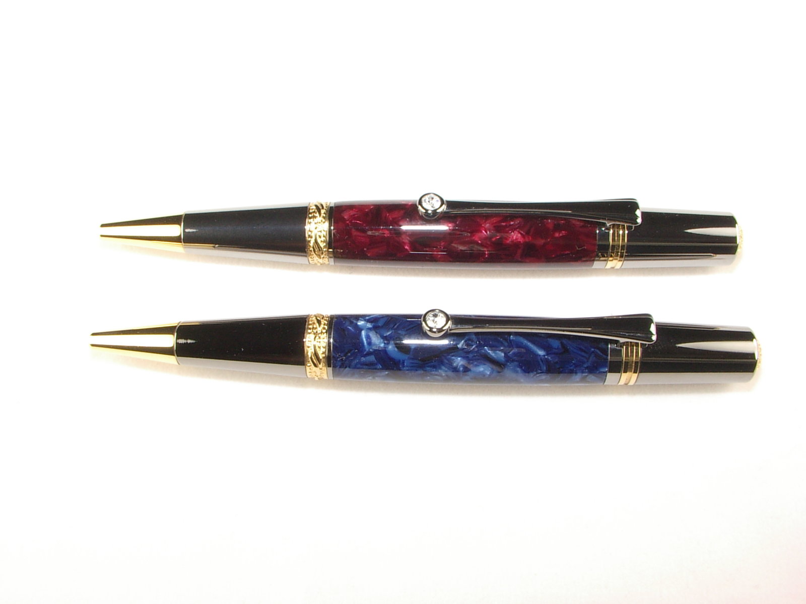

Many times the kit can dictate the shape. I am a bushing to bushing guy except when it come to cigar kits and Sierra kits. With a cigar the bushings are all different sizes so you want to gradually get back to the smaller size and I will put a hump ever so slight, in them. Both bottom and top. The sierra has a natural hump to the kit so I try to follow that without going outside the lines of the component parts. Not sure if you follow but will give examples. Now other kits look much better flat. When people put humps in those type kits they are trying to hard to make their work stand out. Let the kit and blank do the talking not your fancy hoops and valleys. Do that on a stick and show it off. Take a good look at all the top name pens and you will never see bulbous looking blanks. Yes they get gaudy but that is carving and stuff. I hear sooooooooooooo many time here about elderly wanting bulbous pens but that is just an excuse. yes maybe one or two may want that. You see so many slimlines here with pregnant blanks that I do not even look any more and comment. Those are beginners that do not know how to get to a good shape yet so I excuse that. But when a veteran turner does that for looks I do not buy it. Want to improve then it is easy to do so and you asking this question is a true sign you do want to and will.
