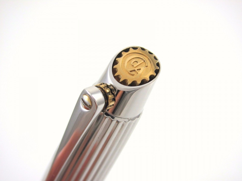

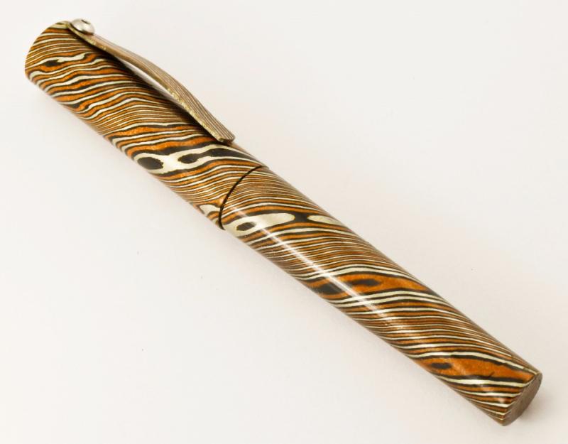

How about this method of attaching the clip, seems rather difficult to make. How would one go about attaching a pen clip like this on an ebonite or silver pen?
Ok, Carandacher.....or whatever your real name is...please don't be offended but are you just going to post pics of other people's pens and ask how each one is attached?
You really need to just think about them and have a go. :wink:
The 2nd pen you show is referred to as a hidden clip. There is at least 1 example in the library section of this forum that shows a method of doing this.
At the top center of the forum, you'll see some blue squares. One says "Library". There is a section called "Techniques". In that section there is one called "Hidden clips using a dremel", and another called "Invisible Clips".
You're new here, and when I was new to the forum, I read nearly every article in the library that I thought I might ever want to try. And I go back all the time & read them again when I'm wanting to try something new.
