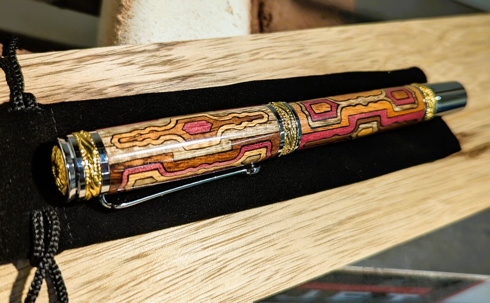

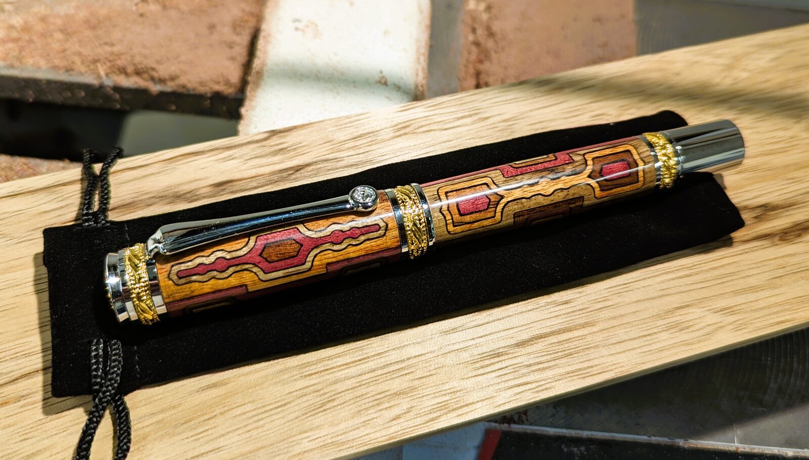

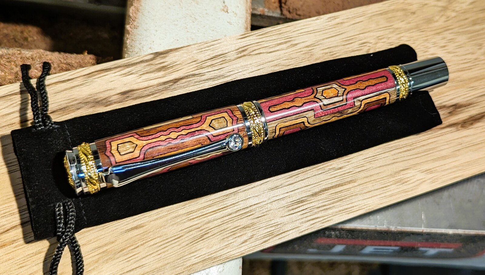

Just finished another segmented rollerball pen, using my laser for cutting the components. I don't know, maybe it's too busy? Too many woods? I used Hawaiian Koa, Black Limba, Purpleheart and Canarywood. I'm on the fence with this one... It's very similar to one I posted in the blank making / segmenting forum, but I added a species and a few little round bits.

That's freaking great work. Nice job.
In response to your question, I'll plug in with my opinion for the extremely limited value it provides as it's an opinion and not based in any fact. I prefer pens to have a design that I can see or understand without having to rotate them. The design you're showing for this pen is very visible without having to rotate the pen to see it all. There may be others who have a different opinion. I think it's somewhat in the eye of the beholder.
You're pushing your (our?) craft with designs like this to see what can be done. Have at it.
Very nice. I'll chime in with my opinion as well. I do a lot of image casting. I try to keep the image as visible as possible without rotating to see it. I like the way you kept the patterns on one side. It might be a little busy but not in a bad way. IMHO. You can see what's going on without getting dizzy or holding the pen at different distances to see what's there. With that in mind I'd say colorful instead of busy. I'm not only impressed with your laser work but your creativity as well. Thanks for sharing.
Thank you all for your kind words! The 'opinion' of not having to turn the pen resonates with me, now that you mention it. On the heals of that, the next blank I'm experimenting with is going to be a 'strand' of orange weaving around the purpleheart blank this way and that....😄
As a "segmenter", I love what you have done! I do not find it 'too busy,' although your are pushing the limits 🤣 .
The patterns are excellent and precise, so no issue there. The choice of timbers are great as they contrast nicely to highlight the design. In summary - well done! Thanks for sharing.
Oops! I meant to make a separate post, not to reply to this post.

Really nice. For me... and only my opinion which isn't worth that much. If I'm going to use and fancy kit with lots frills and movement, I will use and less moving pen blank. And vice-versa. Beautiful barrels like that I would have used a simpler kit... Maybe a Jr. Gent? It's kinda like these great slab tables people are making today. Either have the top be the center of attention or the legs. Can't be both.
For what you are doing and the tools you are using it does look good. I will say though the base wood does get lost. I would keep to 2 sides and not 4. It is a small canvas you are working with. Your designs of the curves and boxes works well. Your particular taste and ideas are now starting to show us how you think because just about all your designs have a certain flavor. This is just a matter of perception. I know I tend to have a certain style myself and catch myself every time I design something but we are who we are. Keep up the good work.
I do like it, but agree with the comments around the ornate pen kit with the very detailed blank. I'd tune one or the other down a bit. One thing that I think makes this one work is that the Majestic kit is massive, so in the pen world, it is a large canvas. Nice work. Can't wait to see what you do next.
Don't second guess yourself. Your design work is beautiful and the end result is fantastic. I do, however, agree with PreacherJon that the design of the pen blank is ornate enough that the ornate kit competes with it too much. A simpler kit would work better. I like the addition of another wood in the design. I've never seen anything like these pens, so you are a trailblazer in the field. Congratulations! PS: Don't forget to enter one in the BASH if it's still open.
Wow, thank you all! I now understand why I thought this design might have been too much, it was the kit that pushed it over or just didn't exactly compliment it. I really appreciate all the kind words and insights! Now, I'm going to post my latest (3am rabbit-hole) experiment in the segmenting blank making forum... See what you think, it's a bit of a departure.
I think it's marvelous. You created an Medieval design from your own imagination and took it to a wonderful level of craftsmanship as well. Looks like a pen that a monk in the Escorial would be very proud of!
My reaction is, wow! Very impressive.
Yes, it is busy, but lots of cast blanks are, also.
It reminded me of baroque art where there are lots of visual elements. Some prefer minimalistic blanks and grains, while others prefer lots of wild figure, colors, and patterns.

I think it looks great! You have a well defined pattern with woods the provide enough contrast while complimenting each other at the same time. Your design kind of reminds me of the Gisi designs where the designs have a lot going on, but there is enough order to it that makes the design work. Well done!
