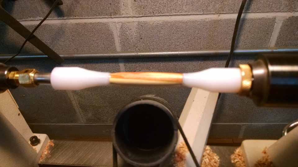

I have several bushing sets but have moved to turning between centers. Quality calipers are one thing needed for TBC. Here is a photo of my setup.

So are those collets used on each end to hold stubs for the nylon bushings/centers?
Simplicity of TBC:
1. Put one of these in the head stock:
http://www.grizzly.com/products/HSS-Lathe-Center-MT2/H5789?utm_campaign=zPage&utm_source=grizzly.com
2. Put one of these in the tail stock:
http://www.grizzly.com/products/Live-Center-MT2/H3408?utm_campaign=zPage&utm_source=grizzly.com
Put your blank (with or without bushings) between them, pull the tail stock up tight and turn.
When new, (unless you are already a proficient turner) it is best to use bushings until it gets round, then take the bushings off and finish turning to size. Determine the size with calipers, not bushings. Bushings are consumables. They wear down when sanded or accidentally hit a few times with the turning tools.
If you don't use bushings to get the blank round, (until experienced), you may flare the ends of the tubes.
