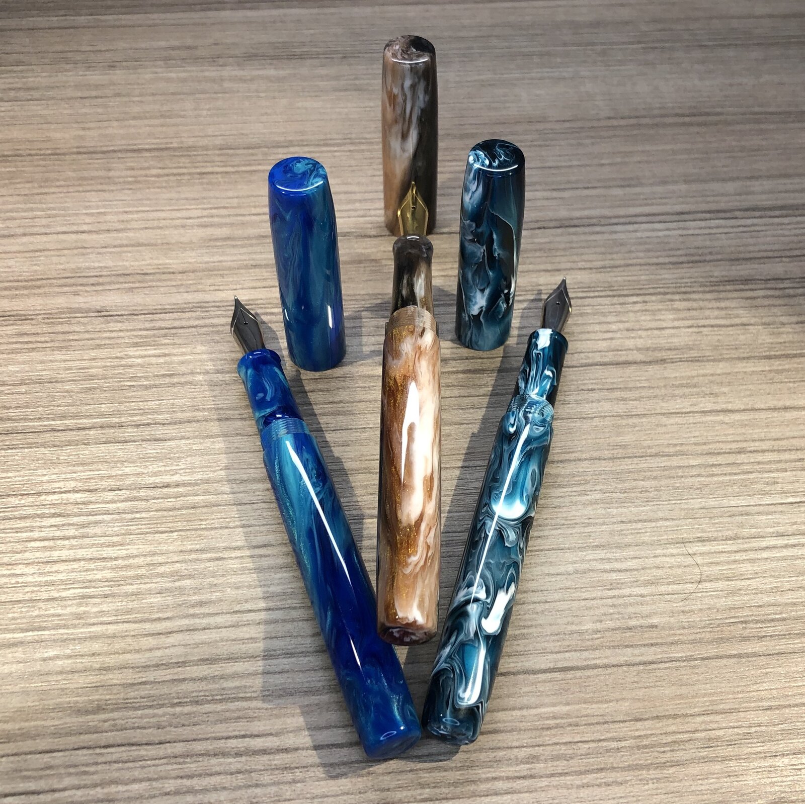

Got these three done in a day. Sunday Funday!

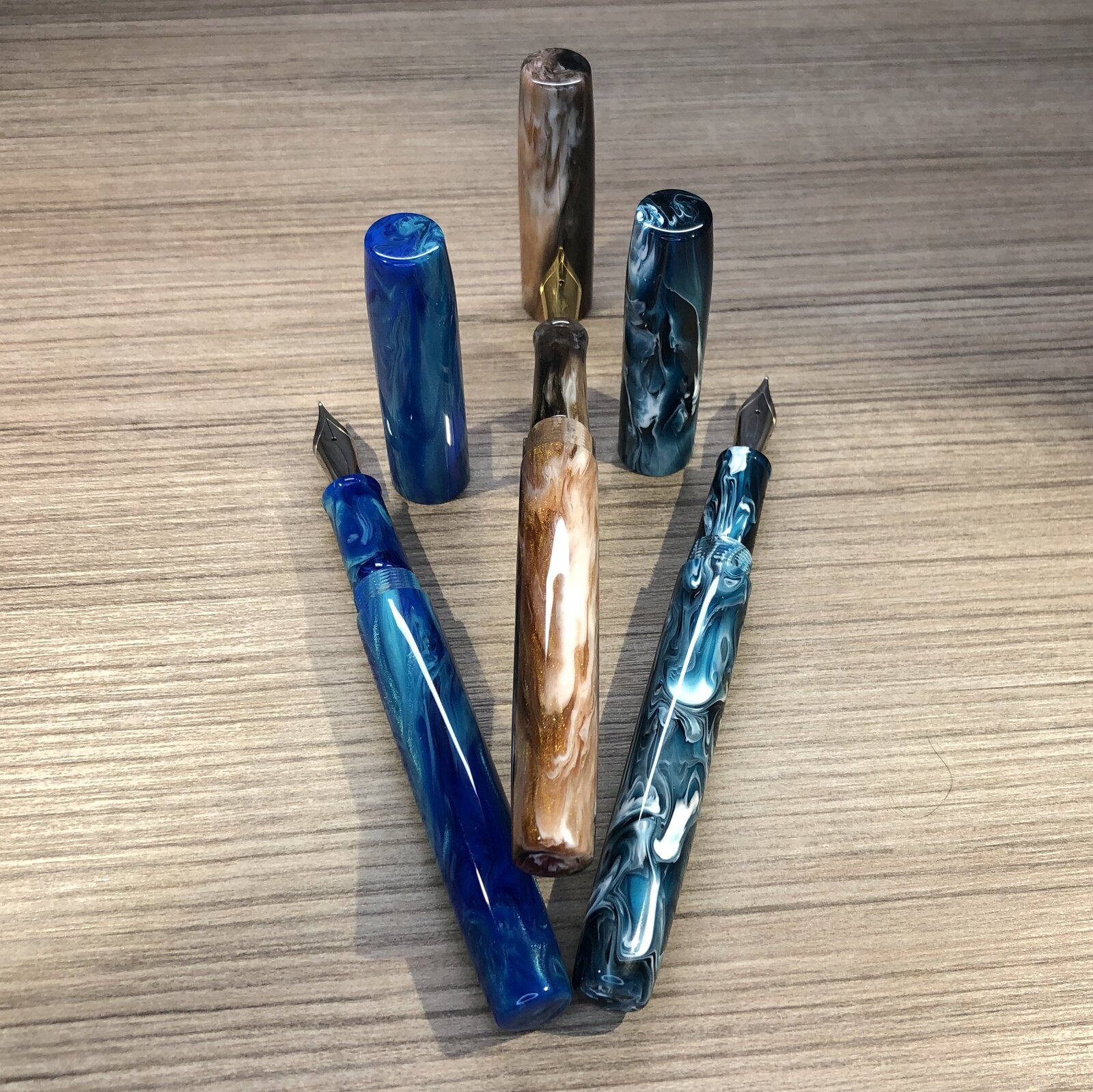

A well finished pen that takes numerous hours to finish can get $500 - $2000 or more.
Can you show us an example of what a $500 or better yet $2k pen looks like and is made of? I am genuinely curious, not asking in jest. Where do you sell such an instrument?
I don't sell them, but I watch those here who do.
Where: The Ginza (Tokyo), Rome, London, New York, Singapore etc.
Two guys that do and whose work are seen below and there are a few others here that do (or others who started here and moved on to full time pen creations that now do).
Probably 98% of the time, such high end pens are fountain pens.
For me - $500 pen - when I lived in Japan - 12 years ago.
I looke through the two links you posted...WOW, that's some nice work. But finding a buyer at that level would be really tough!
These are usually consigned to very high end retail stores and some of them with special clientele. Finding buyers are not that difficult with that quality in those locations.
