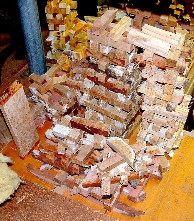

I cut down to virtual size then put it in my roof space with a house fan running 24/7. Use a test group and weigh every week,no change ready to go,no warping.
