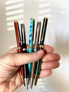

It all started back in April with a little handful of Slim Lines. I've worked really hard to get better, most of my issues involved getting a good fit, but things are improving and now I'm hooked. I work at the lathe almost daily because my goal is to begin learning kitless soon and I can't wait.

Nice pens. But may I make a suggestion before you go off into the kitless world, try doing some real upgrade kit pens. Take a look through the show off your pens forum and see some of those that are better quality kits than slimlines. I say this because I feel yes kitless is an avenue but it can be a boring looking pen. Some of the blinged out kit pens matched with some real nice blanks can be real head turners. It will also hone your turning skills more and also finishing skills. Kitless will require new tools and skills and alot of that can be learning to polish both inside and outside blank material depending how deep you want to get into that line. Just a suggestion. Good luck.

That is actually my plan, I'm working towards some kit fountains, eventually some apollos while I also acquire some tools along the way. Collet chuck, tap and die etc. This will be an evolution, but kitless are my end goal. 😀
