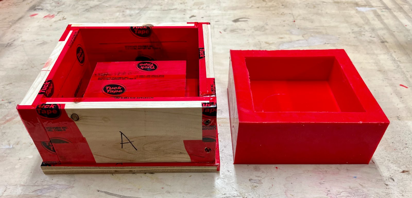

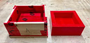

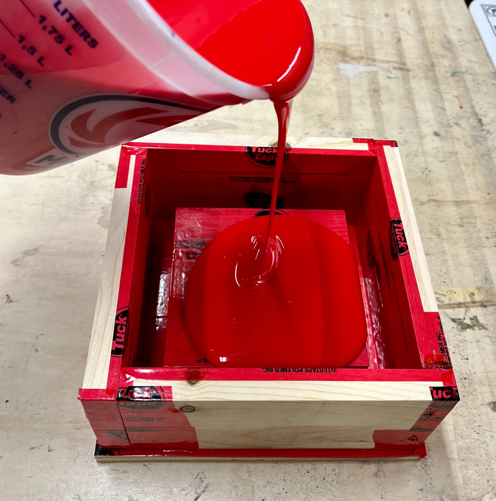

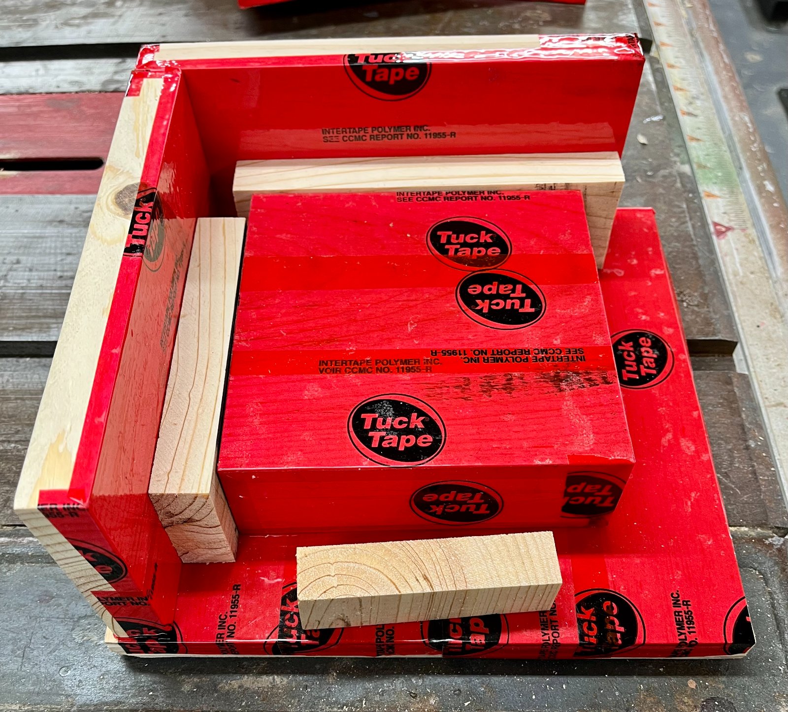

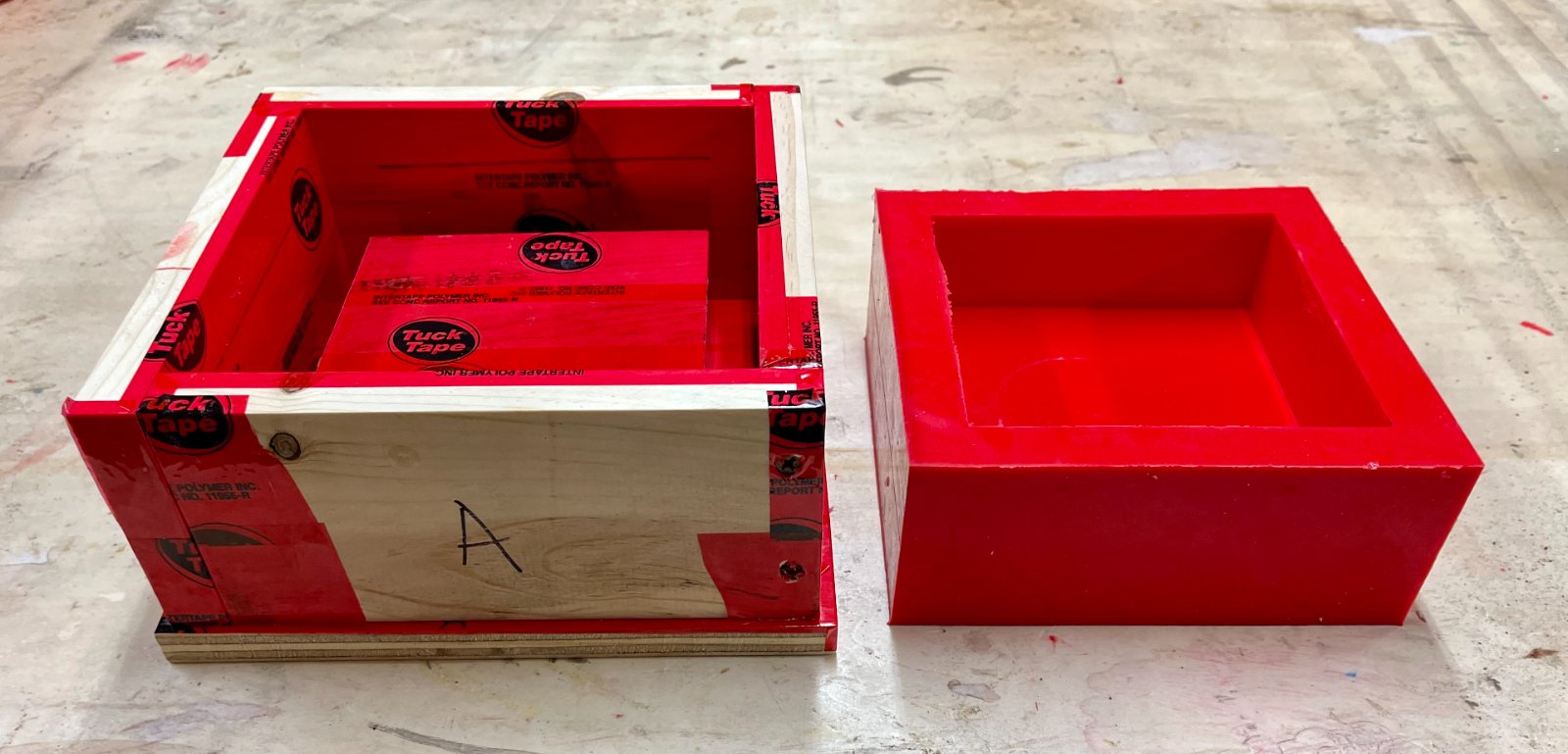

here's an image of a block mold i made. The "mother mold" is wood covered with "Tuck Tape" and the untaped pieces in the first image are just spaces to ensure my wall thickness and were removed before pouring the the silicone. This was made with Alumilite Red Mold Maker because its a larger shallow mold.
