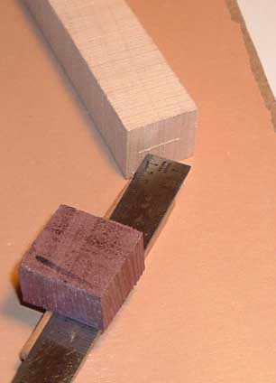

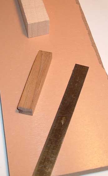

Basically I use a small scrap piece of wood and a 2 dollar pocket rule.

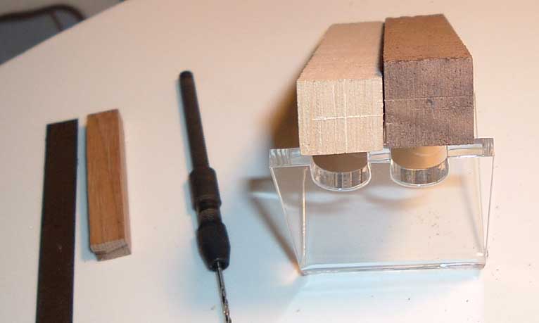

The 2nd picture shows a blank that is not square and not all corners are at 90 degrees. This is where many of the tools don't work well.
The wood piece is .35" thick and .46 thick. I didn't make it that way it was just a scrap that happens to work for me. Other thicknesses will work depending on the size of the stock. What I am going to do here is scribe a line as close to the midpoint as I can from flat side to the opposite flat side. On this first one the .350" happens to be exactly half the width so two opposing scribe lines are the same line. The other opposing sides are not because the stock is thicker in that direction. After all 4 sides are scribed it shows a very small rectangle at the center of the stock, or in this case a sortof 'H' configuration. (Ignore that piece of purpleheart as it is jut there to hold down the ruler for the picture)

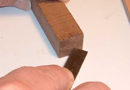

Another picture shows me scribing a piece of walnut.
I then use a 1/16" drill bit in a pin vise to start a hole at the center of the scribed rectangle. Admittedly, there is some room for error with this method but it is quick and easy and as close or closer than anything else I have tried. I have not tried it on a Celtic knot blank yet but I'm sure it will work as well to find the center.
