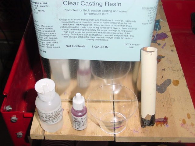

OK... I have no experience here, just noodling this thing thru a bit (what's that smell?)...
As far as a mould goes, how about making moulds from heavy aluminum foil? You could make square corners, thick enough for one or two blanks "deep" as you need... less waste? The catch is how much swirling you need to do when the goo is hardening, and how robust the container has to be when swirling... ???

Mike, the smell is fairly intense, enough to wear a resporator if you want. Some it does not bother, I read here if you fart allot you won't even notice the smell. [:D]
I did the foil molds, spend the 2-5 dollars for any type of poly mold, it is worth it.
The foil sticks to the PR, and it leaks, and it moves around when you stir. To me it was a pain. There is no really good reason to have to engineer something that you can buy for 2.00 Just my opinion.

I do have one other question. I saw that you check your pour every five minutes until its right. Is it right when it holds the swirl you put in or is there another way to tell if the pour is ready to be swirled and also is this when you put in the pearl essence? Thanks in advance.

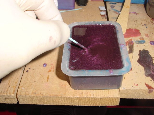

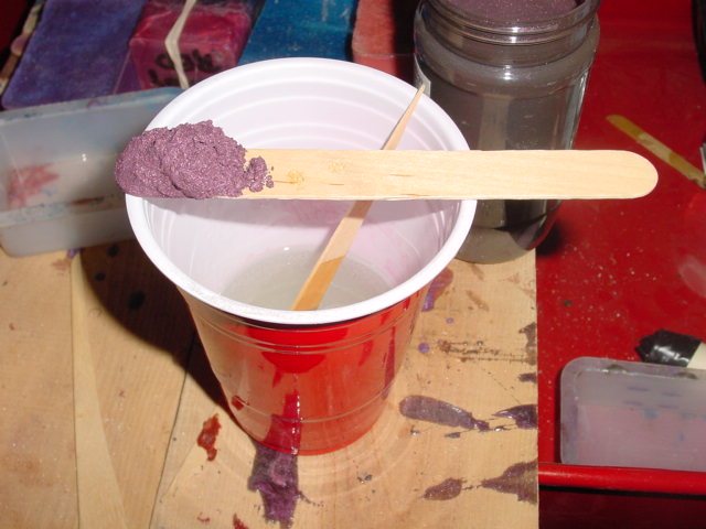

Mike, there are a bunch of different techniques you can use, depending on what you want the outcome to be. You will be able so see & feel right before it gells, that's when I give it the final stir and hope the swirls hold. Also, when the gelling starts, there is not much time before it really starts to set up. I do this on most of them even when I am not adding the pearl drops. If I mix the white pearl powder in my cup then a little die, you will get nice patterns as well. I can bable on about it, but you have to do your first one to see what I mean. Hope this helps

Yes it does..I hope to get my stuff in tomorrow. BTW is anyone around Tallahassee, Florida doing any casting? I guess you put those final pearl drops(if using on that casting) right at the end when you do your final stir. And do you also put white pearl powder in your inital mix and use pearl drops at the end or just one or the other?

The pearl drops did not give as much highlight as I had hoped for, still looked good , but not the effect I wanted. You will have a better result using the white pearl powder with a color die and leave it at that. But you can try anything, that's what's fun about it.

Ok, good. I was worrying about just starting and having to wonder when to do the swirl and the drops at just the right time. Now I will just worry about the swirl. One last question about that...Is the right time to make a swirl when its pretty hard to run the stir stick through it or will it still be fairly plyable? Sorry to go on and on about this, just getting excited about doing something new.
Mike
PenWorks
Aug 18, 2004
5,186
Scottsdale, AZ
I swril right before it gets real tacky. Sometimes they fade away, but you really don't know what you have till you turn it. A prayer to the casting gods don't hurt either.[:p]
