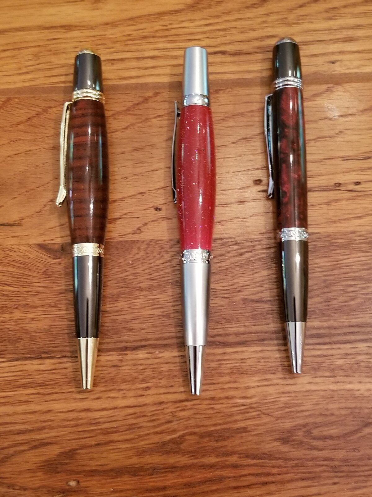

These are my first three kits of this type. The first was the crosscut cocobolo which is a stunning piece of timber. But she's a tad on the hefty side in my opinion. That sparkly girl was number two in a piece of Inlace Acrylester, still a little thick (By the way this one got a CA finish on top of the acrylic because those sparkles didn't look right without it.). The last one was a piece of Rhino blank that went on the meth diet because of some chipping. I got rid of all the chips but she's pretty skinny. I'd say almost dead straight.
What does right look like? My guess is somewhere between two and three.

I prefer the third one. I typically like a fairly straight profile, or a slight taper on the ends. Also, the thicker they are, the tighter the clip gets, which can really wear on shirt pockets if you are a pocket carrier.
Guy, like the other's have posted, it's a matter of preference. What size doe the turner prefer to make, for me, it's the one on the right. But, it's good to have a variety of sizes, not all hands are the same size. Plus, people with arthritis, sometimes require a larger size pen, because of issues with their hands.

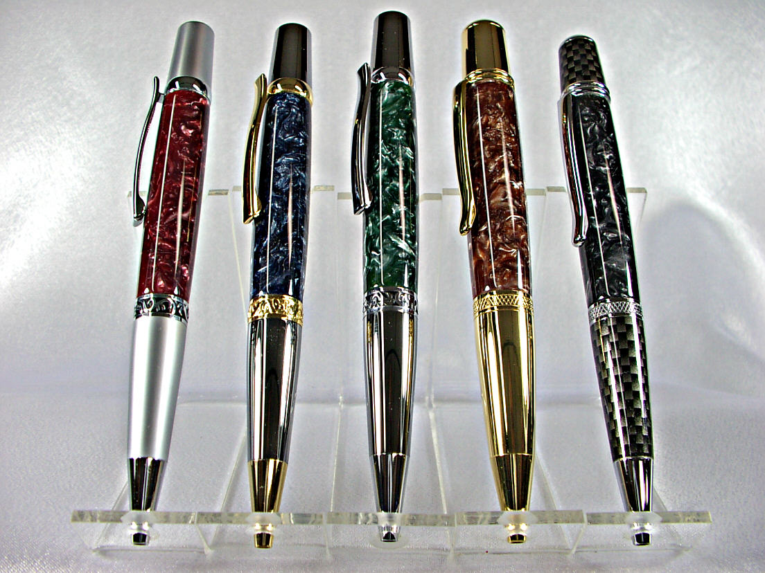

To me I am a bushing to bushing type guy when it comes to most pens. May have to add a slight bulge in the middle if you are casting things. But to me the Sierra speaks for itself because of the line it presents and can not figure out why people need to bulge those out I have heard the arthritis thing so much and just do not buy it. To when you see people make pens with huge bulges is because they are newbies. I say this 1000 times, take a look at big name pen companies and show me one pen where the pen looks pregnant. We need to try to emulate the pros that have been doing this many years before this site was even a twinkle. Now back to the sierra. Take a look at the lower section on the pen and look at the natural curve down to the nib. What I try to do is follow that natural curve all the way up to the cap portion and it is a natural flow throughout the pen. A slight bow as you may. I do not think a straight barrel end to end on a Sierra is a good look either. The Vista kit which is slightly larger gives even a greater bow here are a couple examples of what I am talking about that I recently finished. They are different kits but same Sierra design. Now this is all just my opinion.

I agree with JT, perfect cylinder is a good goal for most pens. I find that if the barrel is slightly overturned in the middle - even a few thousandths - it's really noticeable. But a comparable bulge almost always blends in. I shoot for about 0.010 to 0.015 over the max bushing diameter for the center "bulge". I do more on some styles sometimes - like the cigar or Jr Gent. Sierra's I shoot for pretty straight. It's all a matter of style and preference, but I do think a big bulge tends to be a Hallmark of a newbie - but not always.

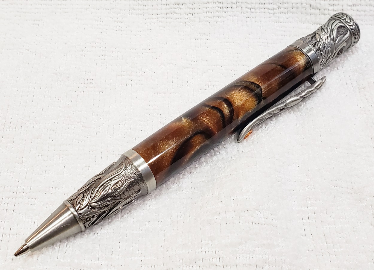

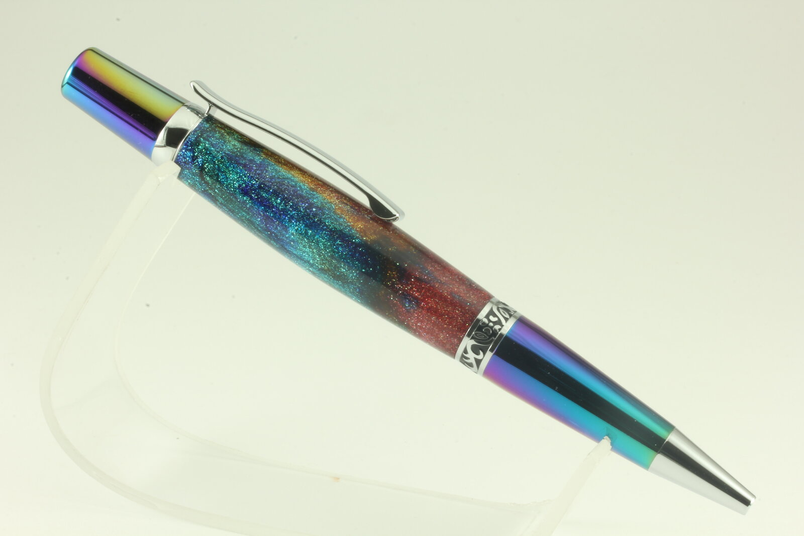

First, very nice pens, John, you make that material really sparkle. I too prefer mostly straight-line pens, perhaps a slight curve, but that's just personal taste. And, Guy, nice job on all of those sierras; I'd pick 3 as my favorite, although I like that cocobolo.
If you look at SCRIBO pens or a Danitrio Mikado, I think they look bulgy --- perhaps not pregnant --- and I'd consider the makers to be pros. Just offering a possible counter example.
