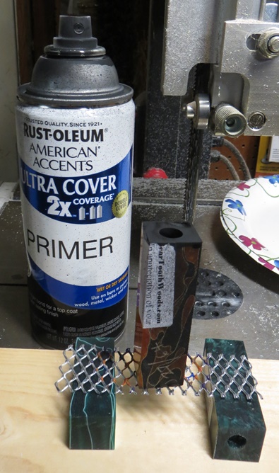

I haven't used Gatsbys but I have happily made dozens of Sierras with AA blanks with good results.
Be sure to paint inside the hole you drill in the blank because the acrylic gets thin near the ends especially (depending on what shape you turn it).
Nothing spoils a pen for me more than seeing brass through the acrylic.
You can paint the tube also, but the key thing is to paint the acrylic surface inside the hole. Drilling with a 27/64" bit should leave plenty of room for paint inside the hole. Be sure to let the paint dry well (2 days) before gluing the tube in.

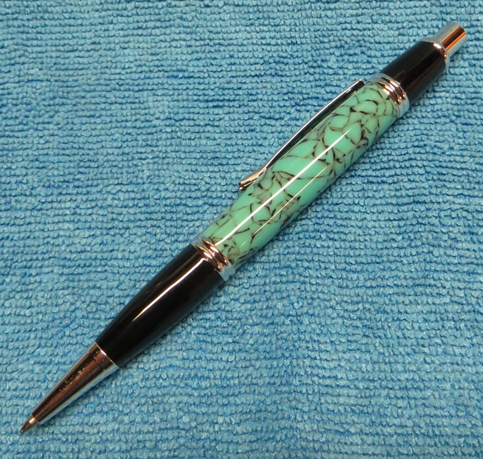

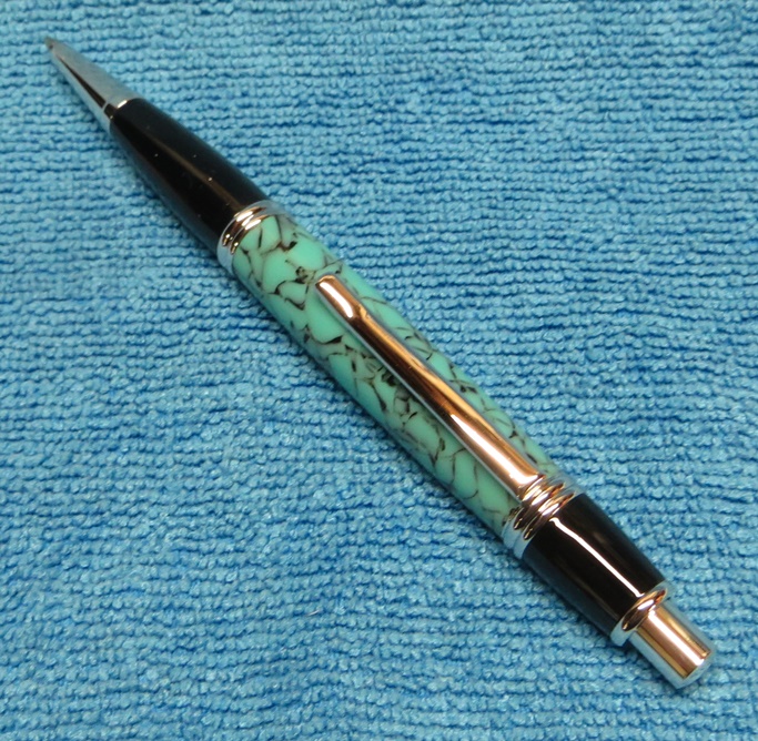

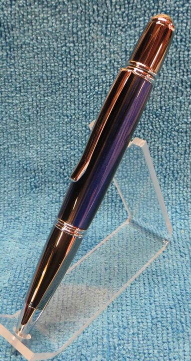

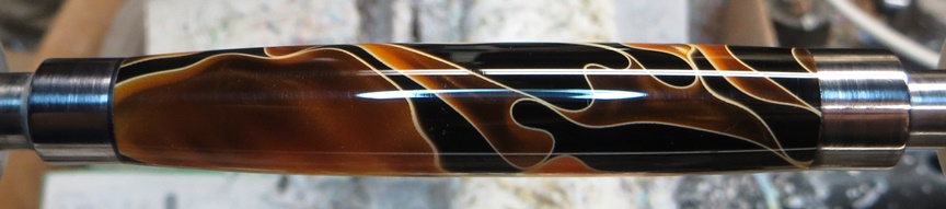

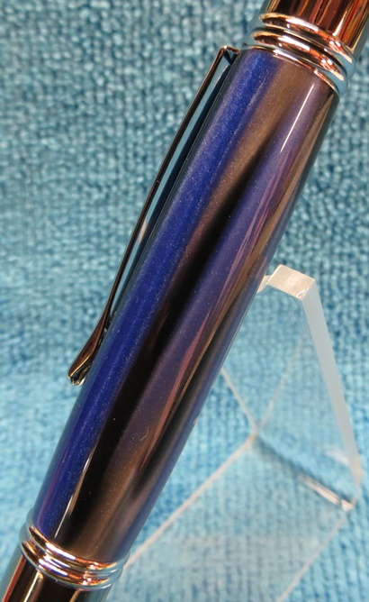

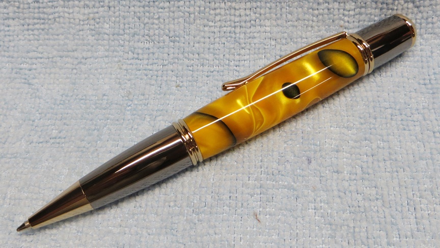

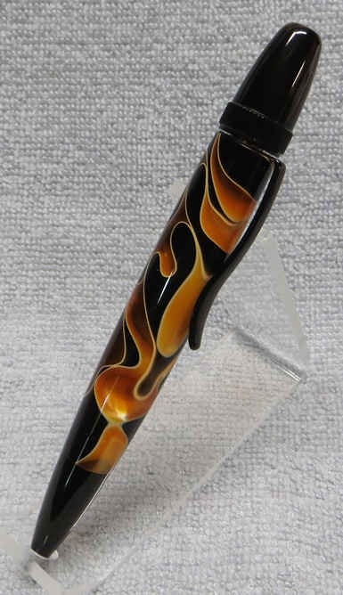

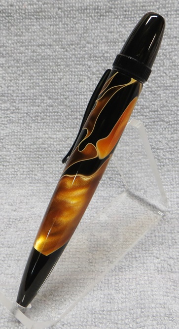

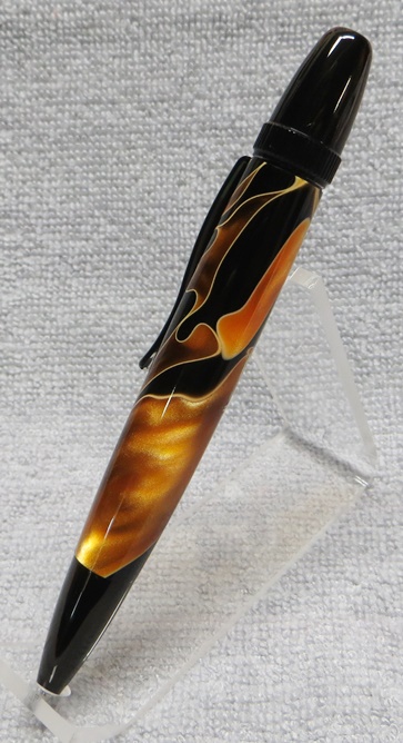

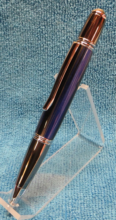

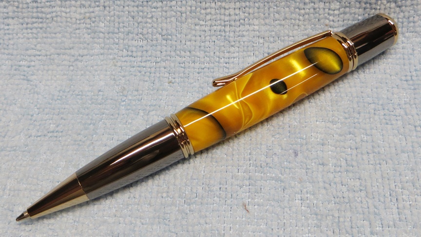

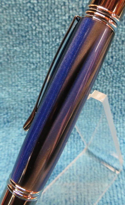

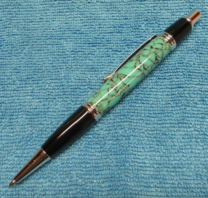

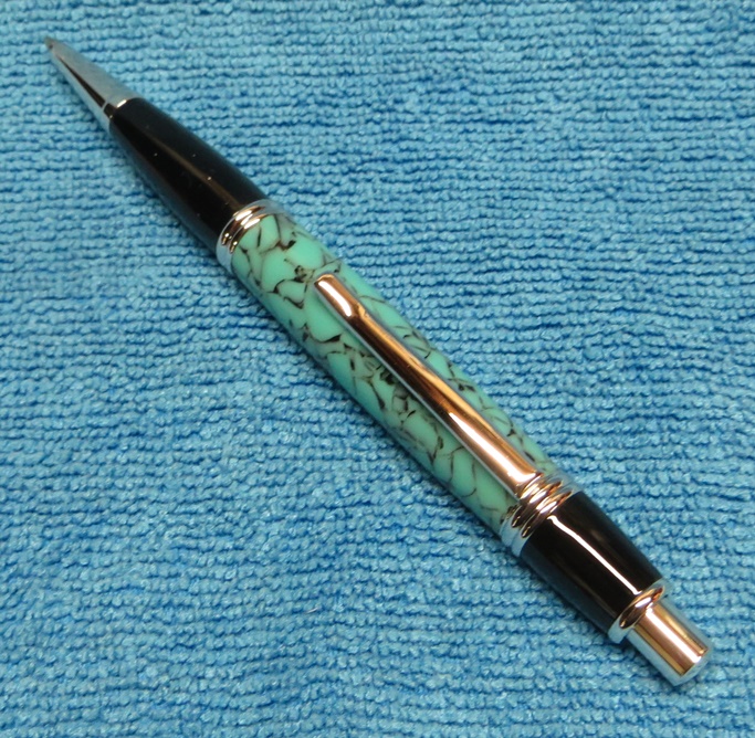

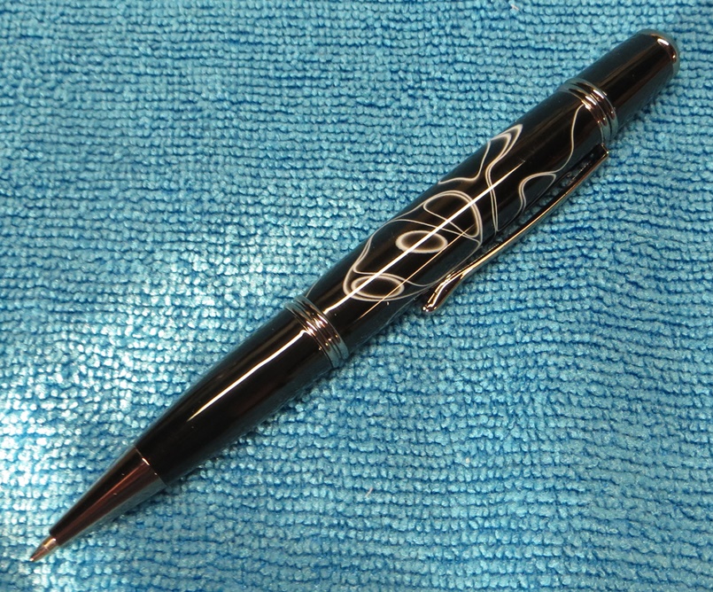

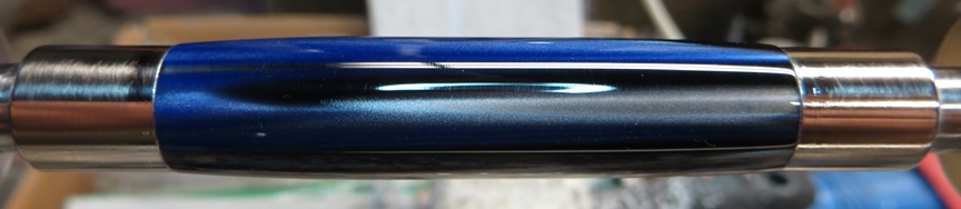

I really like both the Gatsby and Gatsby Grande pens. I prefer them over the Sierra pens. The second two photos are Gatsby Grandes.

Thanks for all the info guys. I think I will go for it. Those pens are slick looking Jim.
The 1st one with copper & purple (at least it looks that way on my monitor) is pretty nice & unique.

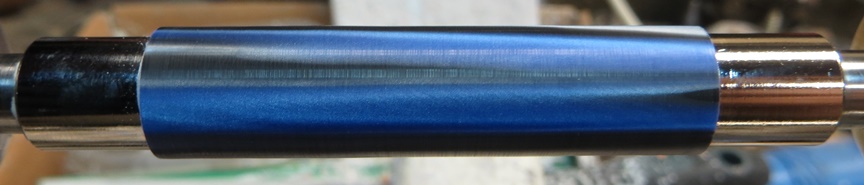

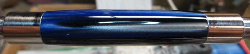

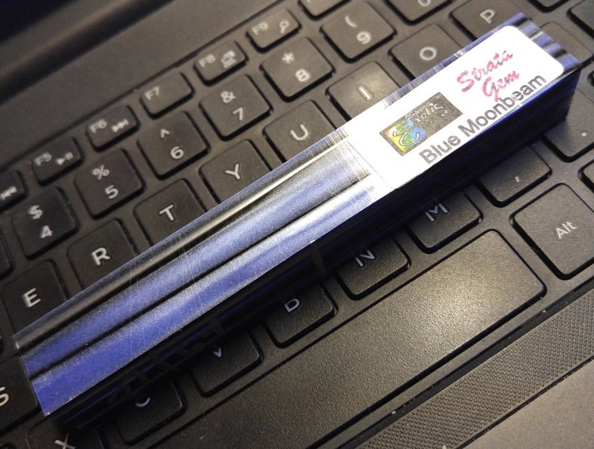

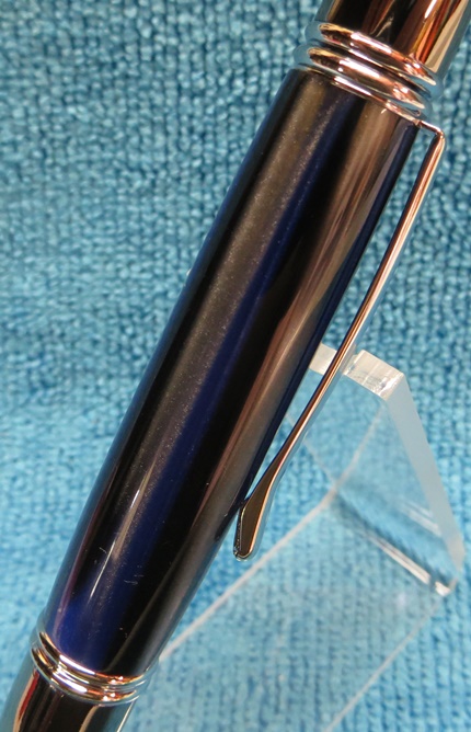

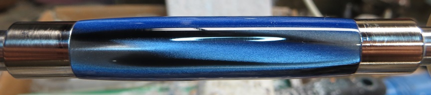

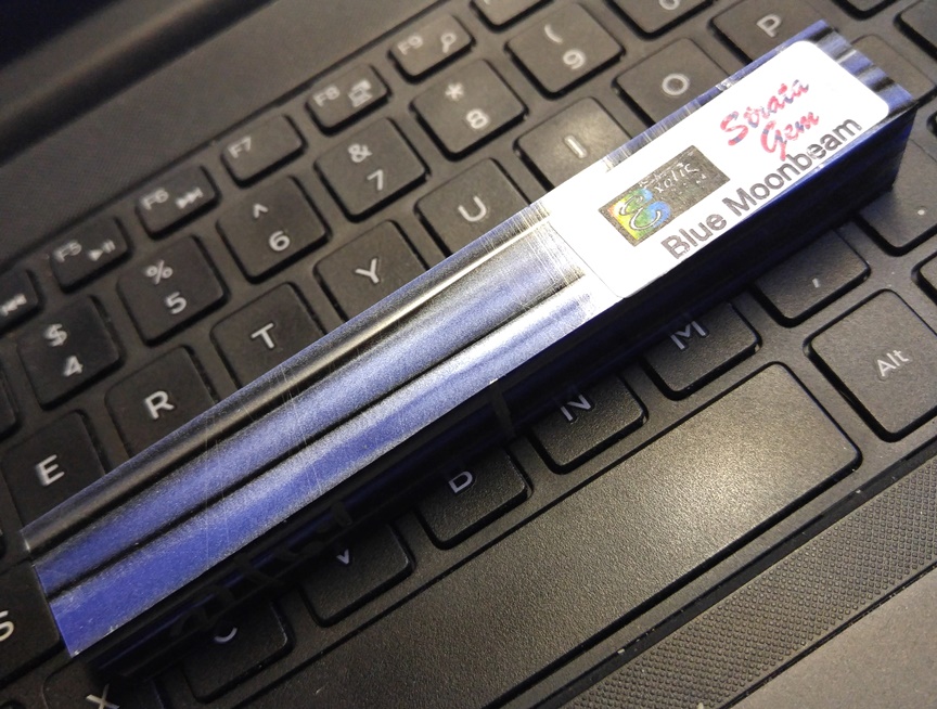

The first one is actually a Strata Gem from Exotic Blanks called Blue Moonbeam. It's more of a blue and silver. Very attractive blank.

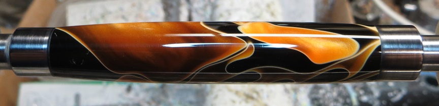

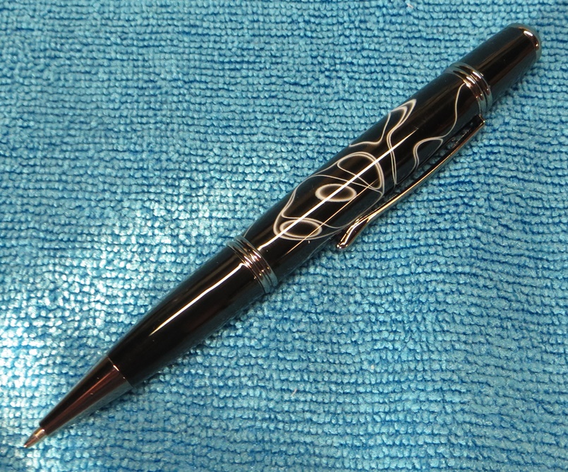

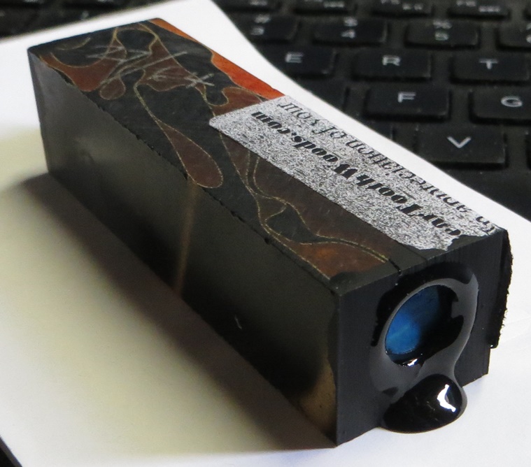

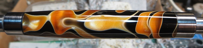

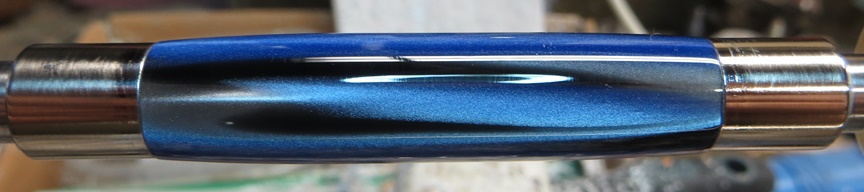

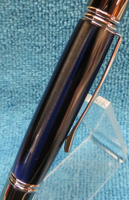

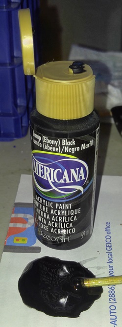

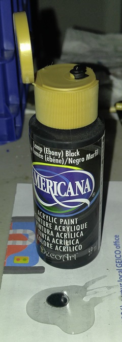

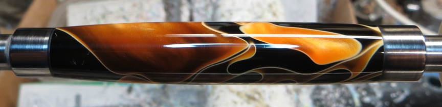

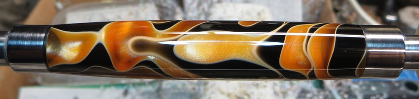

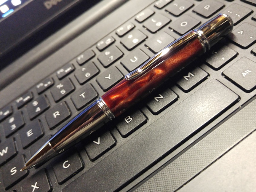

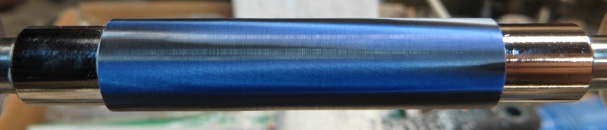

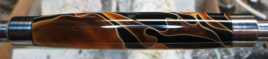

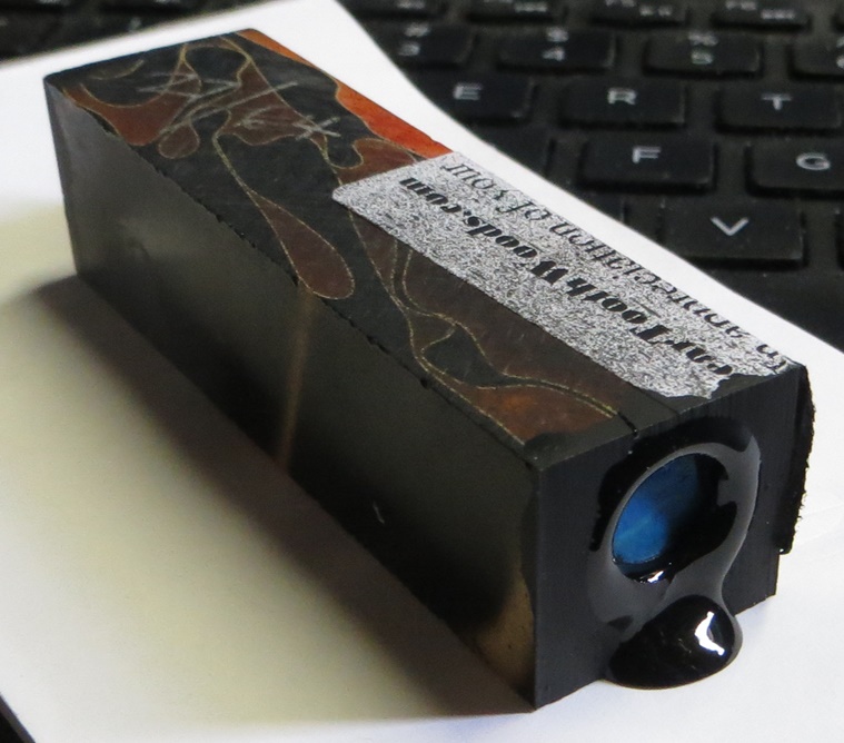

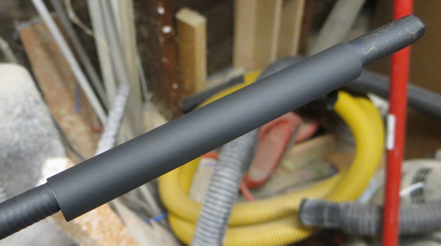

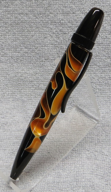

I used to use acrylic paint for the inside of the blanks (reverse painting) and coloring the epoxy. But lately I've been using spray paint for reverse painting the blanks and painting the tubes. I've been getting better results that way, and the spray enamel seems to dry faster. I still use acrylic paint to color the epoxy. I'm convinced, that in this case, the black paint made the blank look "smoky" in places.

Hey Jim, does mixing acrylic paint with epoxy affect it in any way?
I didn't know you could mix acrylic with epoxy.
My thoughts were to get some auto touch up paint & spray the tubes, then glues them in with epoxy after they dried completely.
Does that sound like something that would work?
That reminds me, I need to buy some fresh epoxy. The stuff I have here is over 9 years old. It still works, but it takes forever to cure entirely.
Like weeks, instead of just a day or so.
qquake
Feb 8, 2004
5,023
Northern California
I haven't noticed any difference in the colored epoxy. It sets just fine with the acrylic paint in it. But instead of getting acrylic paint to color the epoxy, I don't see why you can't spray a little of the spray paint into a container and use that. It only takes a drop.
