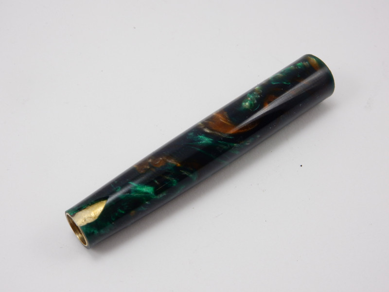

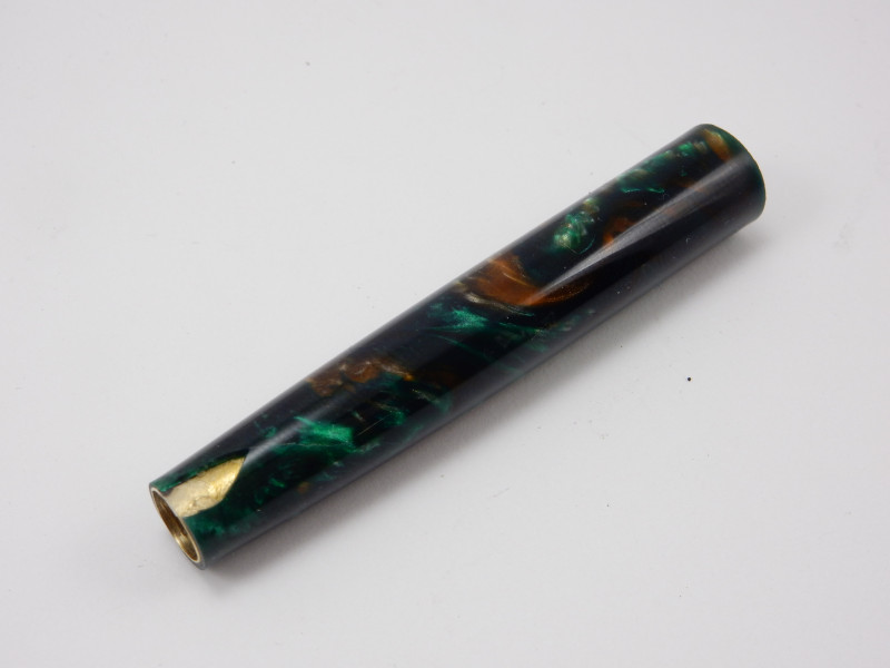

Okay, so it wasn't a good day here. I've never successfully done a Wobali Pen. I thought I'd try again today. I did a Graduate kit. I turned it okay. But when I pressed the transmission in, it went in way too far. So I knocked out the tip, and knocked out the transmission. Then I reassembled it using Locktite Blue. That was a mistake. The transmission no longer turned. So I knocked out the tip again, and when I knocked out the transmission, my pen shattered. Yea, so I'm not happy.
How does one fix a loose transmission?
Mike...

Have you heard of the "oops ring"?
Trim the broken section to the tube with a parting tool. Just skim off the glue.
Leave a straight edge. Drill a scrap piece longer than the now bare tube. Glue it on place with a tight joint. Re-turn the barrel and add a new transmission.
Good skill builder

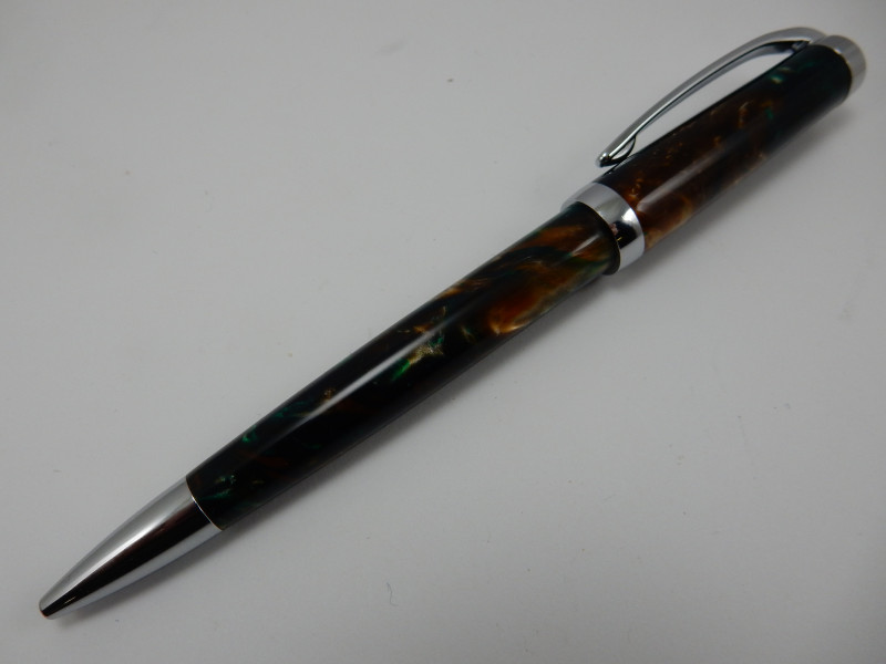

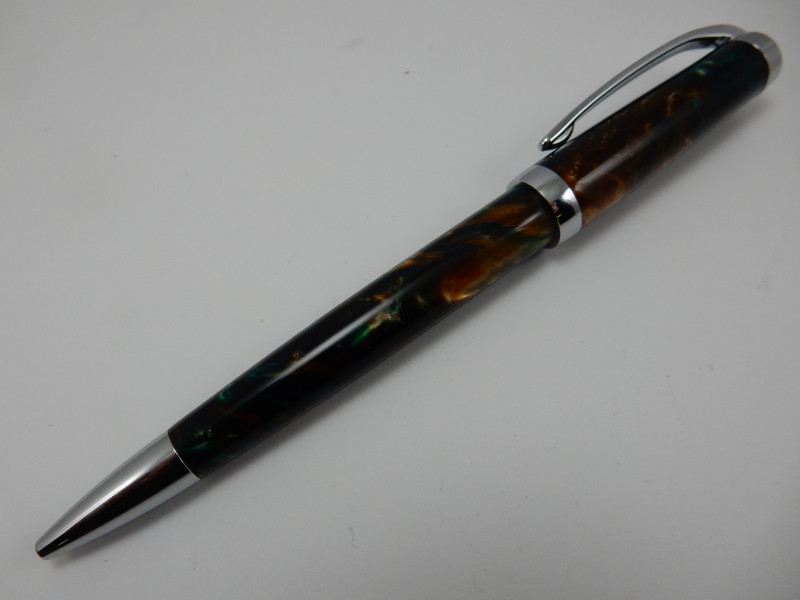

Well it's taken a while to get back to this pen, but today was the day.
I turned a new lower blank, and used a new transmission. This time it went together without any wobbles!
I like it. I actually like the Wobali blank, it's a very unusual combination of colors and depth!
Mike...
