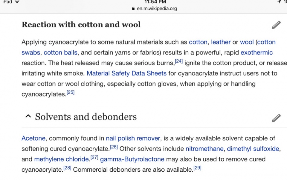

After a piece of cotton cloth with CA started burning, I don`t use CA in my shop.
Interesting, we used to use CA where I work and the Safety people banned it....
Never had it start anything burning in my shop.

CA as a fire hassard
I`m not a fan of shiny wood anyway, so for me no loss.
I haven't seen the towels catch fire , seen it smoke on white paper towels.
when I use CA I would throw the pieces of blue paper towels in a tin coffee can just because I was afraid of a fire .

You know those blue gloves you use in the shop?
Well, I had them catch on fire using CA once.
I dropped some CA on the glove & got it off just in time.
It burst in flames, I knocked it on the floor, and stomped it out before it burned down my house.
Be careful using those blue gloves.

Not sure what gloves you have and why, but i use blue nitrile gloves all the time and what I do is actually cut the fingers off and just use the fingers. I get 10 fingers (duh) Never had any problems and never got hot. I do use blue shop towels to apply the CA but it always gets on the gloves.

Once, while putting a CA finish on a small turned box, I had some kind of exothermic reaction that started to melt the gloves while I was still wearing them ... I assumed that it was actually a reaction directly between the CA and the nitrile glove itself, but there are no issues whatsoever when I used the fingers of the gloves directly to apply CA to a very small piece of wood.
I'm pretty sure it was actually a combination of things that caused that reaction ... the items on the table at the time of the glove meltdown were: Minwax Stain'n'Seal, Harbor Freight Super Glue, tap water (from the wet sanding), 90% strength Isopropyl Alcohol, and the nitrile gloves themselves.
I hope you take this the correct way it's meant, and I have no dog in this fight, so to speak.
But, I have noticed no matter what opinion is expressed in this forum, but you seem to always have the opposite view, even if it contradicts your previous statements.
Mind if I ask you a serious question?
Are you contradictory based on your personal opinions, or on proven facts?
Not sure where that is contridictory. But I made a statement about my gloves I use.Stated what I use to apply CA. There are different types of blue gloves on the market and maybe you are using ones that may do as you mentioned. Maybe the CA you used is different than mine and causes this reaction. Maybe there was a combination of things that caused your mishap.
Whenever I post answers it is usually with my own personal opinion and it is because I have been woodworking for well over 35 years so I have seen a thing or two. I do like to follow up when a topic is going.
If I do come across as irritating and hard to read ( I am sorry for that) then the only thing and civil thing to do is block me so you can not see my posts. It is an easy thing to do. Other than that I am who I am and too old to change. Do not know what else to tell you. Happy turning:smile:

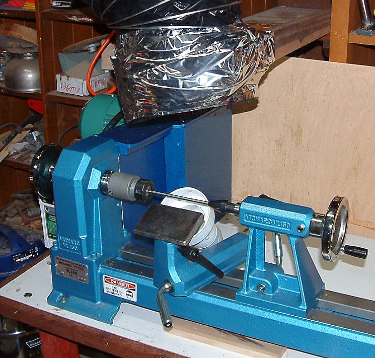

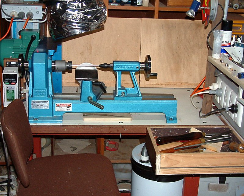

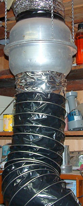

A couple of pics , I picked up on CA very early on fitted an inline fan to a roof ventilator very low power but very efficient fan to atmosphere. This directly over the lathe. I turn it off when I do the turning of plastic all the ribbons float out as well. The fans are flame proof.
These pics incidental when changing from a Vicmarc VL100 to my then new Vicmarc 150 from TIMBERBITS during the installation. I use an industrial Vac under the Mandrel as well. CA problems all gone outside thanks to the fans.
Peter.
Peter.
