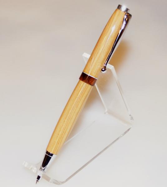

How about this one?

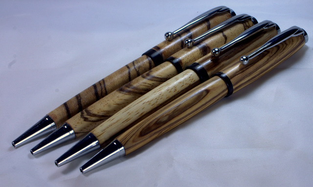

I don't know if this exemplifies anything or not but here you go. I really like the slimline and make several pen styles using modifications. The kit is very versatile and fun to use. I never use the center band and rarely make one as it was designed.

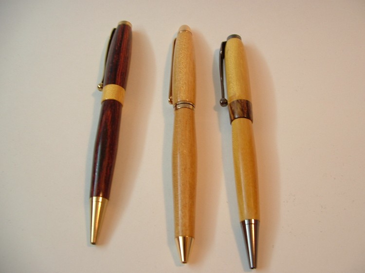

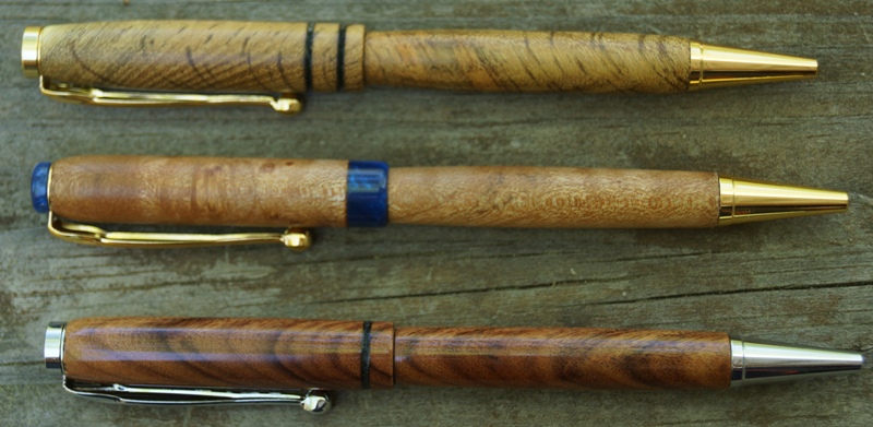

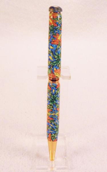

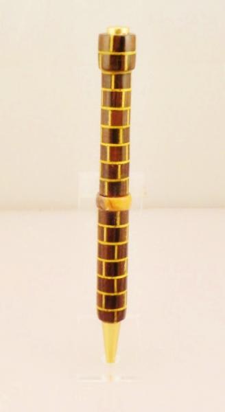

How about these. Sorry first photo is not a Slimline. Could not delete it. Third photo does have center band, but is done in copper and polymer clay. Jim S

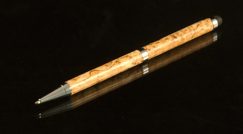

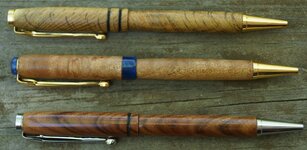

Here are a few more from my current "Pens for the Troops" run (13 so far, on my way to 20). The top is black Locust with 2 burn lines. I did a few this way, but I don't care for it much. The 2nd is olive root with a pr CB & finial. The finials are easy to do if you have a collet chuck. The 3rd has just one burn line, and I like the looks of it compared to the top pen. I don't know what the blank is, but I do like it, and it's very hard. I finished the last one with CA. The top 2 are finished with a product called Pens Plus from Doctor's Woodshop. They are a bit shinier than they appear. I do like the fact that you can still smell the wood after using the finish. At least I could on a cedar pen that I did.

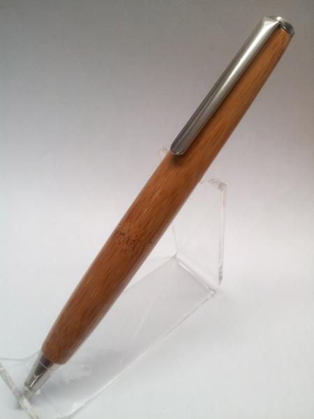

Don's ...Modified Slimline Pens... book has good examples of fun ways to break the monotony. I had the day off, today, and spent it making this one-piece bamboo slimline with satin nickel hardware.
