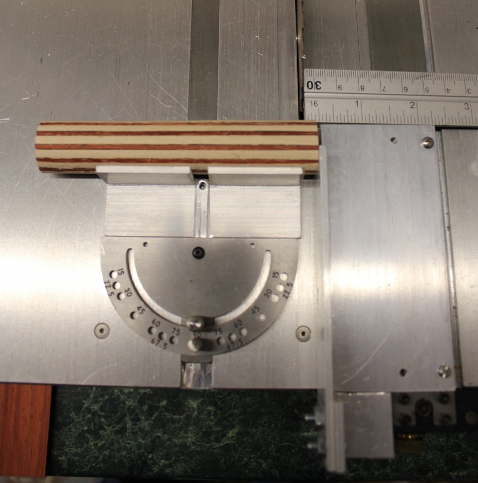

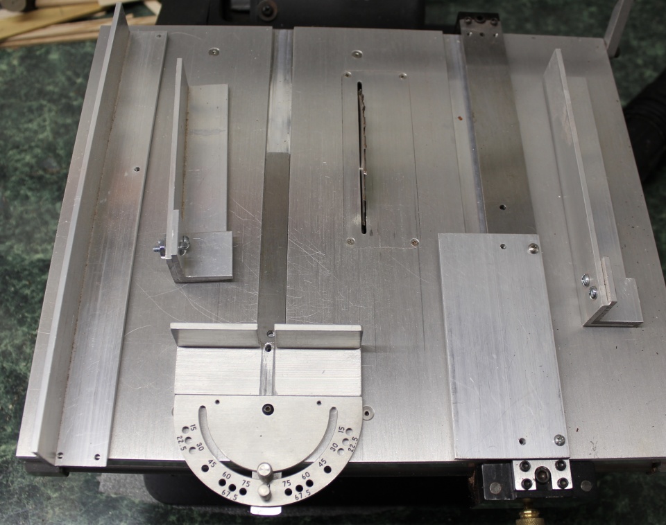

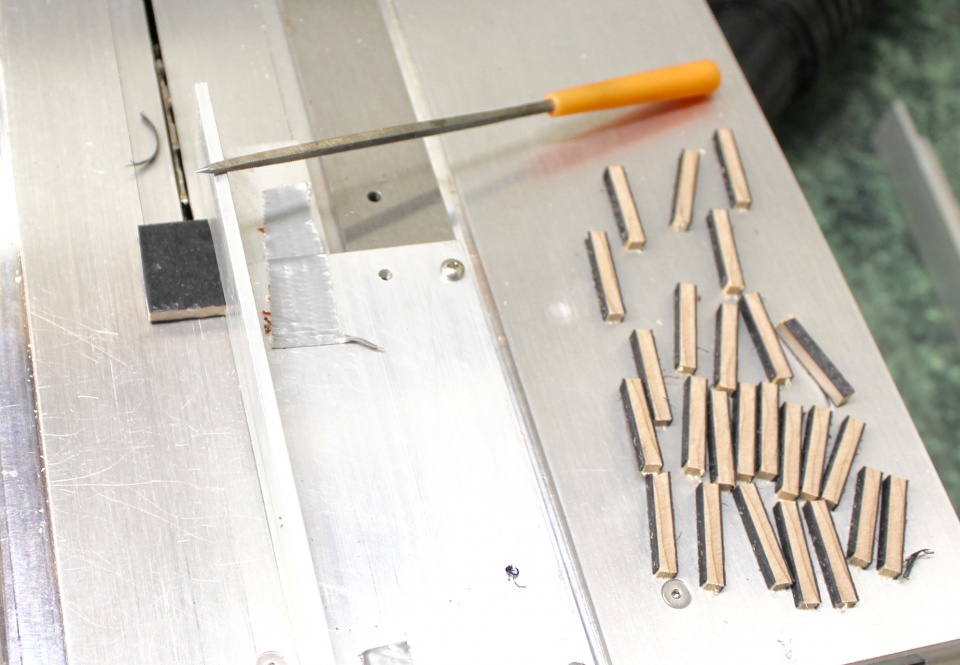

I use a cheap small file that I ground the tip to a pin point, and use it to very slightly push the piece through, but more importantly to pull the piece to the right as soon as it clears the blade.
I have also made a few guides and fence attachments.
I also have a GRRipper for thicker stock.
