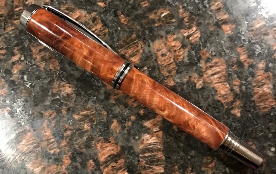

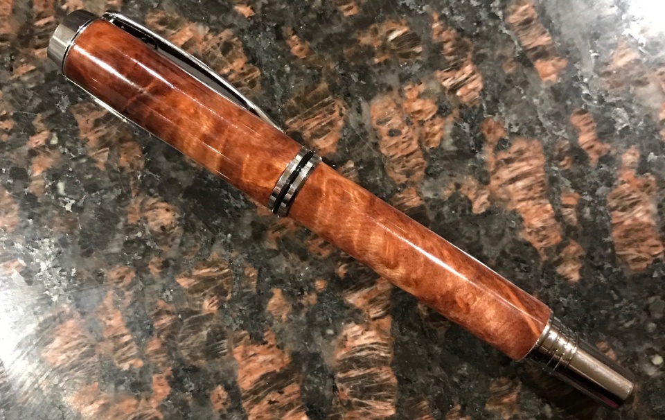

I've turned probably around 30 pens so far to varying degrees of success. I'm starting to get annoyed with the out of roundess I sometimes get. I've tried a couple of pens with TBC using just the regular bushing that came with the pen kit between a dead and live center and it seemed to work ok. I think whatever wobble was left there was maybe due to the blank not being perfectly square. I'm still working on the best way to do that. Here are a couple that I'm particularly proud of:
You might want to get one of these "Turn Between Centers Mandrel" from Penn State. I got one and it has made a world of difference in how easy it is to turn single tube pens. You just slip your bushings on the shafts and lock you blank in between. It is fast and so far they have all came out round and true. It comes in a #2MT or a #1MT to fit which ever kind of lathe you have.
I saw these and they look tempting but honestly what's the difference between that and just sliding the regular bushings against my dead and live centers? What does this really buy me?
