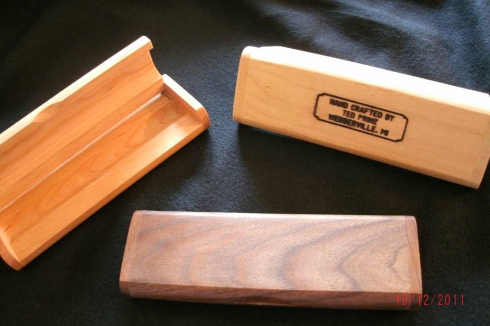

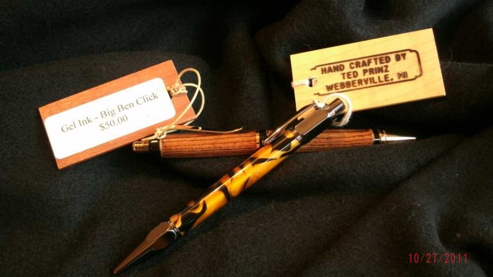

LOML got me a branding iron a while back and I liked it and use it as my logo. It (the design) goes on everything (business cards, invoices, etc). I use the iron to mark price tags (pic attached), pen boxes I make (pic attached) and other work (bowls, furniture, cabinetry, etc - sorry, no pics)
Hope this helps.

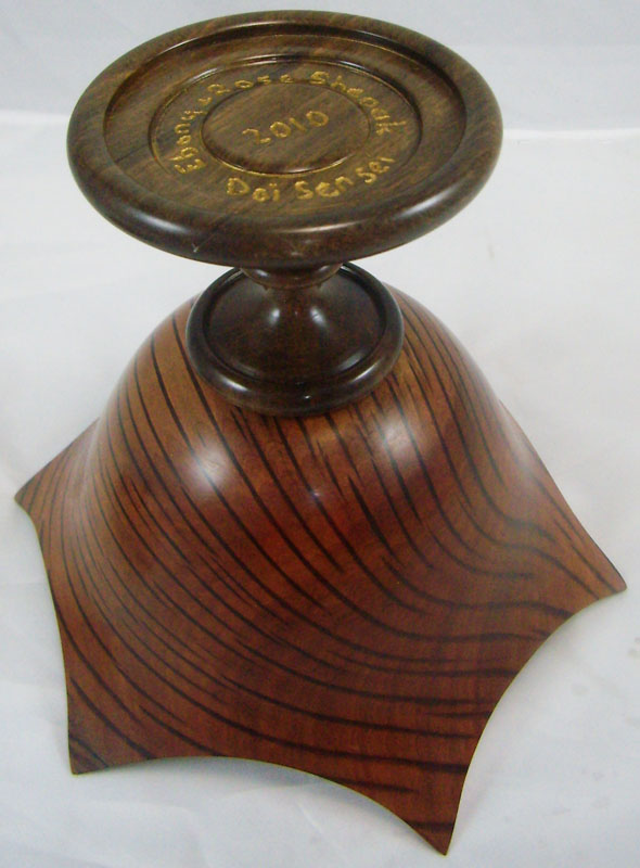

I sign all of my work with a dremel engraver but I dont back fill with gold or silver, the advantage of the dremel is you can sign your work anywhere and any size, for example on some of the round bottom egg shaped boxes I make I hide the signature inside the lid tenon.

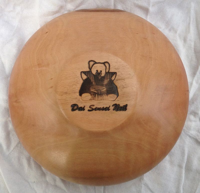

I don't sign pens/small stuff, they are just too small in my opinion and signing ruins them. Pepper grinders and medium items I either burn in my name/timber or engrave and fill with gold/silver somewhere that is hidden and does not detract from work. Bowls and larger items I use my brand (soldering iron type)

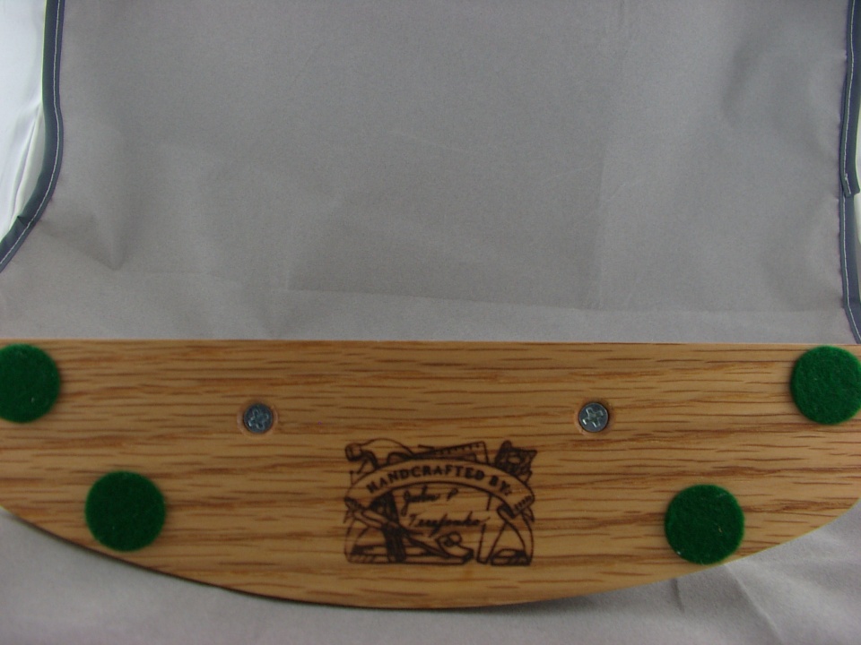

I know this is an older post resurrected but will add my insight too. Being the question originally was about boxes and things of this nature I have a wood iron that I use on my projects that has my signature.
As far as pens go yes people add some sort of metal tag that has their logo or symbol. Some people write on the underside of a clip. I think it is tacky to write on the pen barrel itself because that does not add value but takes away value unless you are some famous person or company. But those companies have a distinguished mark or symbol used on all their pens. We have a couple people here that have gone on to become stars in the field and have incorporated the tag thing. Dale Penkala of Opus Mechan fame comes to mind.
