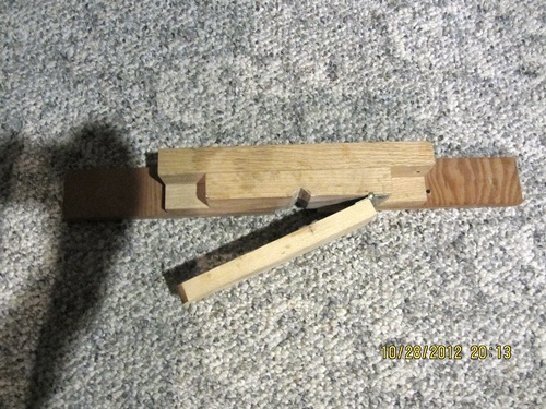

Here is an oldie but goodie for the drill press. I drilled many many blanks with it before I bought a chuck for the lathe. It is made of scrap wood, only cost is a hinge, I had a used one so it cost me nothing. I patterned it after one that was in the video on pen make the guy that use to have Arizona Silhouettes. Simple works great. I made the bottom on it so I could clamp it to the drill press table.
